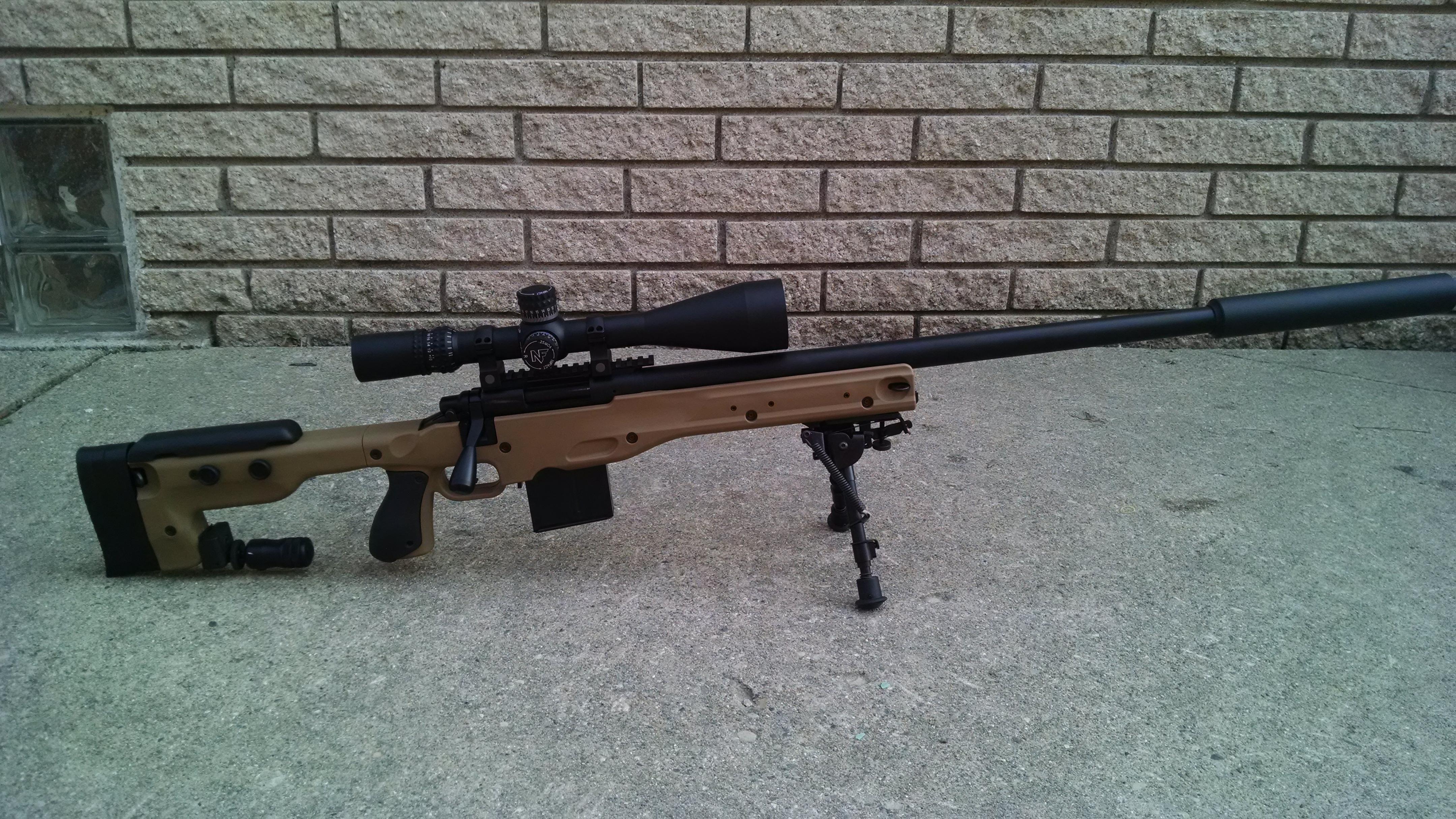

Anyone run a can on a AO threaded rifle? I have a rifle being built and threaded right now. I have a thunderbeast on order. It will be a direct thread can. Anyone have any issues? The paperwork says it's threaded for a brake/suppressor so I'm sure it's fine. Just wanting some feedback from owners.
I have an AO rifle and a 30P-1. Zero issues. You'll be fine man and in the event there was an issue you couldn't get better customer service than either of these companies will provide.
no sir no problems at all, threads right on.
