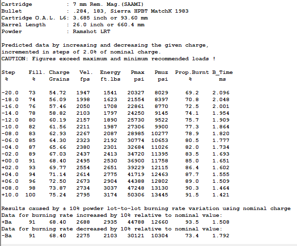

Can someone help with quickload??

    7mm-300 win mag norma case
    183 smk 3.685
    197 smk 3.685

    Same bullets but in 7mm rem mag to get me close.
    I appreciate the help if someone can great if you need more info let me know

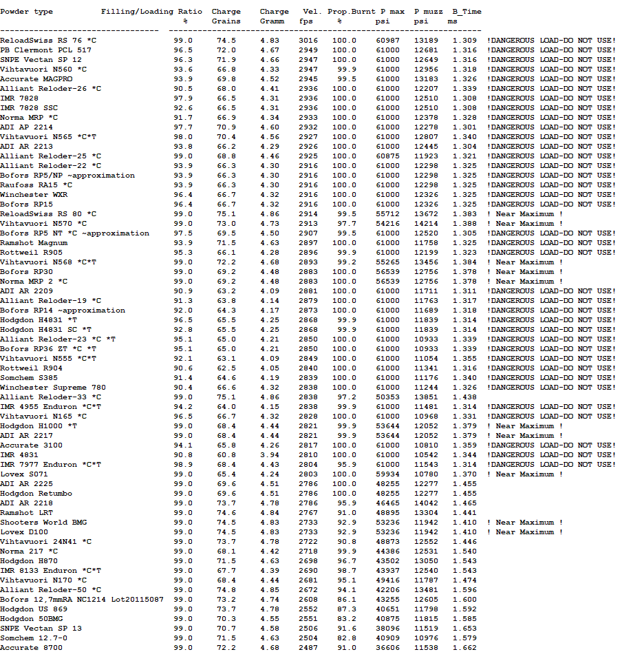

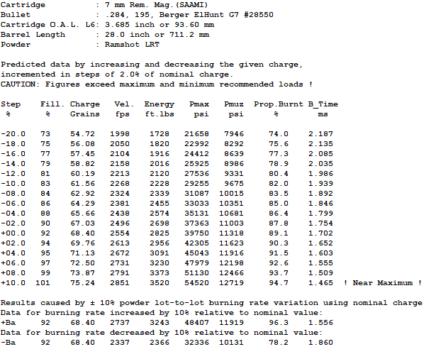

    That wildcat doesn't appear in the latest update to QL, so 7mm Rem Mag it is. I'm just going to guess you're shooting a 26" barrel?
    LRT is too slow in this combo.
    Here are some powder options:
    I have no data on a 197gr SMK, but my guess is it wouldn't change much.
    Just remember that this QL info is guidance, not data. Don't blow yourself up.
    Yes sir. The 7mm-300 win mag holds more powder usually 3 to 4 more grains or so. I can start with the 7 mag data and work up slow
