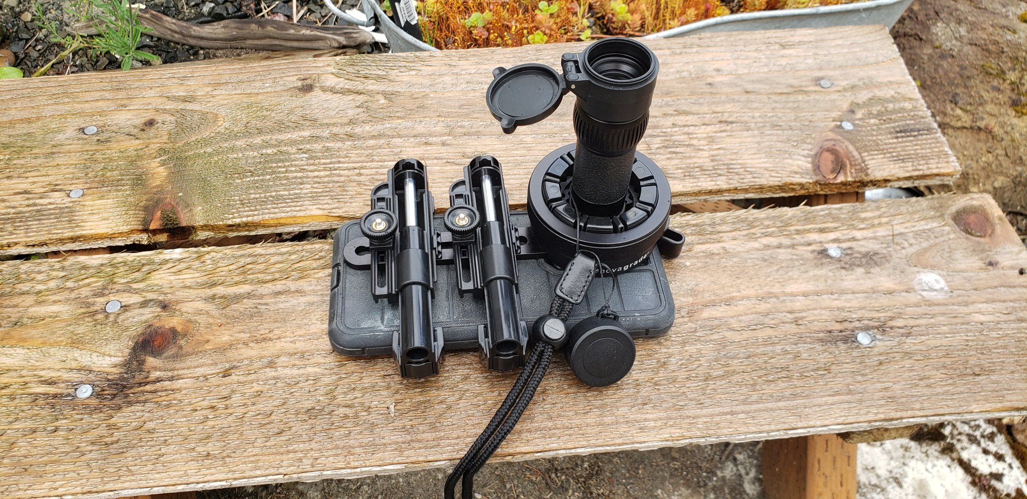

Monovid attached to phone

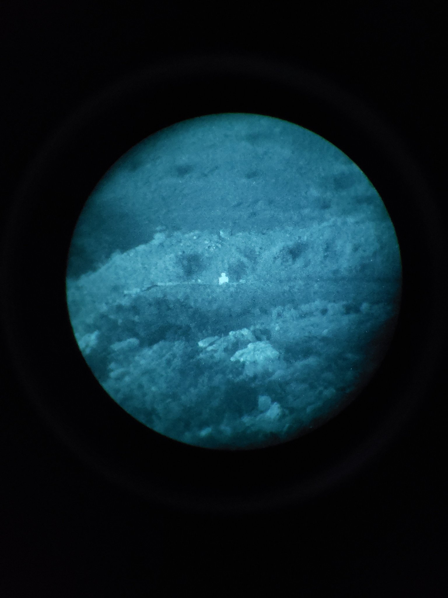

Have been able to see an ipsc at 1100 with no moon but illumination from a Luna with a 14 and a spotter. This is an ipsc at 600 no moon no illuminator 😁 14 behind a spotter on 22x iirm

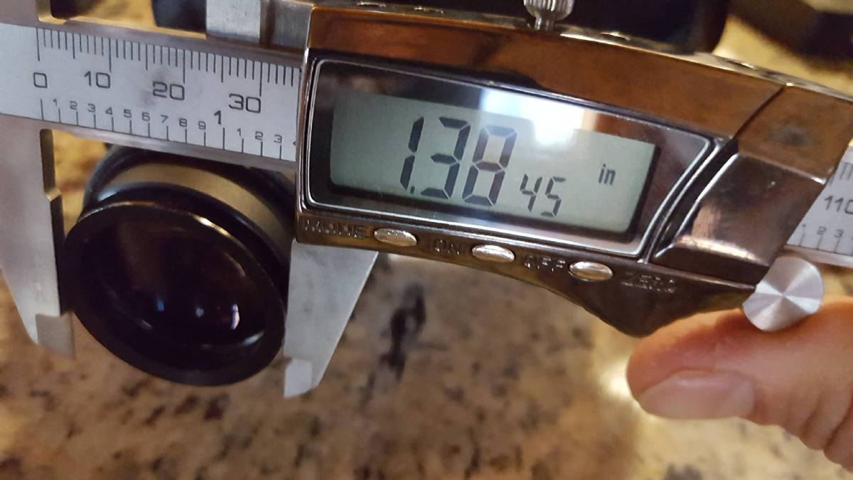

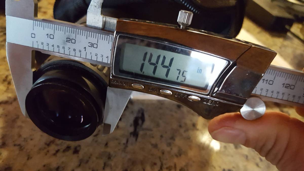

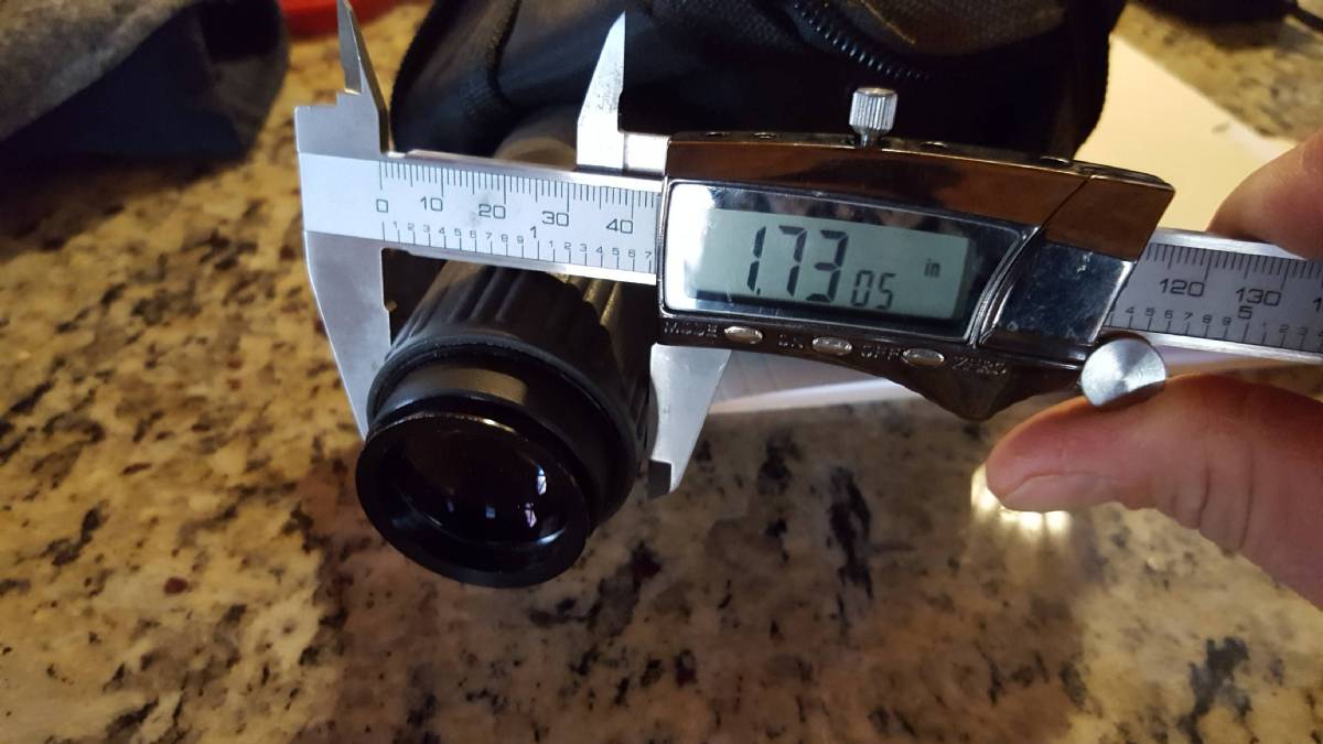

It is a friction fit over the tube. Let me see if i can get some pics with measurements up in the thread over the next day or so.
