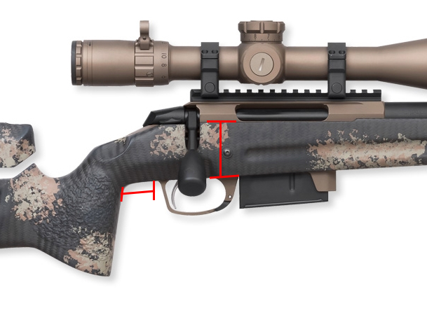

    Im working on making my first stock using the PRS1/2 grip interface as a model. Just need 2 confirmations on dimensions if anyone has one handy, itd be much appreciated.
    • grip to center of rear action screw (aprox 1-1/8?)
    • Behind ejection port top of stock to belly of stock (aprox 1-7/8?)

    I measured my PRS2 - dependent on exact location your 1st measurement at the grip (approximating your location) to center of rear action screw is close - 1.10" to 1.32" so approx. 1 1/8 = 1.25"+/- close - my action is in the stock so a little difficult to measure.
    Your second measurement is dependent upon if the stock is cut for the action. My PRS2 measures 1.97" - 2" before the start of the cut for the action port and 1.80 at the action port cut.
    Hopefully, this was helpful and not confusing...

    Perfect, sounds like my model is well within my margin of error for sand paper and a rasp. Thank you!
