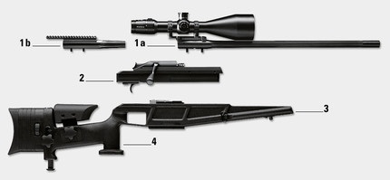

    The 'action' on the R93's can be removed from the parent stock as it's merely an alloy bedding block style affair that houses the trigger group and provides the block style bedding for the barrel.
    There are a number of manufacturers that are making stocks for the R93 and now the R8. I can't remember the name but there was a thread about a Russian stock maker on here who was making cabrin fibre stocks for them, as well as Sig Saur themselves with a number of chassis's available.
    Here's a pic which shows the 'action' of the Blaser.

    Have you ever seen a Blaser action for sale without it being in a complete rifle?
