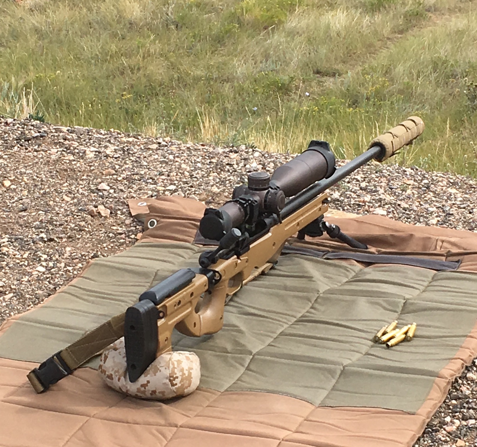

    Hell they had old AW rifles in 338 Lapua that where used over in the sandbox. When they where pulled from service it wasn't because anything was wrong with them. I was told they where going to get cut up mostly due to they didn't have a gov't p/n or something silly like that. Myself and a couple of others who where involved with those guns begged and pleaded to save a few of them and we offered to pay for them but it didn't happen. All went under the chop saw!
