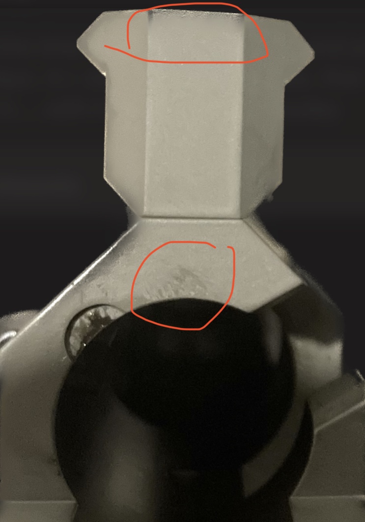

As I mentioned in the A.I. picture thread, I recently purchased an AXMC in 6.5CM.
After getting home and starting to put it together, when levelling the rifle, I noticed that the action/scope rail was canted side to side….to the point of being visible to the eye.
Ended up sending it back, it was away for 5 weeks and had a new rail installed.
Got it back the other day and while it’s not as severe as it was, it’s still canted.
I tend to get really hung up on small details like this, that ultimately don’t really matter. And I also had a less that satisfactory experience with A.I. customer service.
Is this even a problem/something you would worry about?
By my calculations, the rail is out by approx 0.3 - 0.4 degrees, with the mating surfaces of the rail-to-action 0.07mm out of square.
Sometimes I just need people to tell me to stop being an idiot 🤣

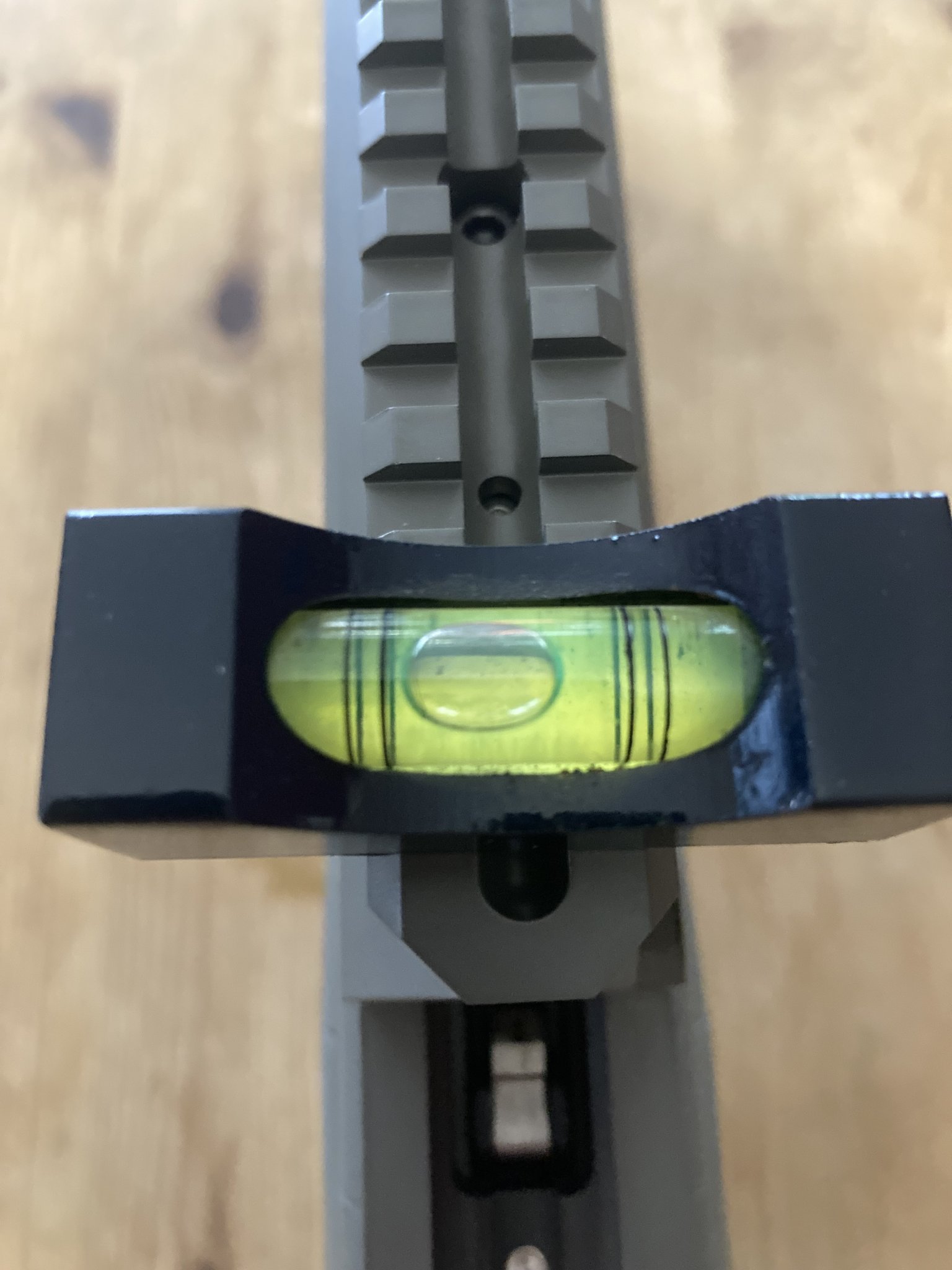

You don’t need any levels. Ever.
Shoulder the gun so that it’s comfortable, align the reticle with gravity and lock it down. To align the reticle with gravity you need to hang a rock from a string.
Throw three or four of those bubble levels on the same plane and they will all read different.
Shoulder the gun so that it’s comfortable, align the reticle with gravity and lock it down. To align the rifle with gravity you need to hang a rock from a string.
You're right, just because it's a level doesn't mean it's level. If your going to use levels you need a master level, that is verified to be level, to rule any other levels that you might use for reference in the process.

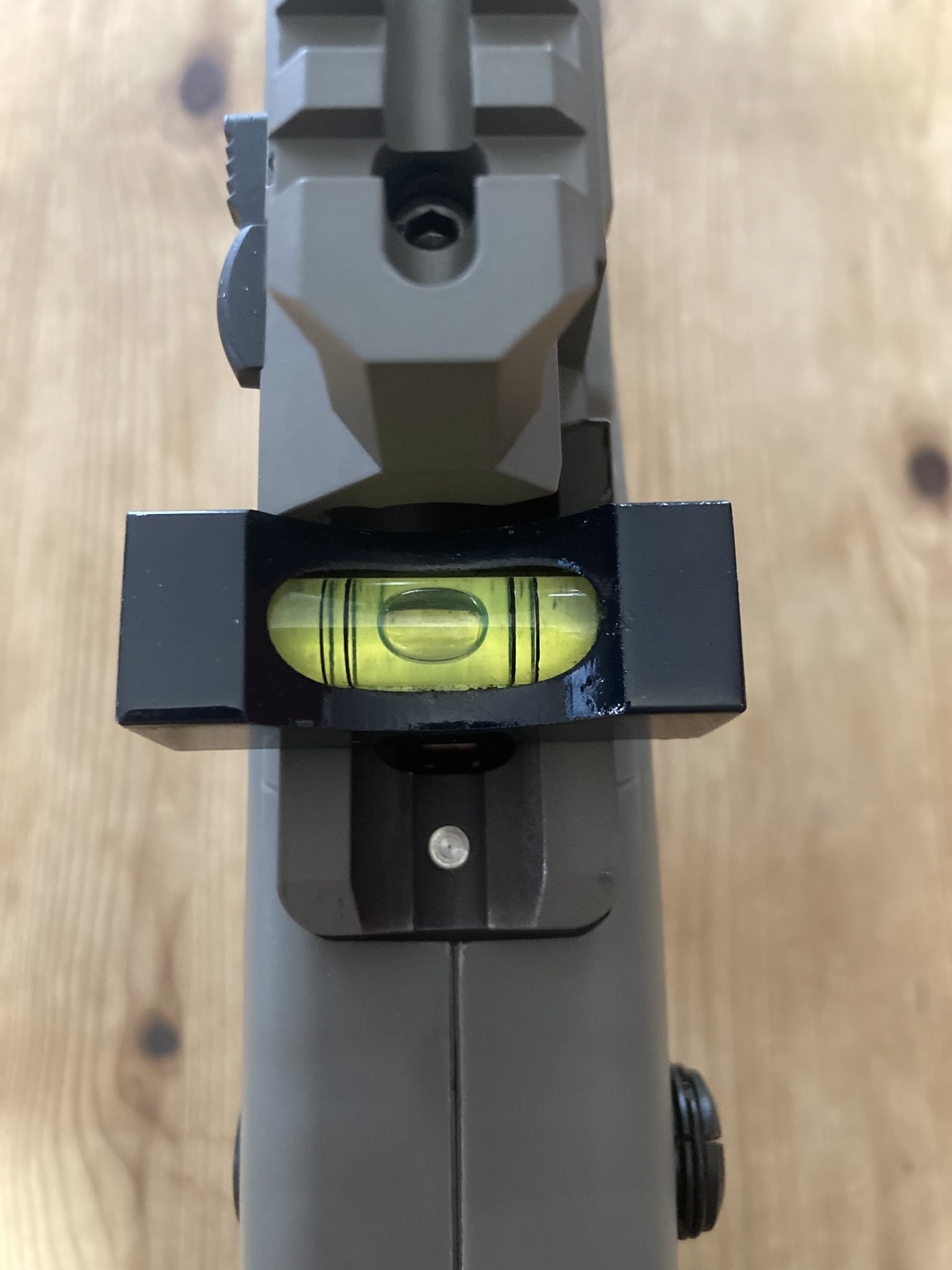

Absolutely agree with the levels not all reading the same comment. I’ve only been using the one (as high a quality as I could find) and mainly using it for comparison reasons (if it’s out, then it’ll be out by the same amount no matter where it’s placed etc) just because of that.

To check your level place it on a fairly level surface and note the position of the bubble in relation to the indicator lines. Now flip/spin the level end for end and see if the bubble is in the same position. If not get a different level.

You could stick that cheap bubble level on each slot/raised rail section of your rail and likely get different results (Ive tried this on countless rifles). The tolerances on bolt-on rails are usually just not that precise.

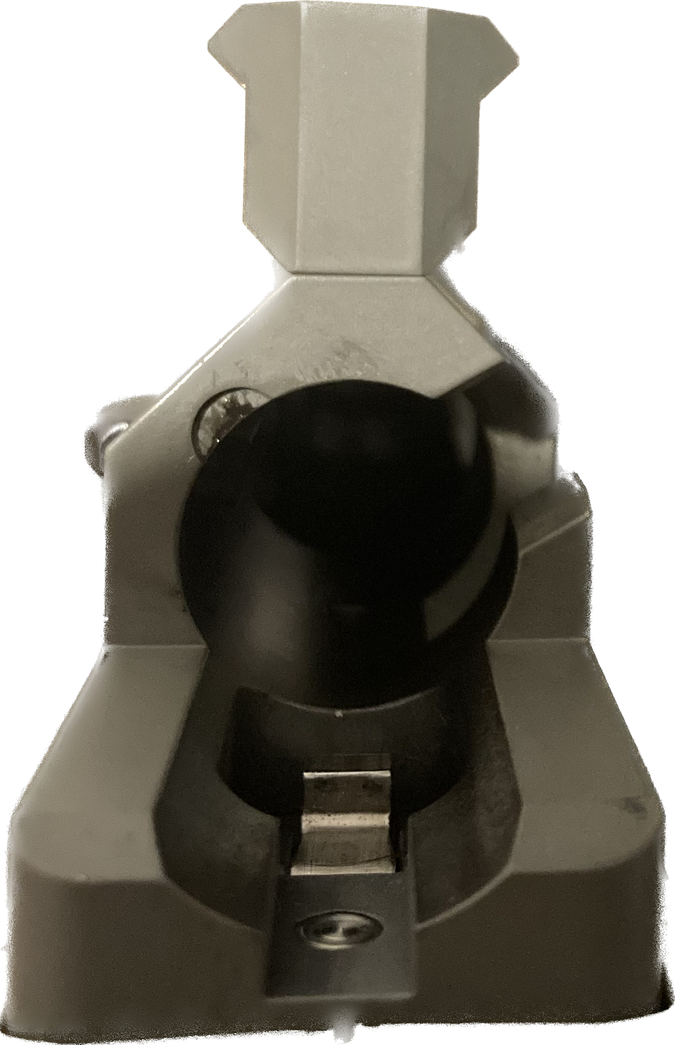

That photo has been doctored/skewed.
The receiver and rail are both coincidentally canted in the same direction..?

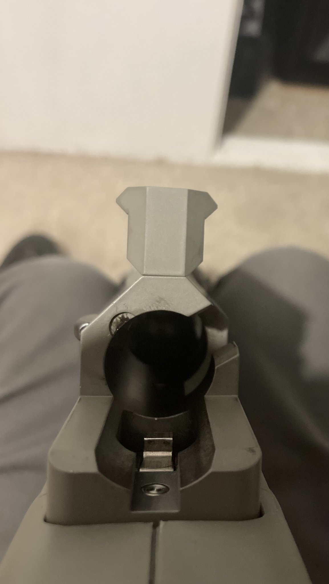

The photo has only had the background removed and skewed so as to line up the edges of the action with the grid lines on my phone (as a means of comparing the rail above).
As to remarks about beating the shit out of it…..nope, as long as it’s been in my hands it’s never been fired and has only had the bolt cycled less than 10 times.

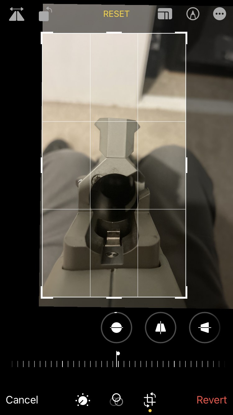

Just for further clarification, here’s the method of photo adjustment I used, on my phone, purely to give align the photo with the pop up grid lines and to give a better reference for myself for the rail.
The ”ball peen hammer“ marks on the receiver face were just oil residue from the factory, I presume.

That circle on left of center at the very bottom of your screenshot, shows the photo has been rotated in the iphone app.
As for the forced perspective, maybe put it on a table and take a picture head on, if you want to be taken seriously instead of straddling it on your crotch.

Again, yes…..the photo has been rotated slightly to align the point at which the horizontal and vertical faces of the receiver meet and put them level to better demonstrate the canted angle of the rail at the top of the picture.
Theres literally no point in me taking the photo you suggest, as that rail was deemed out of spec by A.I. and has been changed……with the new one being the one referred to in the original post.

There may be a real problem here; it appears AI accidentally installed a right leaning canted rail at the factory, which is correct for rifles sold to residents of countries located in the southern hemisphere.
Being the OP lives in the northern hemisphere, his rifle should have shipped with a left leaning canted rail to cancel out the Coriolis effect; same reasoning behind right hand and left hand twist rifling.
Another call to AI clarifying where you live should straighten this out and they should send you the correct left hand canted rail.
A word of advice: a man who owns one level knows what is level, a man who owns 2 or more levels is confused.
On a more serious note, that rail does look like it might have a parallelism issue (or maybe it's uneven cerakote thickness on the top of the receiver or bottom of the rail skewing things a bit) but without being able to measure it I can't confirm if it's real or an artifact of the picture.
If it does have a visible parallelism issue, that would not only irritate me because of how much the rifle cost, but it would mess with my OCD because once I saw it I could never unsee it. In the end it's a minor issue that won't affect function or accuracy-- because as was said earlier all that matters in the end is that the reticle and erector in the scope are held level to gravity during firing, and that's easy to do with a plumb line even if the rail is canted. Shoulder the rifle, rotate the scope in the rings until the reticle is level to the plumb line, snug the rings. When you're done you can lock the rifle down and run the elevation turret up and down and confirm the reticle tracks the plumb line to make sure the reticle is parallel to the erector.
This is also why scope tube mounted levels are better than levels in the rail or scope rings/mount, because the rail might not be parallel to gravity because of tolerance stack up, some people naturally hold the rifle with a bit of cant, etc. You typically can't adjust a rail mounted level, but it's easy to make sure a scope tube mounted level is mounted level to the reticle and gravity with a plumb line before you tighten it down.
OP, is the rail on the receiver noticeably canted with respect to the rail on the handguard, or do you not have a rail installed on the handguard?

More pictures would certainly help, but from what I can tell from that picture the rail does look pretty canted. Perhaps its a weird perspective thing with the camera, or maybe it truly is canted. If it is, I would be concerned about that too. I can see Savage producing rifles with that level of cant, but disappointing from a ~$6+k rifle.
