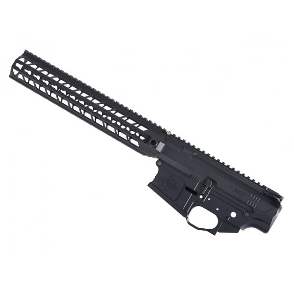

    thanks. nothing specific, but like this
    You don't want to mount anything to the railed fore end. They can move and mess up your zero. People use the cantilevers so they can be mounted to the receiver but still be mounted far enough forward for good eye relief.
    I thought you were talking about the monolithic uppers made by companies like MEGA. The MEGA maten megalithic upper is a good example. It is all one piece so nothing is going to move on you.
