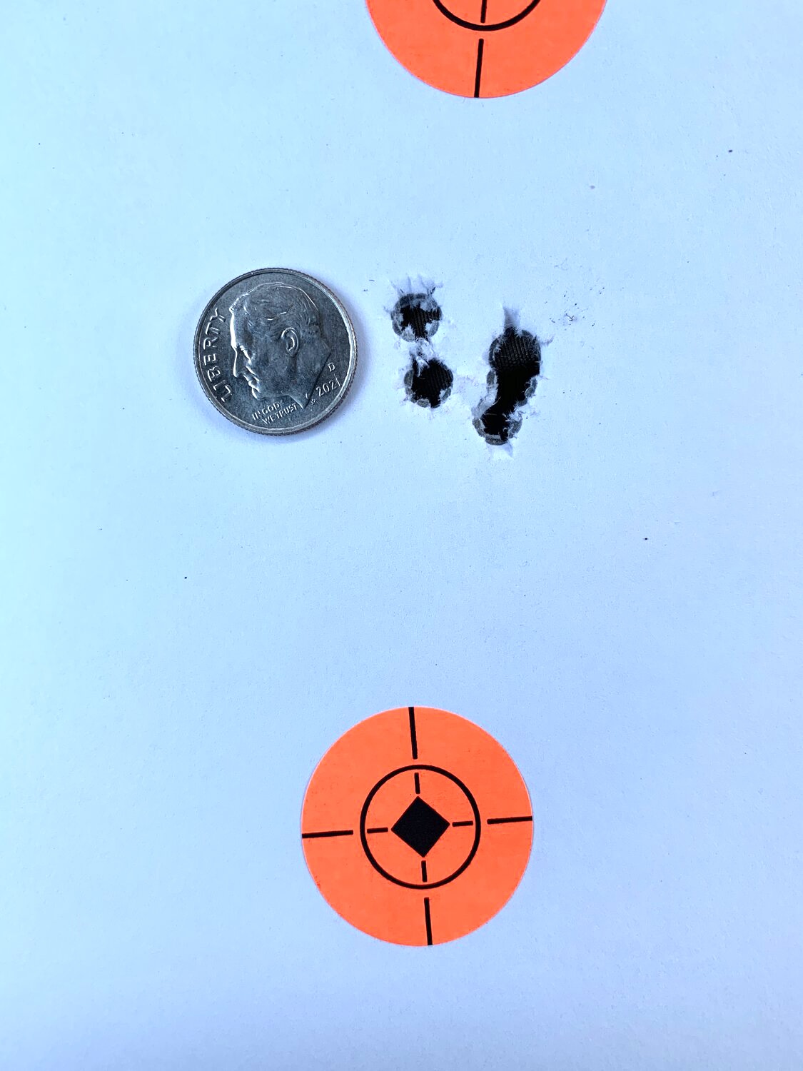

Ern
Said experience
Radian, proof cf .223 wylde 18", jp fmos, Geissele hi-speed NM, factory ADI 69 SMK
20 rounds loaded into a pmag, atlas front bipod, weibad range cube (8x6)
Fired a round roughly every 10-15 seconds, probably 30 seconds between shot 5 and shot 1 on a new group, ambient temp was roughly 80⁰f.
I am far from the best shooter and this was my first time shooting paper in a while. Bottom right was the last group. Very well could have been me. This rifle can do .3-.5 moa with some good hand loads for 5 shot groups.
The numbers do not indicate actual firing order. I didn't keep track of that.
I've done range days with about 14 pieces of steel from 200-800 yards and fired a pretty good amount of ammo. It handled it absolutely fine but it did heat up more than a steel barrel of a similar profile would have. You need to treat the cf barrels roughly the same way you would a lightweight profile.
