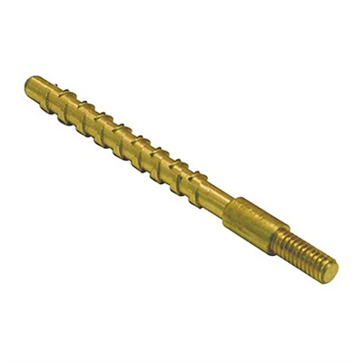

Switched to dewey wrap jags. I use the cheap bulk squares. Theres more uniform surface contact and they can go back and forth like a mop without getting stuck or falling off.
Personally I like the Parker Hale style jags (sold by Dewey these days) where you wrap the patch (square one) around the jag like rolling a cigarette (or a joint for you degenerates! haha).
Doesn't tend get jammed up as badly as on on a jag with a point.
