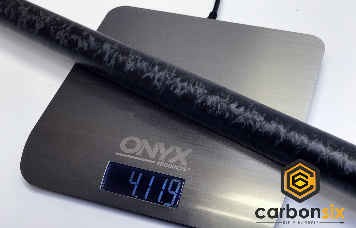

I just took pictures of this custom job. 28" long. 1.3" x 3" Shank. 1.20" x 1.5" Muzzle. The kicker...un-chambered and unthreaded. 4lbs 12oz. A steel barrel we measured that was slightly smaller was over 10lbs.
