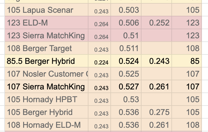

Columns: bullet, diameter, G1 BC, G7 BC, bullet weight
I did a spreadsheet of BCs last year and was pretty surprised by the numbers on that 85.5 hybrid. It's up there with the 105 hybrids and 107 SMKs, but I still hadn't seen much said about how they actually group, etc. since they were so new last year.
