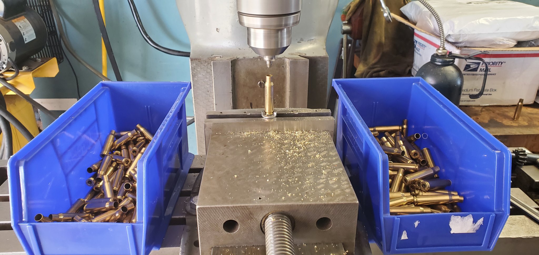

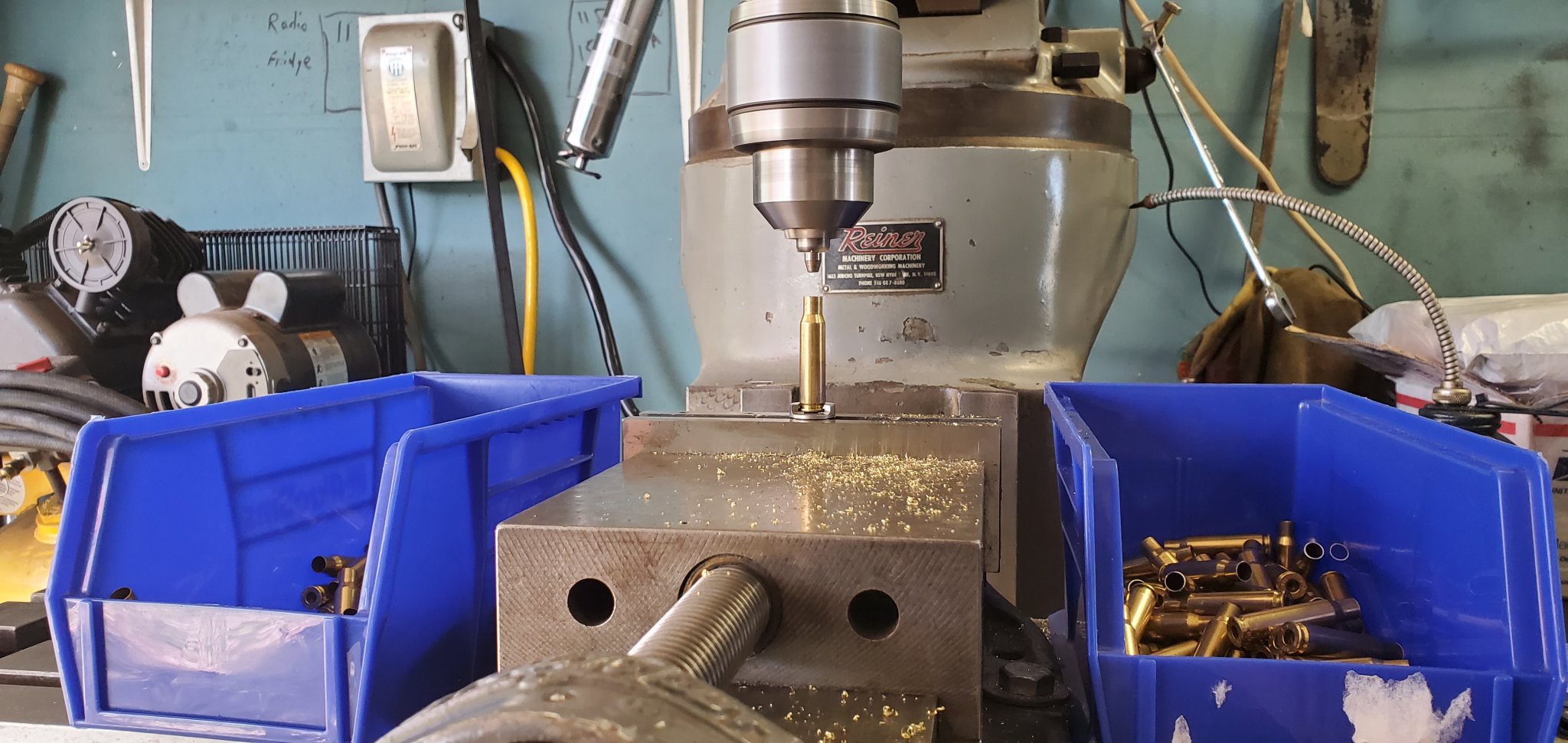

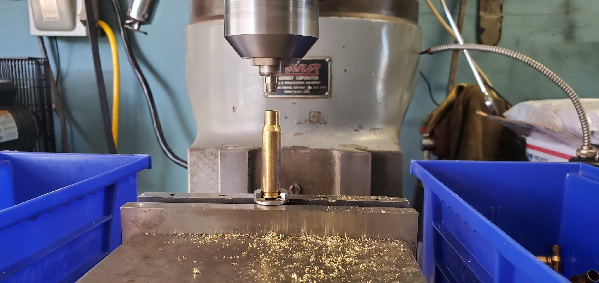

Im getting back into reloading for .308 and had to buy everything to get going. I have a nice mill set up in my shop and figured I can use the mill to do my case prep, trimming, primer pocket uniforming, flash hole deburring ,etc. Im going to setup a shell holder in the vise and use the micrometer depth stop to set proper depths and trimming lengths. 90 rpm in low gear should work beautifully. Anyone do something similar? Years ago I had a hand crank RCBS...eff that...lol I dont need to waste the money on a trimmer or anything.

Index the stop? Its a micrometer so once I set it to trim a case at 2.005, it'll trim every case at 2.005. So not quite sure what your asking?
As far as speed, I could've bought the tool to trim , debur, and chamfer in one step but Im being cheap..lol As fast as you can insert a case into a shell holder, pull the lever a couple inches and remove case is as fast as it can go... probably quick once into a rhythm...
Its been 10 years since Ive loaded but I never bumped shoulders. Fireform and then its neck sizing after that.
While every case can be trimmed to 2.005, the neck length from shoulder junction to case mouth can vary by a few thousandths for those same cases. I feel the uniformity in neck length is actually more important than the uniformity in case length. So, I'm asking would you be sure to get the kind of uniformity with neck length as you do with case length?

I get what your saying regarding neck length as opposed to overall length. I can index the machine anywhere I want so lets say I full length size for the 1st load( have to do that anyway), I can take a case and set the machine up off any point at the base of the shoulder, and then trim necks to equal length. That would provide the results your looking for and something I indeed may try for a small batch to test. Set up process is relatively the same so no big deal.
