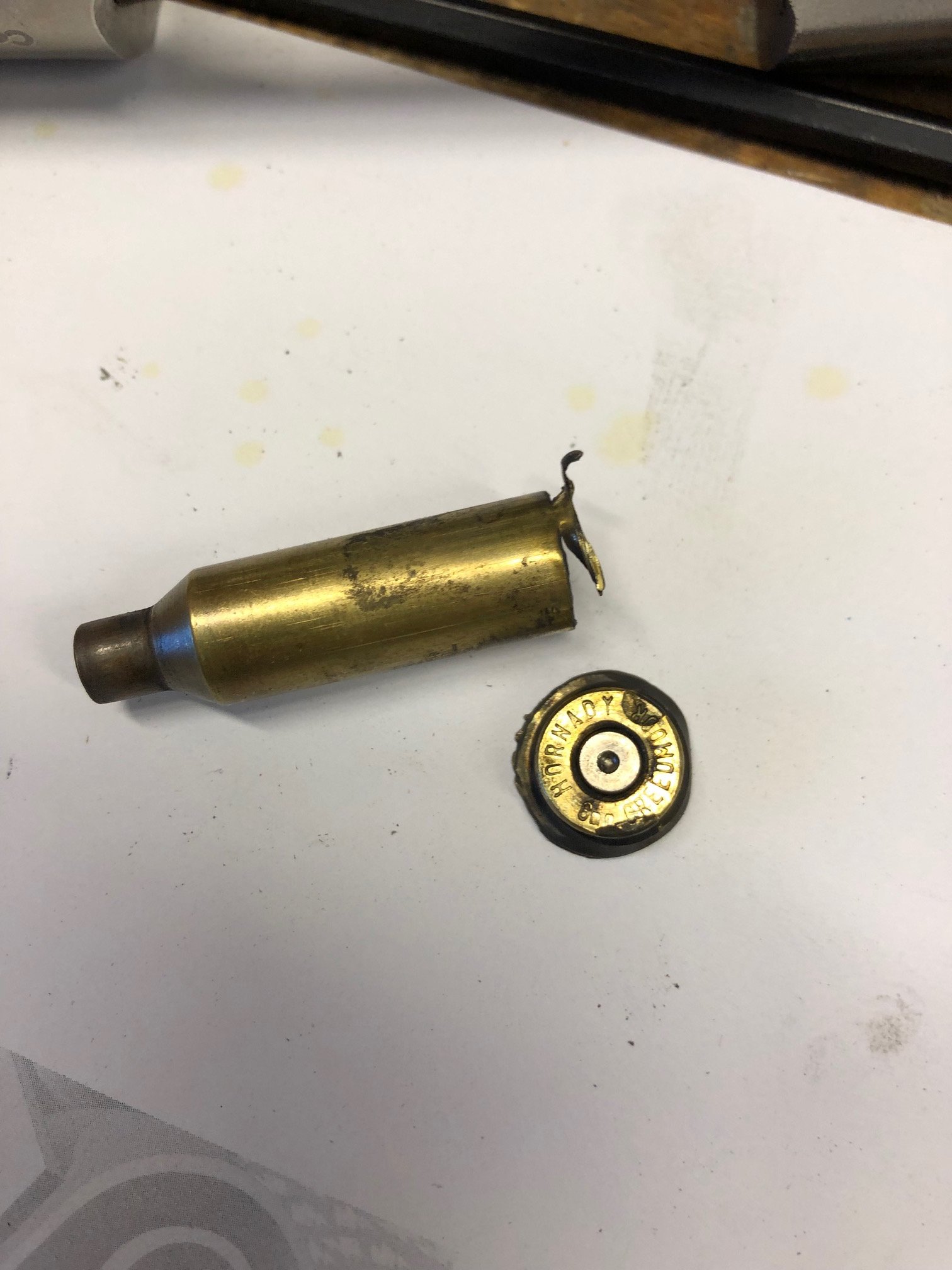

Hey folks, I hesitate to post this since I'm sure I'm going to get all sorts of responses of what I did wrong, should have done, didn't do, how stupid, etc., etc., etc. but it's worth it to me to post as a cautionary tale for other reloaders.
I was shooting my 6 Creed yesterday. Load is 44.5 grains R23, CCI 200, 105 hybrid and Hornady cases. The cases have been reloaded less than five times and never been over-pressured. 44.5 grains is halfway up the shoulder in the case. I've run it to 46 grains which is a completely full case with zero pressure. The action is made by Defiance for Brownells and called Stryker Ridge. Powder came from an 8 lbs. container which I bought sealed and I've used over five pounds so far with no issues.
I loaded 50 rounds with the FX-120. Each charge is then dropped in the case with a funnel and I move on to the next case. There's no way to overcharge since the case is so full and I've filled the case completely with no pressure. Low charges are unlikely since I'd have to spill much of the powder and it would be obvious it wasn't fully charged. Missing a charge completely seems unlikely given resulting overpressure.
I shot 30 shots at 600 yards and on the 31st, BOOM! Extractor broken in half, extractor spring gone and the bolt stop somewhere on the range never to be found. I jump back, pull off the ears and glasses and stand dumbfounded. Then, I feel the blood coming down my face. I had powder/gas burns on my cheek and nose and couple little spots under my eyes. I was wearing reading glasses.
The bolt easily opens. The case is still in the chamber. After collecting myself I set the rifle aside and pick up my other rifle to finish group testing with a few loads. Gotta get back on the horse so to speak.
I get home and take the rifle apart. There's no obstruction in the suppressor or barrel. A cleaning rod pushed the case head out with no resistance. I chucked the barrel in the lathe expecting to have to work at getting the rest of the case from the chamber. To my surprise I was able to pull it out with my fingers. A bore scope shows nothing abnormal in the chamber or throat. The action body looks fine with the exception of the missing bolt stop. I remove the firing pin assembly and nothing odd there except the overpowering smell of burnt powder/gas. The firing pin itself shows no marks from gas and the firing ping hole looks the same, normal.
I still need to pull the rest of the bullets and weigh the charges to verify. After reviewing my loading procedure I can only think of two items as a cause barring finding undercharged cases.
1) Case head rupture - I've had case head failures in other hotrod rifles but those usually come apart after firing and retracting the case. Those cases are also pushed hard which these weren't. I don't think this is it but I'll be checking the remaining cases for incipient case head failures just to be sure.
2) Stainless steel media - I don't use it often but I do use it. After running cleaned cases in a media separator I blow out each case with an air compressor from the neck and primer pocket. It's possible one was still in the previous case and lodged in the barrel. The 'boom' shot could have dislodged the pin but still been way overpressure.
The case clearly came apart violently at the unsupported portion.

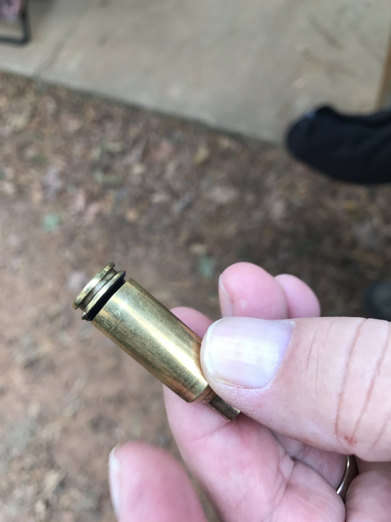

Scary but good thing you were wearing your glasses. A nice PSA for safety equipment if nothing else. Not sure what else I could contribute to this, you seem to have a pretty tight line on it. I sort of surprised that the bolt stop blew out way in the rear of the action and nothing else on it shifted beside the extractor which would be the first thing to go. No cracked lugs or bulged receiver threads? If you dont feel comfortable checking that stuff Id be scared myself and Id probably have defiance check it out or send it back to brownells for that badass warranty to check on it.
Whats your sizing regimen? Could be over worked but the rest should be showing signs if this one was that bad.
Every case is annealed with an AMP before sizing. Each case is individually measured for shoulder bump.
I wouldn't rule out a 6.5 bullet in the box. It's a 500 count Berger box. I'd like to think I'd notice the difference in length because the only other Berger 6.5's I have are the 140 Elite Hunters that I sold a while back. It would have to have been mixed in from the factory.
I've not measure the threads in the action. It was still very tight when I pulled it from the barrel but didn't feel any tighter than others i remove that were torqued to 80-100 ft. lbs. I did visually inspect the lugs and see no bulges or galling.
The action survived and so did I. The damage was pretty impressive to not have a stuck bolt with severe lug damage. The marks on my face indicate the gas came through the bolt shroud directly back to where my cheek was welded to the stock. Straight back! It's a testament to strength of the action.
My next call is to Defiance to pick their brain. The next call is to Brownells to check their lifetime warranty for what boils down to user error.

My first call was to Defiance and they asked if the bolt lugs were galled or set back. They said they've never seen the action body stretch in any way and it's always the lugs being set back. They said they'd send me a new bolt stop kit and extractor. I've sent them the picture to see if the bolt stop could be installed properly given the stretching around the pin holes. All in all a great response from them.
I have 200 more prepped cases I was going to load after this initial 50. I'll be checking them all for case head separation. If I find more than a couple I'll toss all of them and start over with my new box of 500 cases. What a waste of cases!
In regard to an oversized chamber, I don't think it is. The go-gauge drops perfectly but tight with .001" tape so it's good there. It's possible the diameter near the base is larger given it was chambered between centers but nothing different than all the other rifles I've chambered. I'll measure the fired cases from yesterday and compare to the sized cases that weren't fired to comparison.

I'm using a Wilson hand seating die and an oversize bullet won't even fit into the die to be seated so I've eliminated that as a possibility.
Regarding pressure, you're right, I'm seeing signs but it's always possible it's too high.
To get my AMP setting, I tested five cases in Aztec mode so I know it's pretty set there. Yes, I barely see annealing marks and it does end just below the shoulder about where you see it on new Lapua brass, maybe even a little less.
Seating it into the lands is a possibility. I'm about .005" off at my seating depth so it wouldn't take much to be into the lands. I would expect to have felt bolt resistance when closing. I certainly won't rule this out as a possibility, though. It's on the list of culprits now.
You can see the picture of the case how it expanded about as far as it could in the unsupported case head. That's what broke the tip off the extractor.

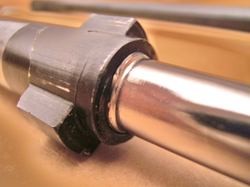

This looks very similar to another thread about the same type of failure. How much unsupported case is there between the bolt and the chamber?
Suspiciously similar case failures from too much exposed/unsupported case web:

I did the chamber. If I remember correctly, the bolt nose clearance was .012". But, I'll reassemble it and do an actual measurement with a shim stock that I use just for this purpose. I used Manson's bolt body counter bore cutter.
.001 - .002" on the shoulder bump.
I lean towards it just being a bad piece of Hornady brass....

I'm going to measure fired vs. sized case base diameter.
The first six cases of the 50 round batch averaged 3191 with an SD of 6.2 yesterday.
There is no chamfer on the chamber itself. There's a chamfer on the outside of the bolt nose recess.
Not scientific but Quickload says 3191 fps from a 25" barrel with RL23 takes almost 70k PSI. I'd put it up in the category of a hot load.
No doubt, 3191 is scooting in a 25" barrel.
That said, I've fired a few cases with WAY more pressure than that and never had a problem. There is something else going on, even case head sep brass does not leave a distinct ledge when it comes apart, gap somewhere, he just accelerated the issue.
This looks very similar to another thread about the same type of failure. How much unsupported case is there between the bolt and the chamber? ...
I doubt thats the case here and it definately wasn’t the case in the accurateshooter post. The OP claimed the bolt was blown back. For that to happen the lugs must fail, the bolt rotates open, or the round fires out of battery. That incident sounds like a trigger issue that allowed the firing pin to release on bolt closing.
I can't see the pics any larger than they appear in that thread. They do look suspiciously similar.

I cut open a couple of cases and none are showing signs of separation. Comparing the cut ones to the failed case I can see it separated above the web, right about where it was sticking out of the chamber. While I'd say could be a contributing factor there has to be more to this. I will certainly be setting the barrel back a couple turns and get the clearance more reasonable. I may go ahead and trash this brass just to make myself feel better. It won't feel better in the pocket but mentally it will.
I seem to remember one manufacturer recommending .015" but I can't find that anywhere in my saved paperwork so maybe I dreamed it.
I reassembled and tossed in .015" shim and it closed easily so it's definitely too much. On the first few I left them at .012" and now keep them .005-.008". I don't know how I could have left this one that much but I apparently did.

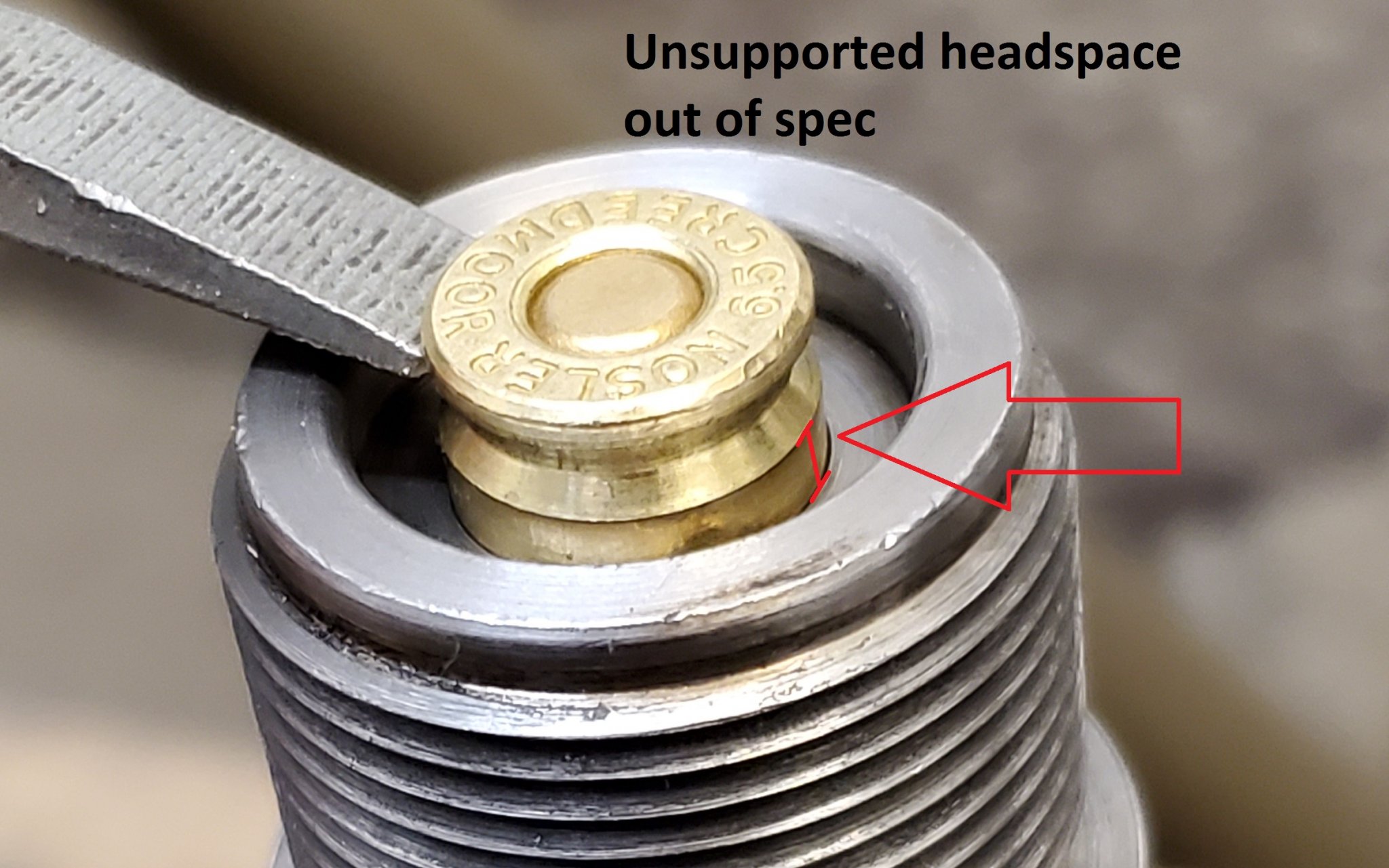

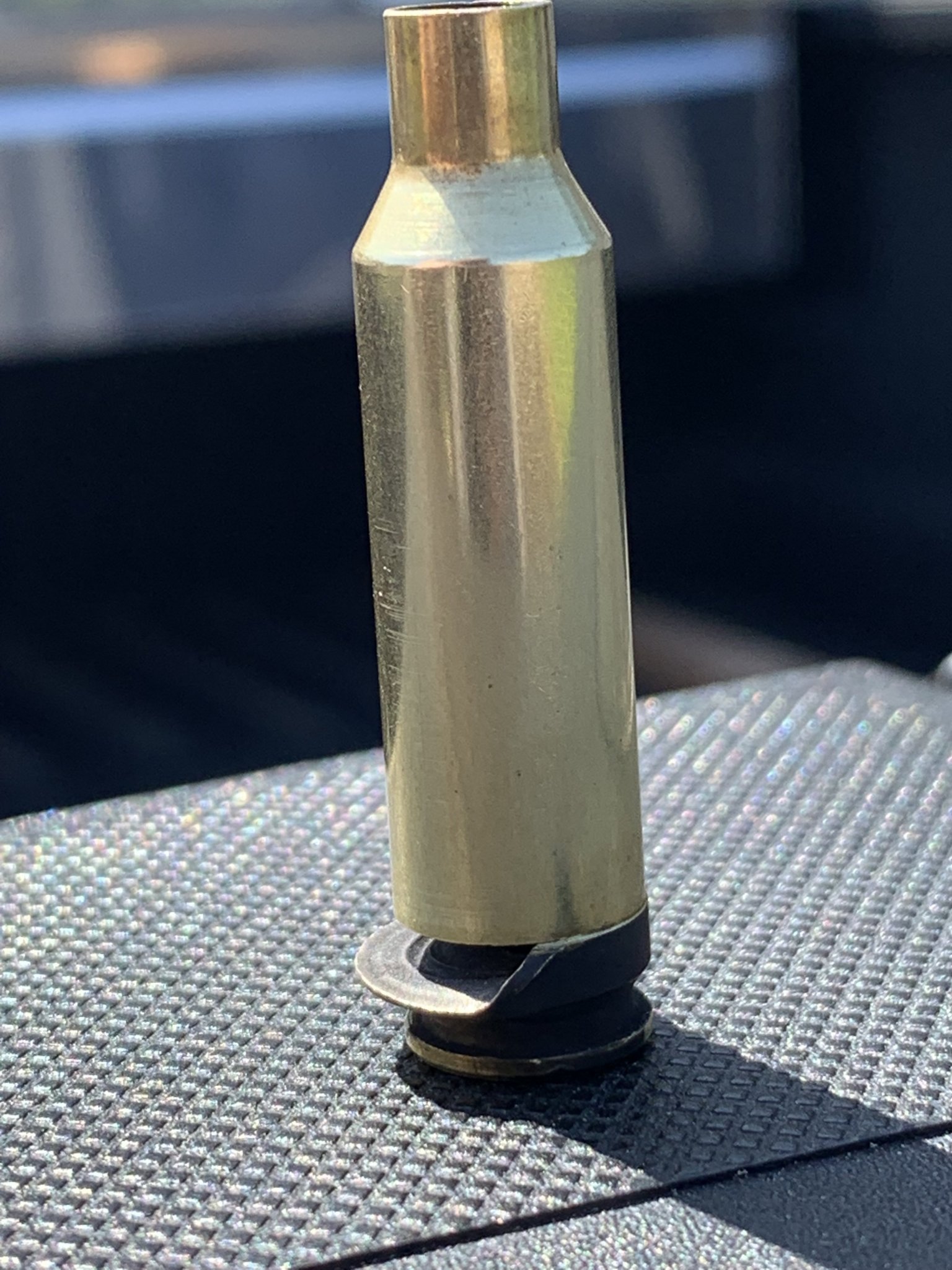

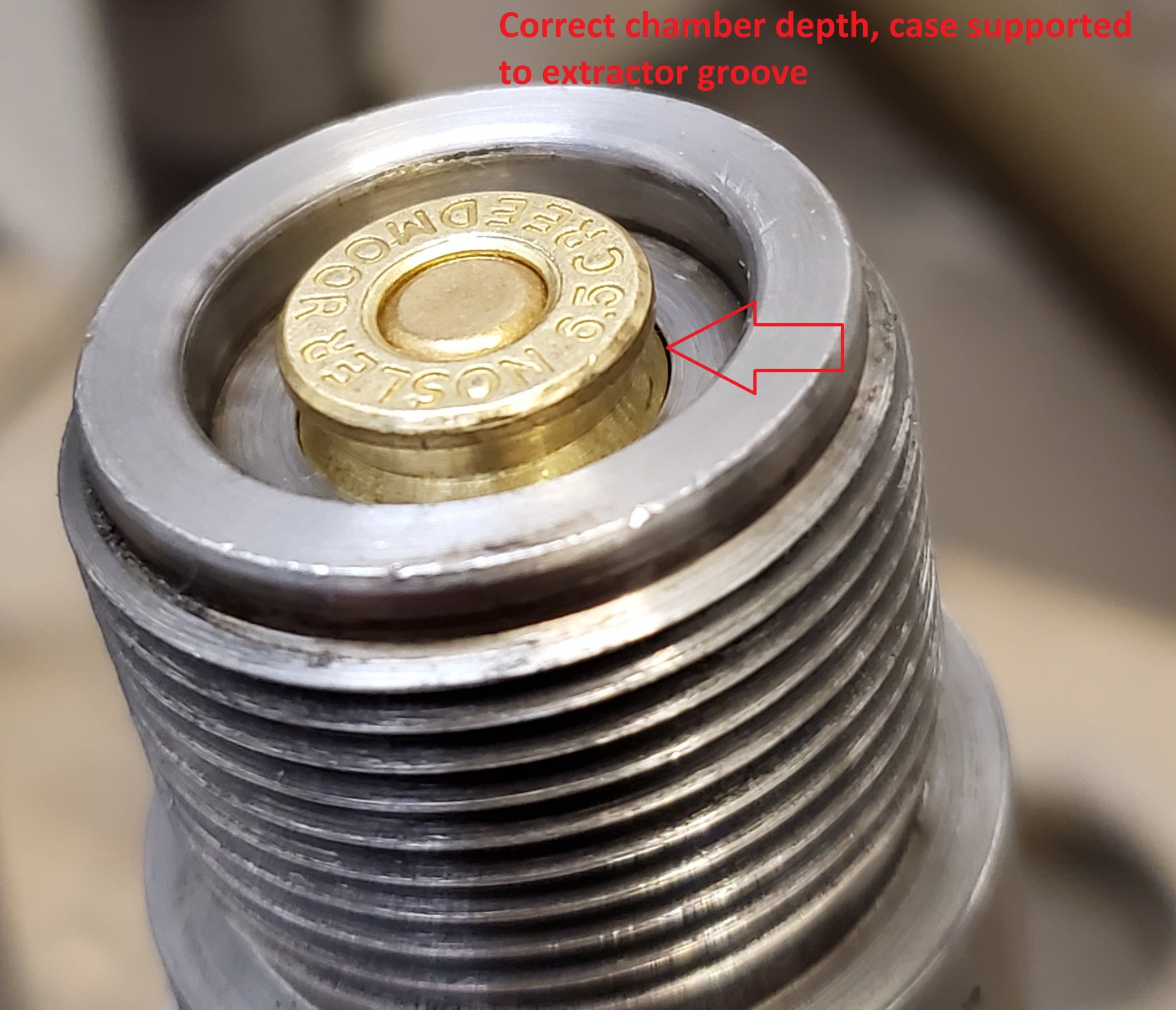

Doom, Read the linked thread again. In that thread, the bolt did not leave battery per his description post-mortem later in the thread.
Anyway, here are some of the full-res pictures from that thread. The OP (first attached pic) did not really provide a lot of empirical infomration other than "[Nosler tech support guys] think it is the 'unsupported case' issue." You can see a LOT of soot going well up the side of the case web.
The second anecdotal picture was captioned: "Too much unsupported case as stated above. This one was the 10th round and was an X. Shooter almost lost an eye."
The third case picture is reportedly a factory Rem 700 with a severe overpressure factory Winchester .243Win round. The brass flowed into all the nooks and crannies but did not have a head separation implying an in-spec factory bolt face/chamber relationship.
The last two annotated pictures are the OP's depiction of "out of spec" and "correct" chamber support.

Those are much easier to compare and my failed case looks fairly similar. I don't have nearly that much case sticking out of the chamber as the casefail4 pic.
Logic would say that particular case was either a bad case or was in horrible shape compared to the others I cut open which showed no signs of separation. If the case was in sad shape, add more unsupported case than is necessary and BOOM!

Honestly, I don't think the bolt was forced any further back than the lugs. There's no gouging or setback in the lugs. Headspace is less than .001". If I pushed the shoulder back .003" that's a total of .004" the case can move back. If the lugs don't give that's not much movement. Based on the primer still being in the case head and the fact that 80% of the case head was separated I think all the gas and force simply went around the case and bolt. If that makes sense.
All cases were trimmed with a Giraud. Actually, they were cut to .905 by accident so shorter than necessary.
I did and its a shame the OP didn’t post what he ultimately found.
You are correct that he did say the bolt was closed and in the same post implied he was not the shooter so I question which is the correct story. Obviously, it is critical to the determining the root cause.
Note also that the last two pictures you show are not from the barrel in question but are an example from Nosler showing an example of what this issue would look like. The screwdriver is elevating the round.

@parshal I would cut some of the other cases you fired and check the web for any thin spots.
A gremlin came into my reloading space and screwed my sizing die down an 1/8th turn after about 4 or 5 reload cycles. I realized this when I had a case separation on about my 7th reload cycle. Out of 150 pieces of brass I had to throw 39 away, using the paperclip method for checking for the thinning ring inside the case. When the case separated I didn't even realize it until I tried to chamber the next round so I don't think this was his issue, or at least not the only issue. I didn't blow anything apart on my rifle/bolt/face and once the separated case was removed and compromised brass chunked in the trash, everything is back to normal.
Please excuse what may be a stupid question, but if the bolt was engaged and didn't move back, what caused the bolt release to take a flyer? If the bolt lugs were engaged, what force acted on the release? Am I seeing some distortion on the action at the top of the release cutout?
I'm fairly new to hand loading at this level, so I would realy like to avoid this particular part of the learning curve.
The case separated right where chamber support stopped. I measure the shoulder bump on each case as it's sized to verify shoulder bump.
I reported above that I cut numerous cases open and found no evidence of thin spots. Maybe this was just a case that was thinner than others.
Did you figure out how much bolt nose clearance you had? I know you said it was greater than 0.015.
Any base diameter measurements? Just thinking along the lines of ruling out brass working at the base being a contributing factor.
