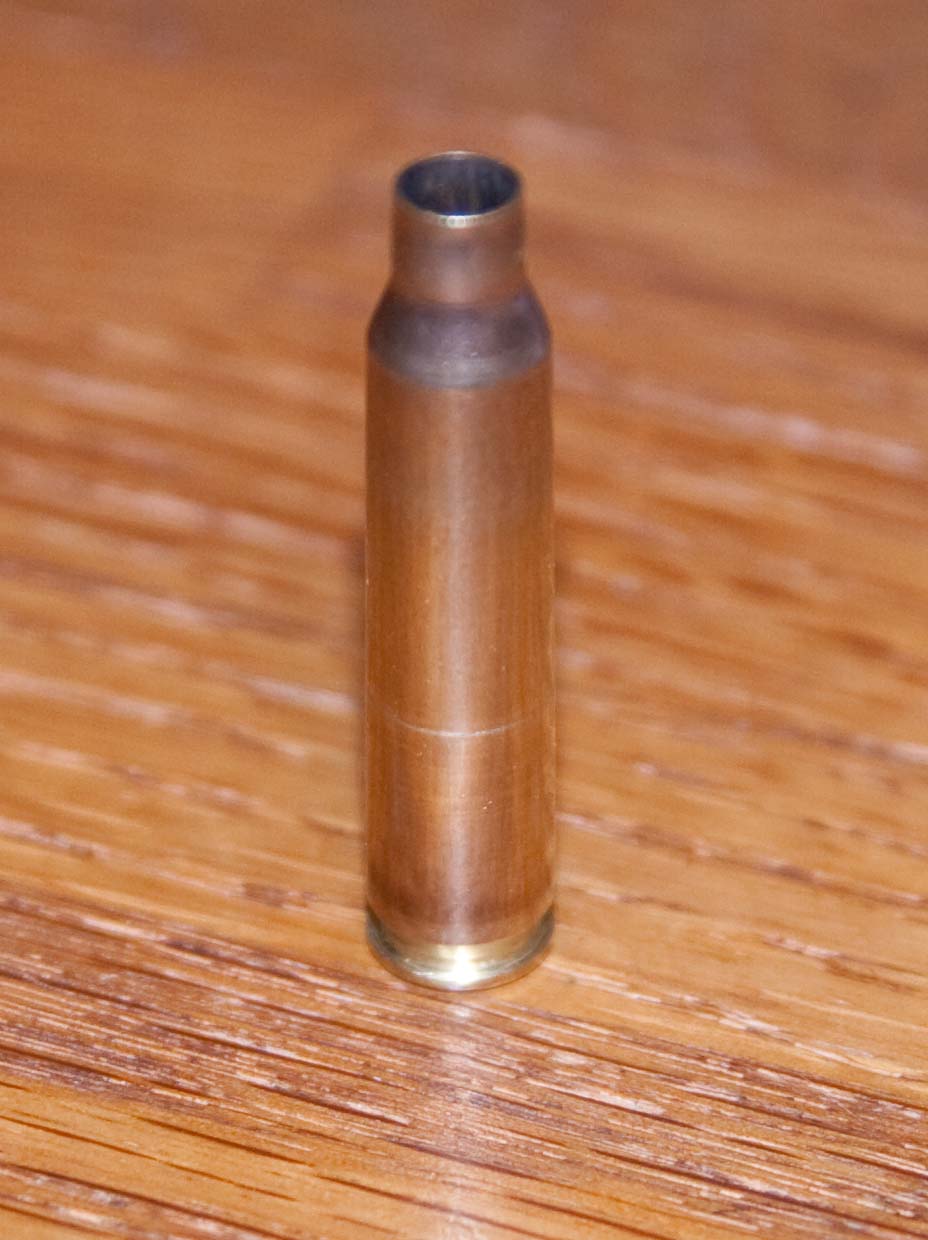

Last Wednesday I had a case separate about half way up the case. It left the top half of the case in the barrel. I was able to remove the case using a chamber brush. I had been noticing a faint circle around some of my cases but the circle was smooth inside and out. The batch had been fired 16 times so I threw out the entire batch. I am loading tonight and found three cases with the ring and I could feel the outside ring with my fingernail and the ring inside the case with a paperclip. This batch had been fired four times. Any idea what might be causing this.

16 times was a bit too much. I am bumping back about .002". My primers indicate 'possible' over-pressure but I don't know where it is coming from since the measured velocity of 1,750 is not high.
Photo of ring and primer.

Bump is measured with a Sinclair Comparator. I only use Lapua brass although that doesn't guarantee the brass is identical--same batch. I am only using Varget through this whole process. Actually the same can. The separation occurred half way between the head and the shoulder. Die marks don't usually turn into rings that can be felt. I now have three such cases out of a batch of 50. They didn't separate but they are on the way. The sizing die is a Redding bushing die and I have reset it to make sure that is not the problem. I am using 24 grains of Varget behind a 69 SMK. Chrony shows velocity averaging 2,750 fps. Doesn't sound high pressure to me. Charge weights are measured with an RCBS 10-10 and re-checked with an RCBS 5-0-5.

I owe everyone an apology for wasting your time. I did measure the shoulder bump for a batch I loaded today and one I loaded a few days ago. No problem. I just remembered I had a batch from two weeks ago and so I measured the bump. The numbers were all over the place and would certainly cause the rings and case separation. I had changed sizing dies and made a mistake in setting up the die. Sorry for the trouble.
