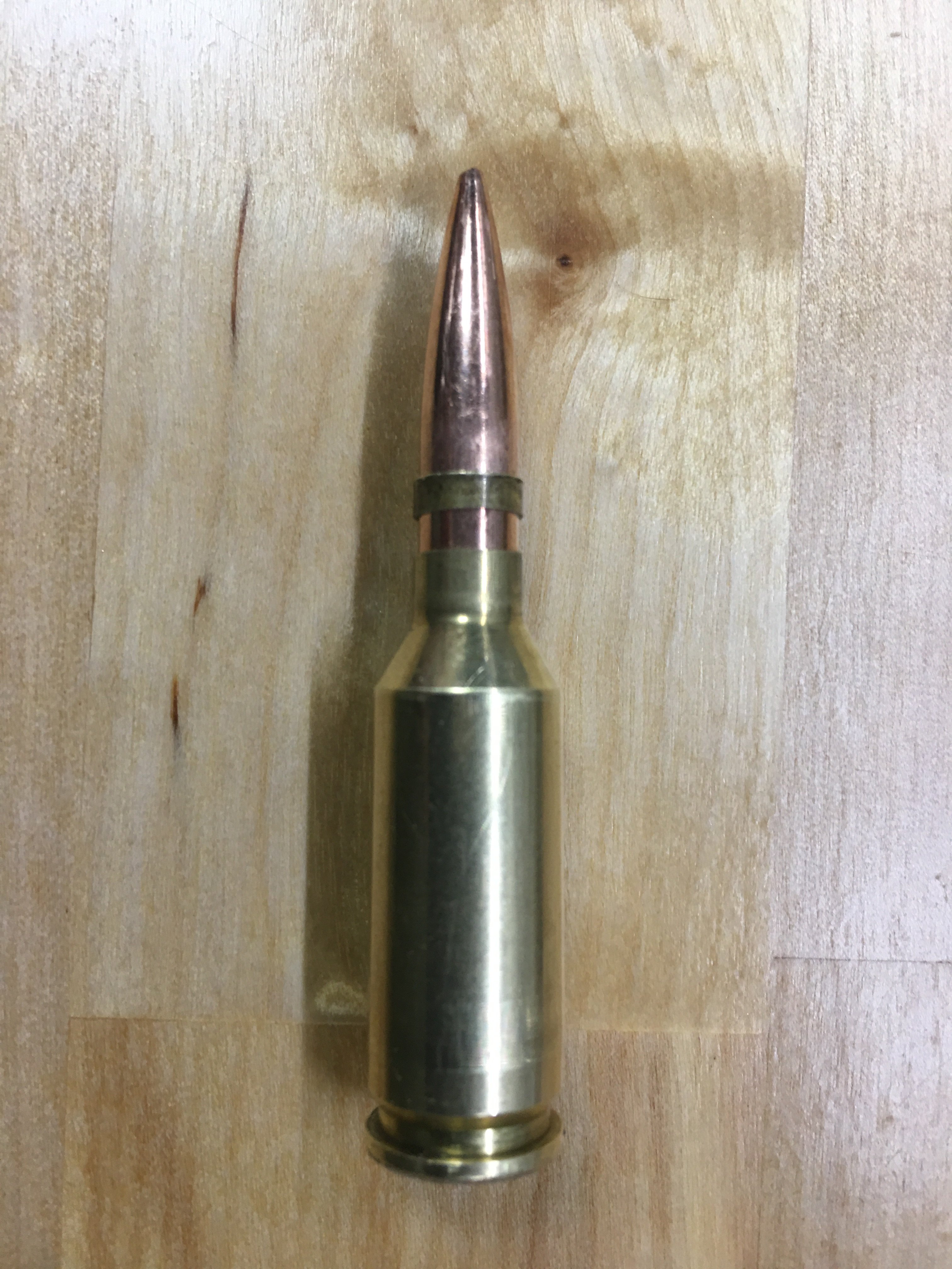

If you use a resized case, fire formed in your chamber and cut the neck in half like in the above picture you could obtain the exact measurement for trim length. Easy and quick.
If the neck tension is slightly higher on the case you can get the bullet touching the lands measurement as well at the same time.

I like this method better than using the Sinclair Chamber Length Gauges. The Sinclair gauges will give you a false chamber length that exceeds the true length shown by your reamer print (bolt face to end of neck).
