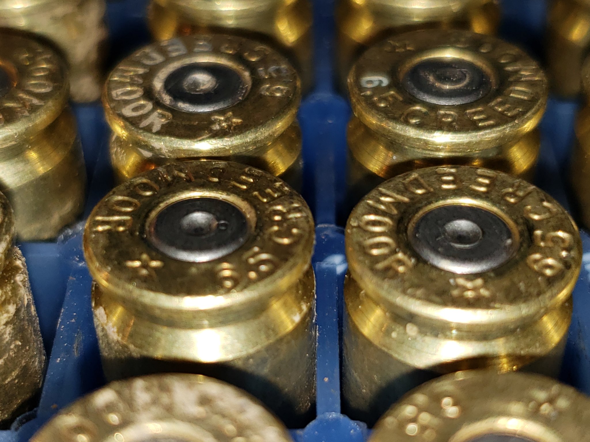

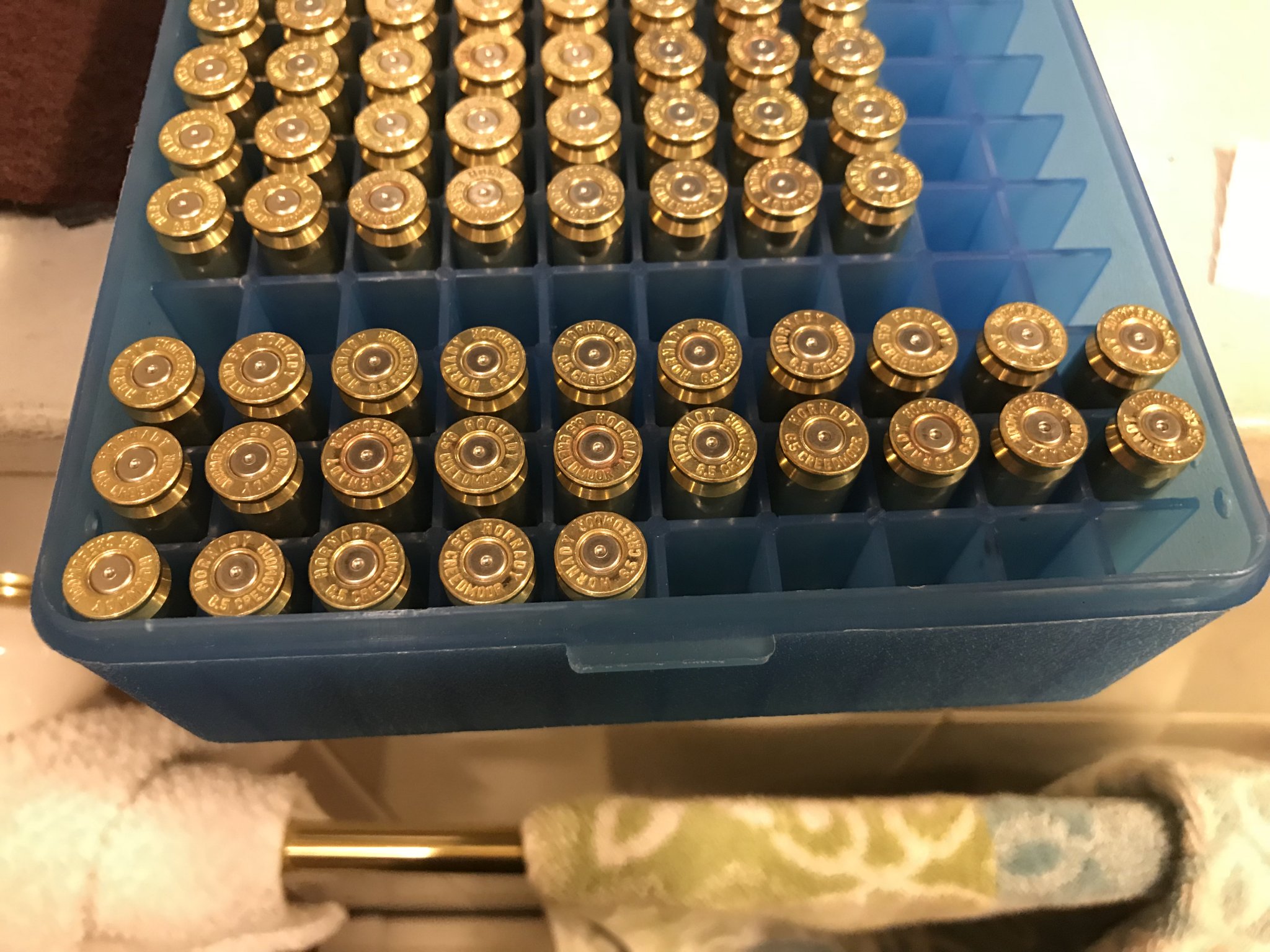

Her is a photo showing what Im seeing:. Shot today, all loaded with RCBS 1500, SD 7-9, and random primer flow.
Pieces on left no flow; on right crater that catches fingernail. Counted 24 out of 50 had flow + firing pin dent flattening back outwards. The others look normal. They are in box in order shot and it is completely random: some on first shot others midstring and some strings had only 2-3 of 10 rounds per stage.
Just a visual. Will clean left over rounds and see if that eliminates.
