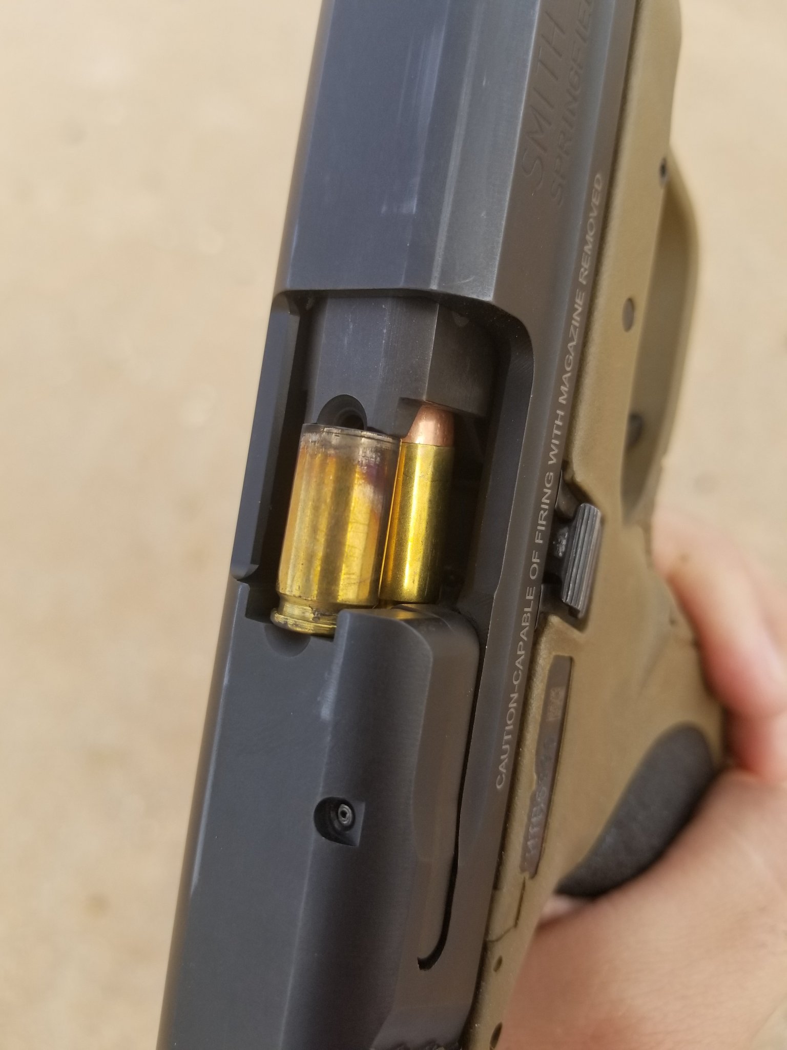

What would you guys say the cause of this is? It's a m&p 40 with a storm lake 9mm conversion barrel and I'm shooting 124 grain round nose bullets hand loaded with 3.9 grains of 700x at 1.135 oal. I get this maybe once every 75-100 rounds so it's not happening alot but it is frustrating. I put an apex failure resistant extractor in it and it didn't really change anything. Are my loads to mild or to hot or does that have nothing to do with this? Looking to get some feedback from you guys. Thanks in advance!
did you swap recoil springs?.......im assuming the 40mm is stronger than the 9mm, and it might not be cycling fully
Reactions: Fig

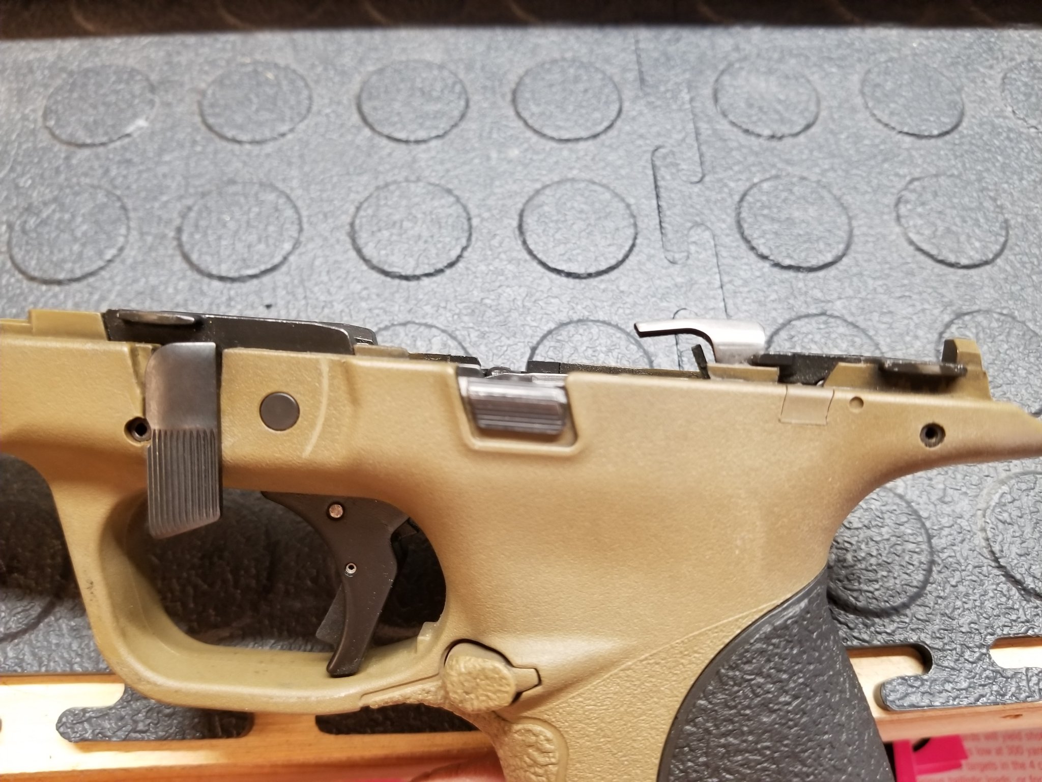

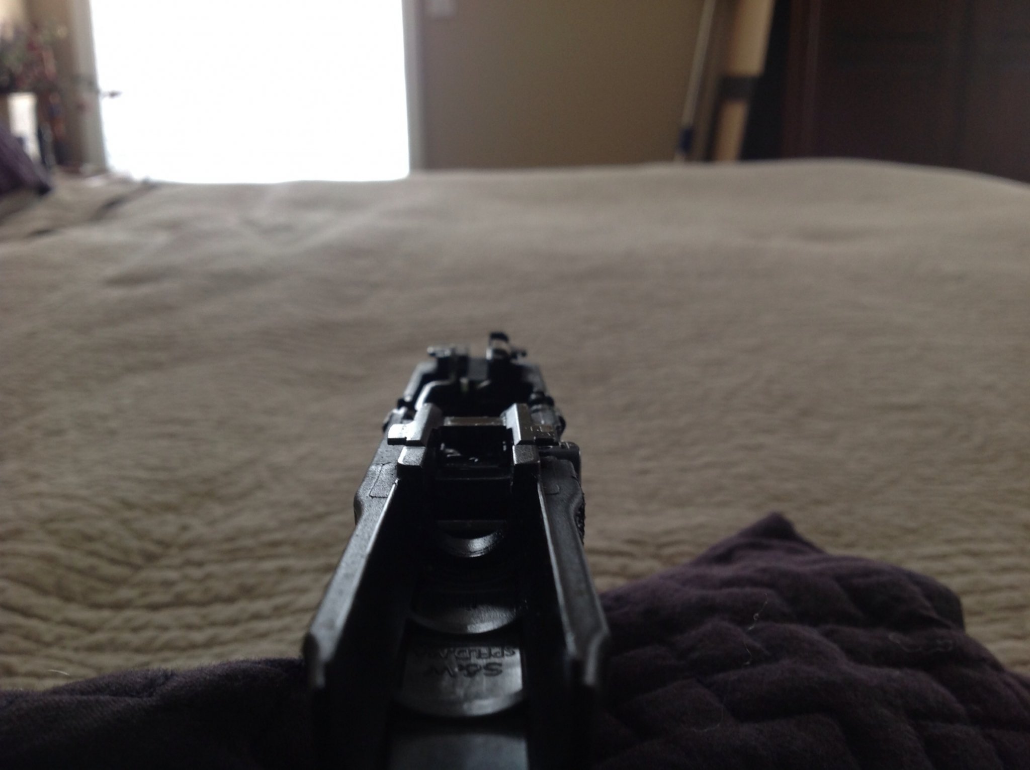

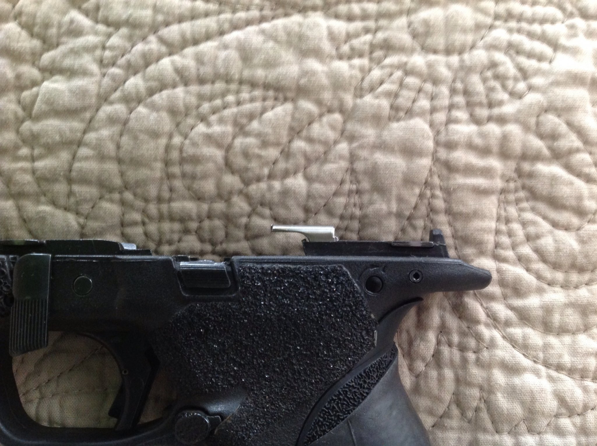

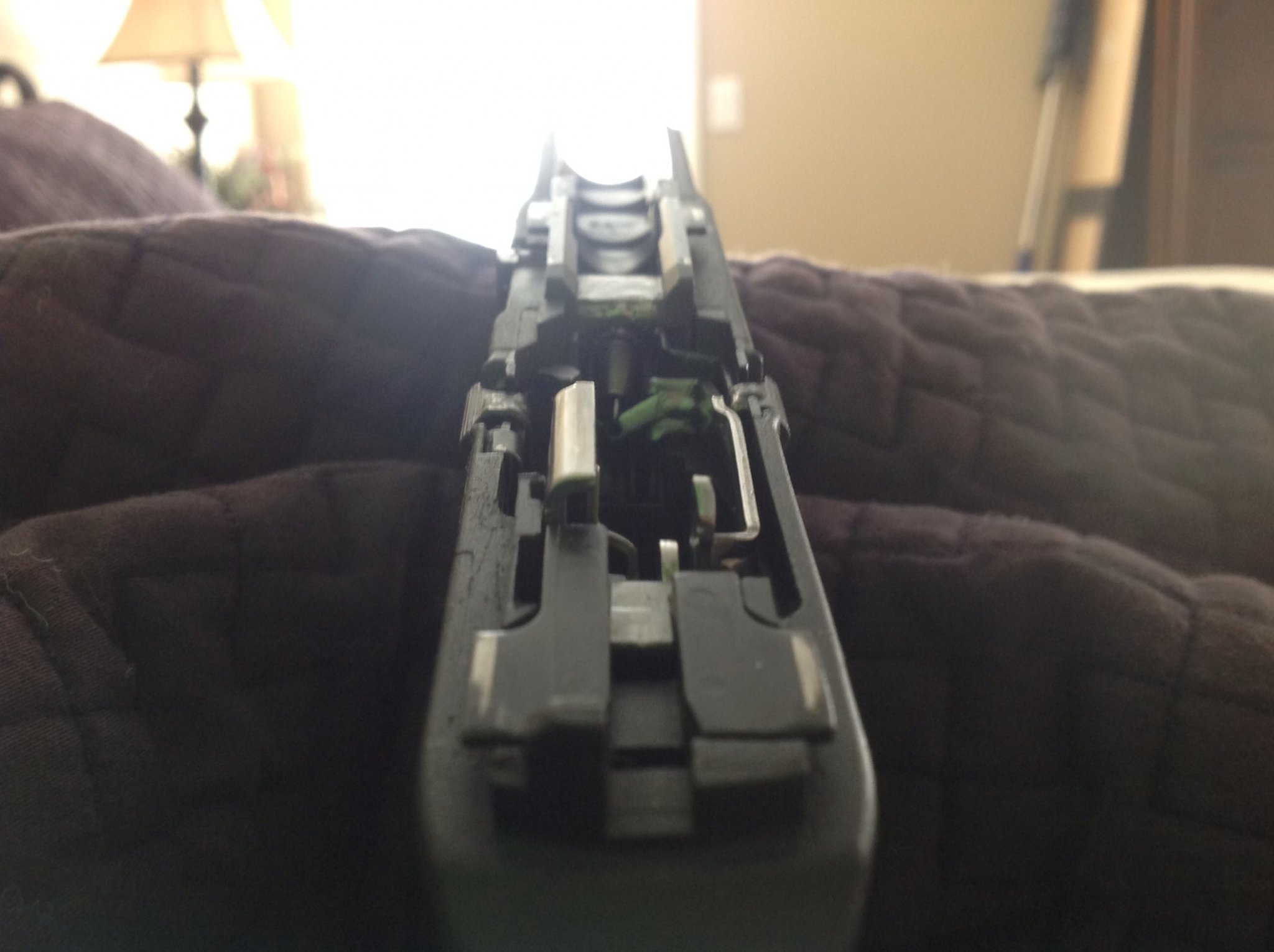

When putting the M & Ps back together, take care when the slide comes in contact with the ejector, if not lined up properly, it would be easy to force the slide unto the frame and bend the ejector. Here's photos of my M & P.
Mike
