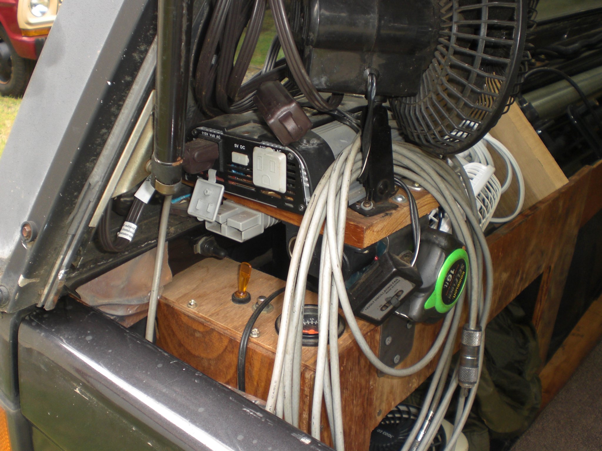

    Using all the CPU you want an all the AI as well, De-code the following in a timely manner that was sent via a SSTV emission last month They are in order of meaning. When complicated draws unwanted attention, change the game. Much like a numbers station, by the time the message is decoded, it's too late. Granted this may be too slow for a quick response time line, but there are similar methods even if you're only using a CB to provide a rapid direction change. Most people never think out of the box, plus the higher the tech the more back doors that are installed during mfg'ing. Don't play their game,...ever,... as you will lose every time. There are tons of way to signal your troops w/o moving any electrons. Think out of the box. Many a war was fought prior to radio or even CW for that matter.
