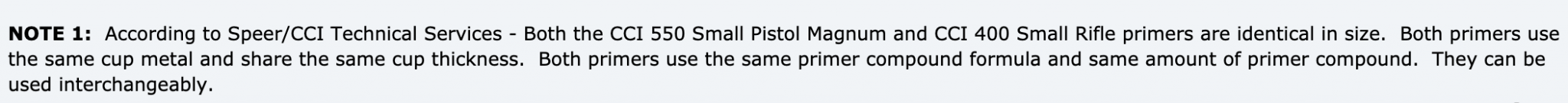

    According to a very good thread / article on primers on the SKS boards:https://www.sksboards.com/smf/index.php?topic=56422.0
    The #550 has the same cup thickness as the #400.
    A footnote from the article:
    This article was posted in 2009 and updated in 2013.
