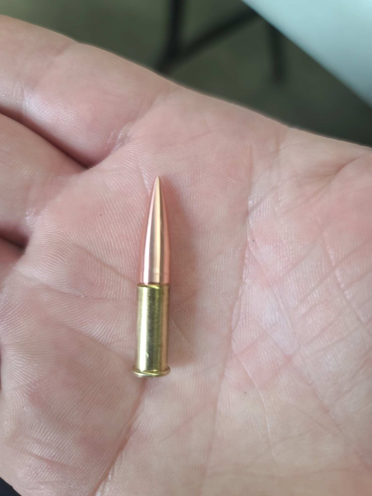

Like these?

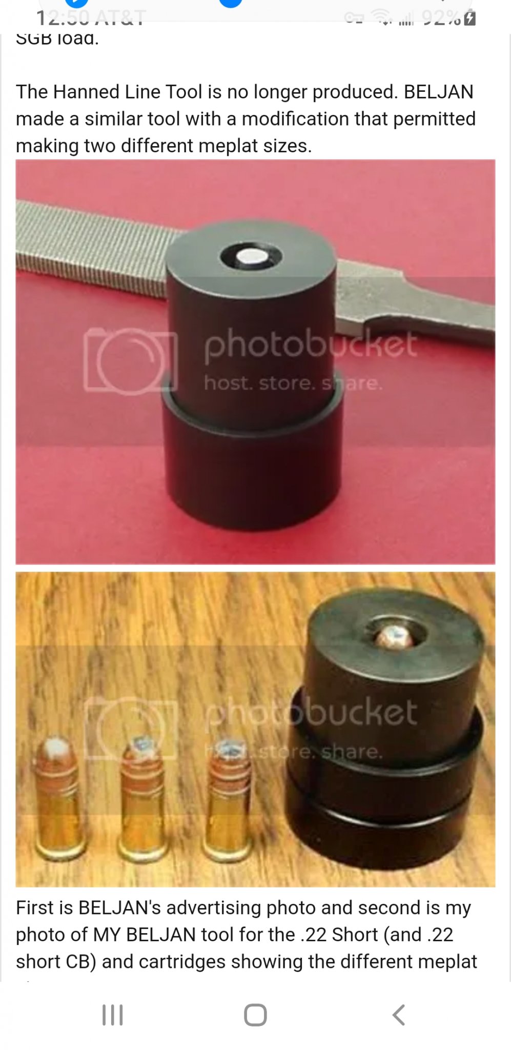

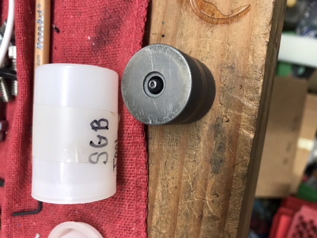

I chased this rabbit too. Spent time and money (Waltz die set), chrono, bricks of CCI SV. The fact of the matter is that while CCI SV is probably the best of the cheap bulk stuff, it's not in the same league as the good stuff.
I still prefer CCI SV in my 10/22 because it's reliable and more accurate than other bulk stuff, but my precision rifle gets fed a different diet.

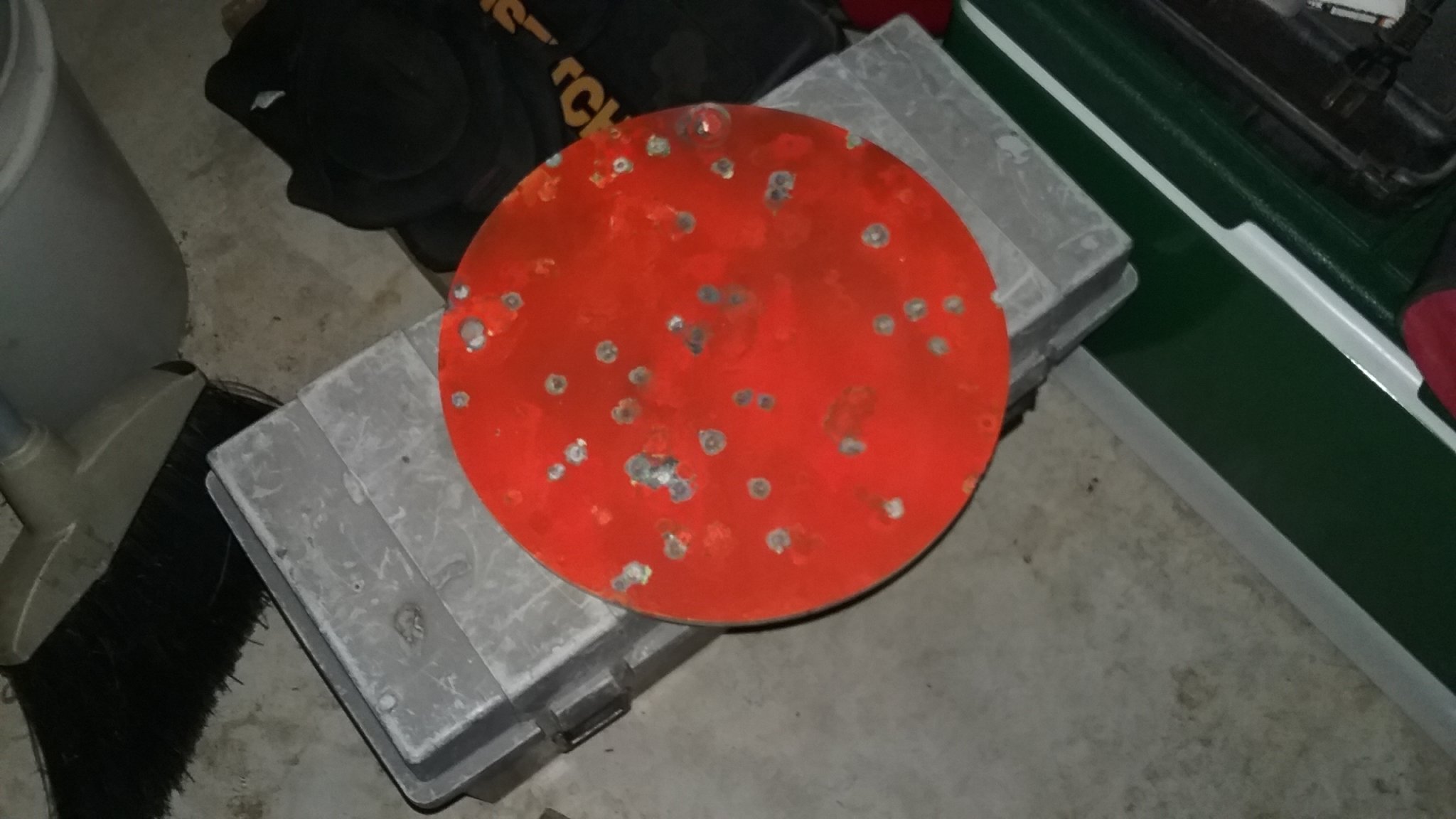

I shoot with a group of guys every Friday, We shoot out to 400 yds on steel knockdown's. We have been trying cheaper ammo to cut cost. I have picked up a lot of CCI SV during the last ammo shortage. CCI SV shoots very good out to 150yds, but you start to see a lot of vertical at 200yds and beyond. I don't think there is anything you can do to make cheaper ammo ( and higher priced ammo), shoot better. Ammo is going shoot how it shoots.
I have been working on a new Bergara B14R. I have been shooting a lot at 285yds and 330yds lately. I shoot at clays on the berm to see what kind vertical the ammo getting. I dial off to the side of the clay and watch for the spread of vertical, then I know what the ammo can do.
We shoot the cheaper ammo knowing we will only get 50% hits rate. We have had good luck shooting, CCI SV, Fed Auto match and HV, Eley Force, Norma Tac22, Norma match, etc. We have found that ammo, that does not shoot well at 50yds can shoot good at longer range.
I would not spend the money to make cheaper ammo shoot better. Shoot it as is and know how it shoots. Spend the money on your good ammo.

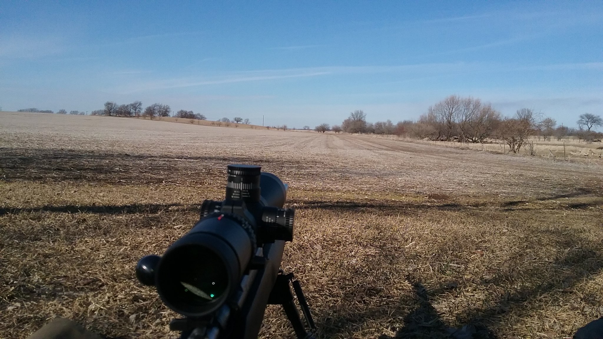

We had good conditions yesterday at the range Hot 90 degrees humid but very little wind. We shot at 225yds, 285yds and 330yds. I got the Tikka T1X out to test cheaper ammo. Norma match and Tac 22 shoot about the same, they ran around a 12" of vertical out to 330yds. I had a old lot of Wolf match target ( made by Lapua ) That ran about 24" of vertical at 330yds. Lots of drop out's. Fed Auto match was just a little better than the wolf. I have 2 lots of CCI SV that shoots moa at 150yds. They ran about 7" of vertical at 330yds. It still had a few drop out's, but not as many as the others. With any 22 lr ammo you will see drop out's and high hits. SK Std + ran about the same as the CCI SV. with less flier.
I run SK Biathlon and Eley Club for my match ammo. They will run 4" at 330yds. Now that I have the vertical worked out. Now you are working with the wind. My range is on Windy Gap MT., We have some wind most of the time, and it will add to vertical also. We shoot, see our misses and make corrections.

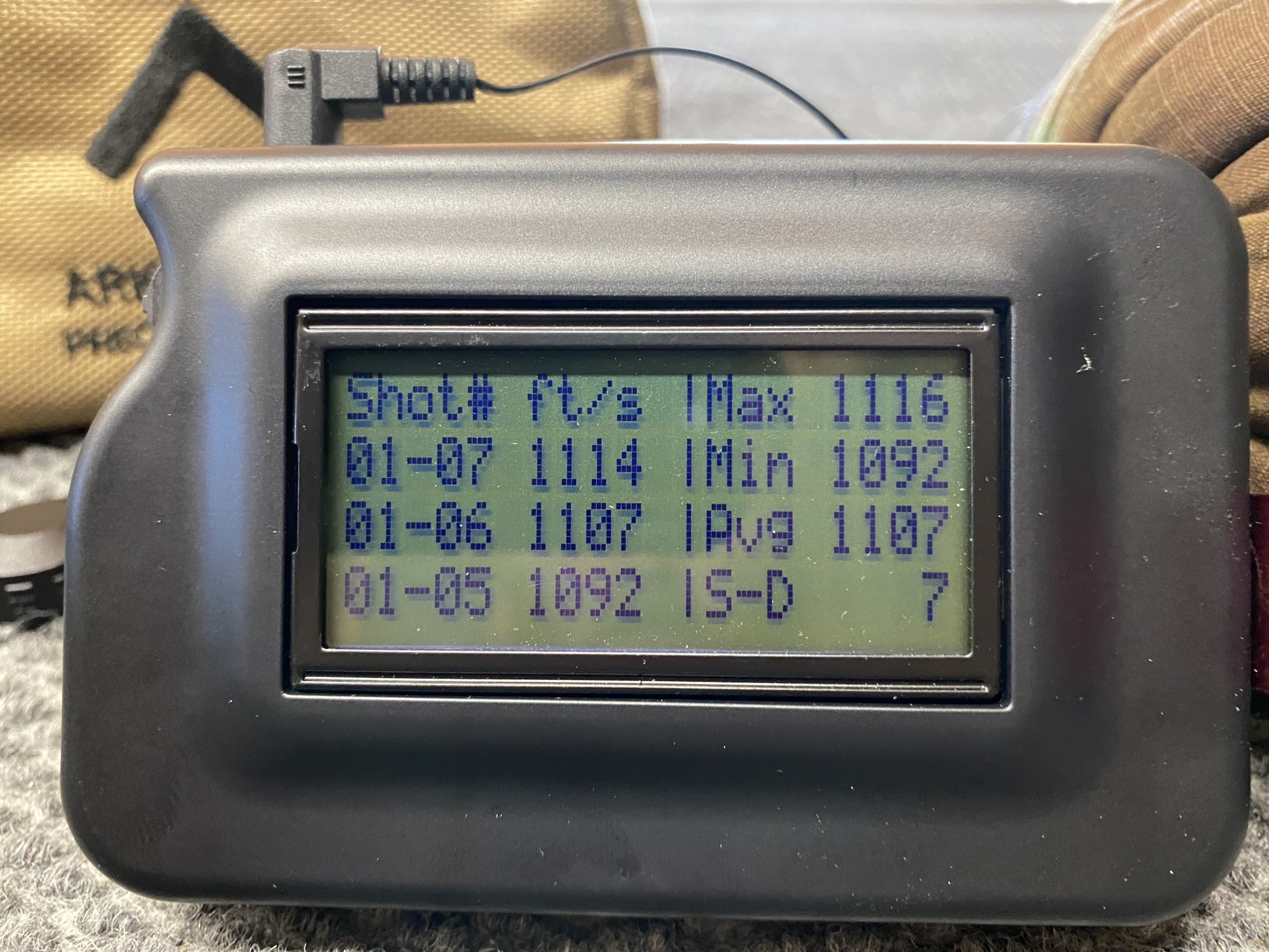

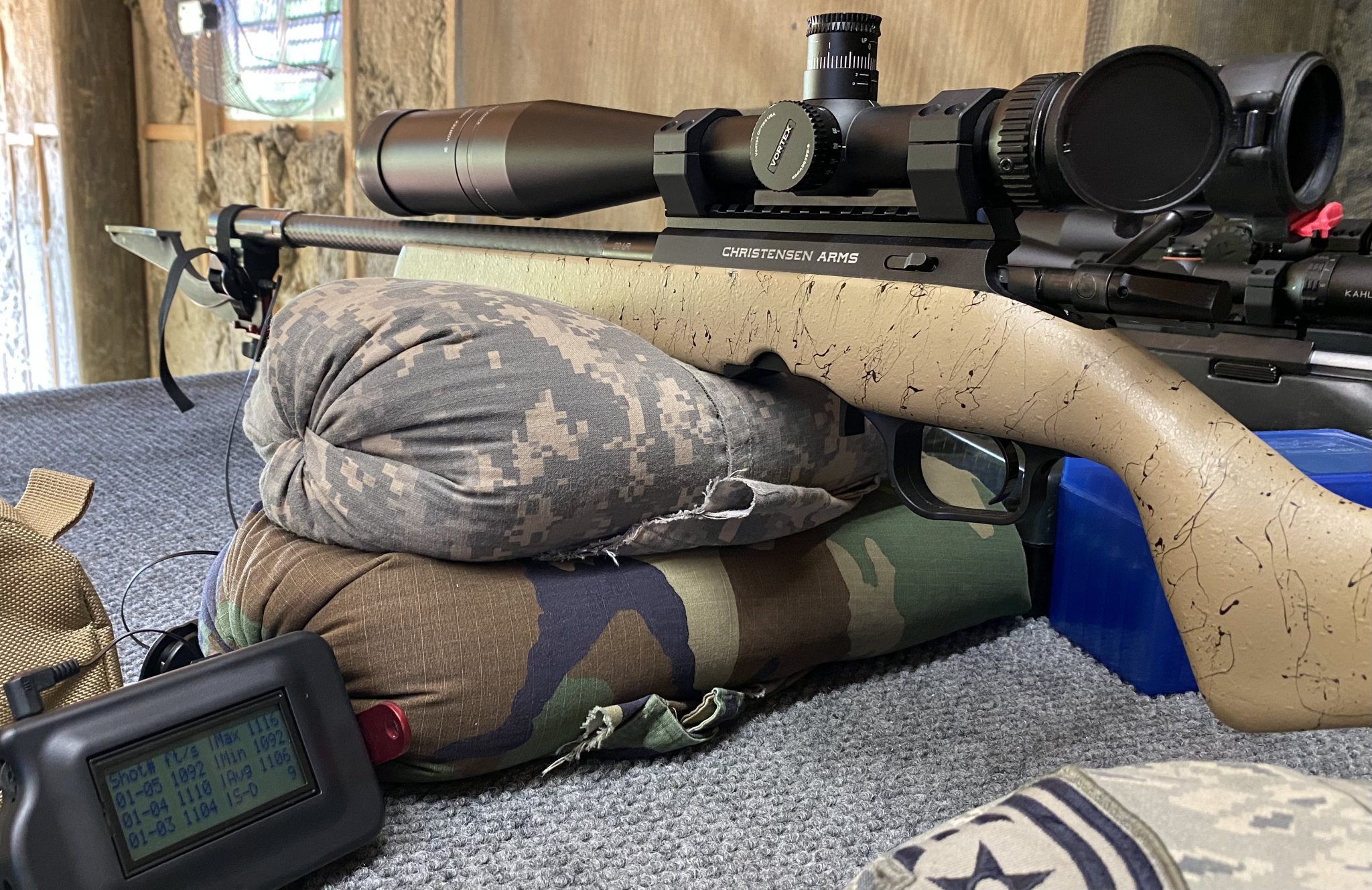

I do get a couple dropouts/fliers every now and then with CCI SV, but for the price compared to the high-dollar shit, I just can't justify the "good stuff". Especially when my Ranger 22 is shooting sub-MOA at 100 and 200, and regularly puts down 0.3xx" to 0.5xx" groups at 100 with it.

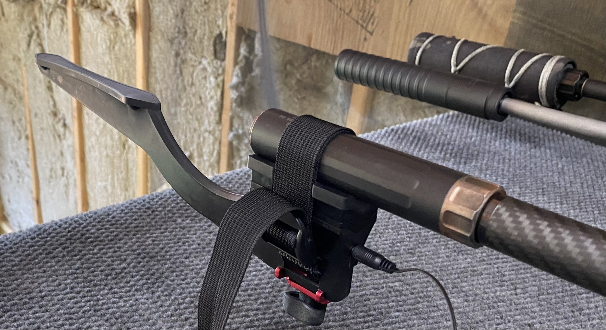

Here's a 7-shot string with CCI SV in my Ranger showing the ES and SD... Pretty good for bulk plinking ammo, IMO...
