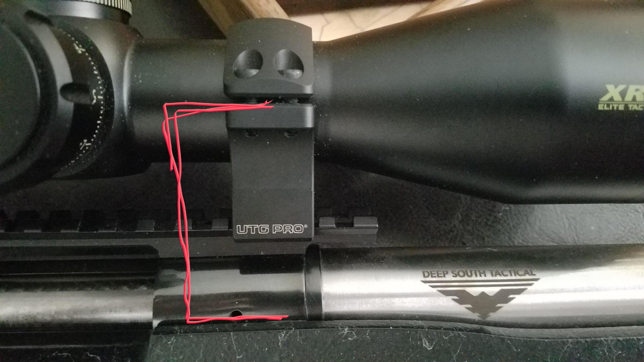

If you hate math, there's always this option.
Measure from the center of your ring gap to the vent hole if it's a Remington action.
That's your number.
And yes, those are UTG rings and they are fantastic for under $60.
They belong to this rifle.
Close enough is close enough.
