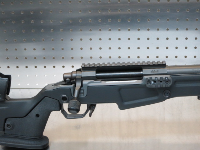

at the very least, Melonite the bolt, lightly Cerakote the interior of the action.
My smith (Bugholes) turned down my bolt on my 1st Deviant prior to cerakote and it worked just fine.
2nd Deviant, cerakoted the action and the bolt and it bound up, this one was not turned down.
You will not find a slicker coating or treatment then Meloniting. My Deviant Alpha 11 is nasty slick with a little TW2500 oil on it.
If just have to have a coating, I vote melonite the bolt only and Micro-slick coat the action. The bake on micro slick is black so as far as aesthetics the bolt and body will closely match.

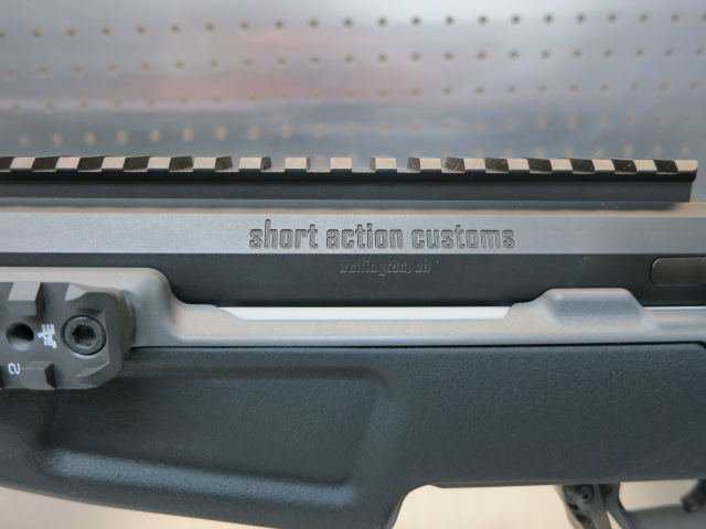

I also suggest looking into the Short Action Customs LBC mod.
