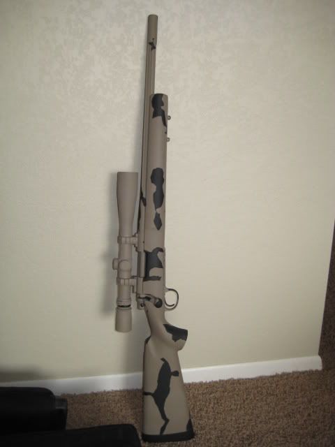

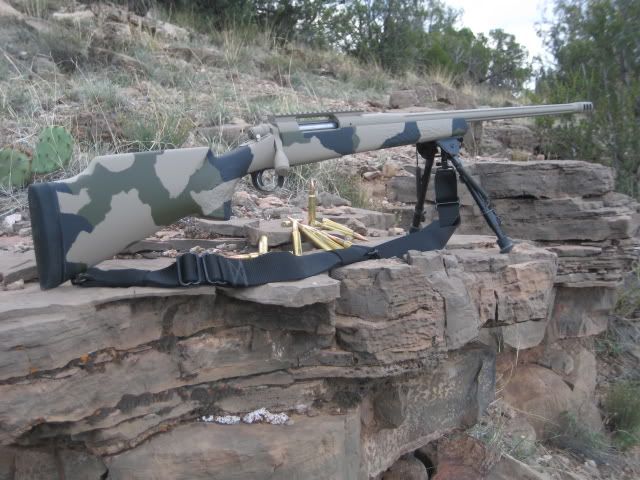

Here are a few examples of stocks/rifles that I coated using "C" series (air cure) Cerakote.
I used blue tape to make my stencil patterns.
I understand wanting to use product on hand, but Cerakote may not be the best way to go with stock work. I would suggest looking into polane.
