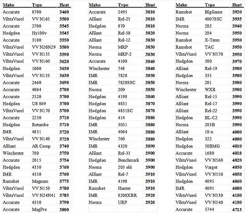

I'm starting to develop some loads for my .204 Ruger, and one of the recommended powders is CFE 223. However, I recall sometime back reading something (on the Internet, so you know it's true) about CFE powders shortening barrel life. However, as I consult the Oracle (Google), I can't seem to find anything... does anyone know what I'm talking about, or am I babbling to myself?
At this point I have some loads built to try using BL-C(2) and IMR 8208, using both Sierra 39 gr and Hornady 40 gr projectiles... but I'm also thinking of putting together some rounds using CFE 223.
