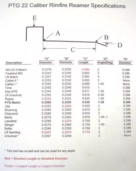

It seems to me that someone a few months ago here on this forum published a chart of various .22lr chamber types, and their dimensional size. You might try a forum search or perhaps someone will be kind enough to repost it for you. I'm thinking it was a our forum member @littlepod who posted the chart but not willing to put money on that.

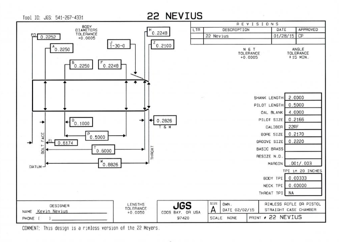

I don't have any hands on experience to draw upon for this particular chamber, but word on the street is that it was designed specifically for the Lapua family of ammo. It's called the "Nevius" chamber. I've included a drawing of it's published dimensions.

Thank you SanginSpecial. I think I will start comparing chamber drawings, not that I will be able to tell their effect on a bullet. I am thiking about a Bartlein Barrel and they generally put a Bentz chamber in. My funds are not unlimited so I want to do it right the first time.

Here is a chart of probably the most common chamber dimensions:
Your CZ 457 (and my CZ455) probably has an "LR Sporting" chamber. Notice the "sporting" has the largest chamber dimensions fitting a general purpose rimfire, meaning it'll shoot all the various .22 ammo produce with "acceptable accuracy," (whatever that means). You mentioned a Bentz chamber. It's my understanding that that chamber was developed to improve the accuracy for semi auto rimfires, while still being large enough to allow for reliable functioning. The rest of the chamberings listed are what I would consider to be "match chambers" for bolt action rifles. I have a Winchester model 52 and I assume it's chamber matches the dimensions of the Win 52 D Match as listed. Notice this has the shortest chamber of those listed. When I chamber a round, the rifling lightly engraves pretty much all of the driving bands of the bullet. This centers and supports the bullet in the chamber, and to me, that's what what I'm looking for in a match chamber.

I don't have any hands on experience to draw upon for this particular chamber, but word on the street is that it was designed specifically for the Lapua family of ammo. It's called the "Nevius" chamber. I've included a drawing of it's published dimensions.View attachment 7372641
FYI, the chamber was developed by Kevin Nevius who is a sponsored Lspua shooter for both centerfire and rimfire disciplines. It is an excellent chamber for Lapua products.

Thank you. At this point I may wind up with a Bartlein Match chamber. Bartlein has reamers for a Bentz, SAAMI Match and their own match reamer. It seems like the Bartlein will be the tightest and closest to the Nevius.
