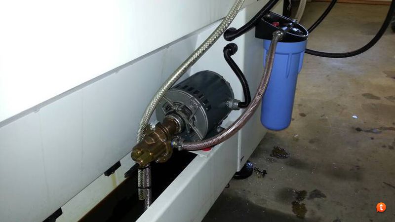

Ebay is your friend, search for carbonator gear pump, shertech gear pump, then start looking at the related results. I got mine for $125 I think. You just need to make sure its a gear pump not a vane pump. 1/3 and above HP will work fine.

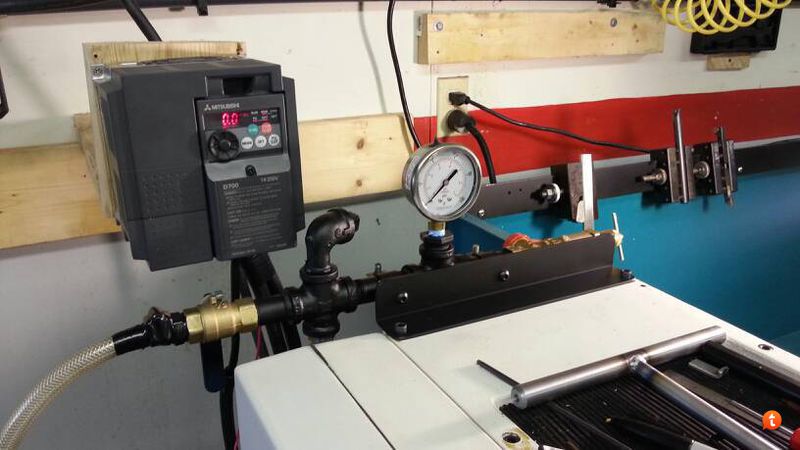

Just get the stuff that has braided fiber in it, from any hardware store, 3/8id. Youll want to make a manifold out of 1/2npt, inlet and valved outlet at one end, pressure gauge tee'd in, then the bypass relief valve at the other end. Can use same 3/8 hose for the bypass line returning to your sump.

I'm assuming any oil filled gauge within the proper range would work?
Yep, nothing special, Im just using a 100psi and interpolating where Im at over that haha. My pump will make 125psi, and I regularly go upwards of that, but its not like knowing the pressure down to the 1psi really matters very much.

Yeah, 1/8npt. Like I said above, I don't bother doing it with the lathe, just use a cordless drill right how it's pictured there (before dialing in so I don't mess that up). Takes 30 seconds total.
Buddy had an oil filter explode on his flush system, he now uses the one I have pictured. Amazon for that one, 5 micron poly spun.
I went and looked. Water filters came up. What would you call that? They make hydralic ones- those are big $$$$$$
It is just a water filter, pentek or something. It's the 10x2" I think, the smaller of the two sizes they sell. They're good to 140psi or so.

This is my pump: http://www.pumpvendor.com/media/oberdorfer/Oberdorfer_N992_series.pdf

My last question, does the filter go upstream from the pump? I've read this. It seems counterintuitive, however, it would be protected from pressure spikes there...
I put mine on the pressure side, yeah it doesn't protect the pump from sucking stuff up, but it protects from pumping shit into a barrel, especially if the pump were to grenade and pump parts of it into a barrel.
I did make a strainer for the pump inlet, basically took a 3/4 pvc tee, the straight sides of it have garden hose filter screens captured by short chunks of pvc. That way it can suck from either side of the tee should one clog. I'm not really worried about any big chips in the sump, as all the drain holes have magnets below them.
