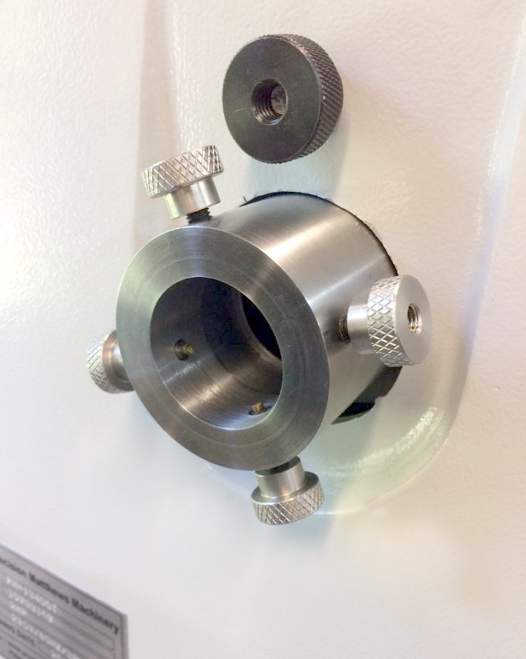

Did you make a spider for your 1340?

7113363
Yes, 1/4-28 set screws with brass insert. Had to slightly enlarge the spindle hole in the gear cover.

I need to bite the bullet and get a spider made. I’m using Viper’s Jig. It works, but I know the spider would be better.
Is that a friction fit?
-David
-David
No, there are three set screws (also brass tipped). Not much torque is transmitted to the spider, but I didn't want to have to fight it if I needed it removed. I made a few minor changes, but here's the design I worked from.
Looking at the layout, i saw David Best names in the corner. I’ve known him from years ago in the woodworking world. He is an amazing innovator.

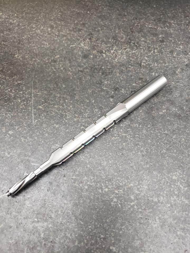

To the OP:
I ran into this very kind of stuff almost a decade ago. It's what compelled to me to pursue a different path.
First, create the problem statement: Shits in the way and it doesn't want to move out of the way.
Why?:
1. Chip gullets are small and not very deep.
2. Poor fluid exchange due to a pilot that basically behaves like a wine cork.
3. Chip formation is a combination of strings and coffee grounds, they pack in like a snow drift and don't want to move.
Solutions I found:
1. Reduce the flute count. This makes room for chips to run through. -A bigger drainage ditch...
2. Shitcan the conventional pilots and run a fluted one. Fluid exchange is everything. HSS tooling doesn't support this very well due to the retention screw using up all the available real estate.
3. Add staggered chip breakers to the tool so that you break up the stuff into a manageable size.
I once reached out to JGS. I was told by someone that this was not possible and the tone suggested I was just being another DB gun queer. Little did they know I've been having my tools made this way for about 7 years now.
It's a 48 second cycle time to chamber a 6.5mm Creedmoor. That's with .400" pecks. A 338 Lapua is just under 3 minutes. 600rpm/.004"/rev feed.
No shit.

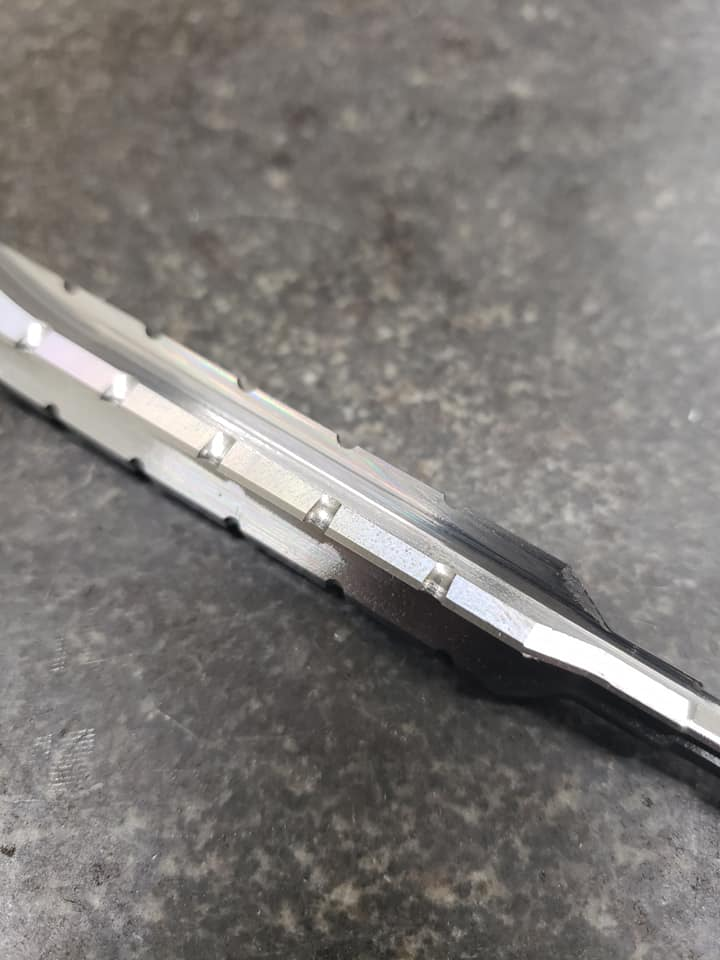

LRI now has its own line of reamers. Its in its conception right now, but we have successfully made our first. A little 20 caliber version of the 6mm XC that one of the staff wanted to play with. I ran that tool like I stole it in one of our K&P brand barrel blanks. Roughly 40 seconds and it was done. Finished it with green scotchbrite.
Don't let a staggered chip breaker fool you. It has zero negative effect on surface finish. I have close to $30k in tooling done exactly like this.
C.

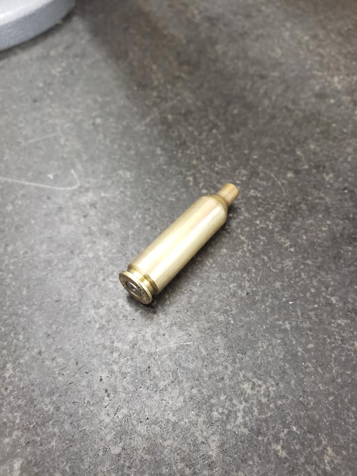

1st fired case:
7113973
C.
That is awesome. JGS slotted the screw that sits ahead of the pilot, but that’s it. What you’re doing makes sense.
1st fired case:
C.
