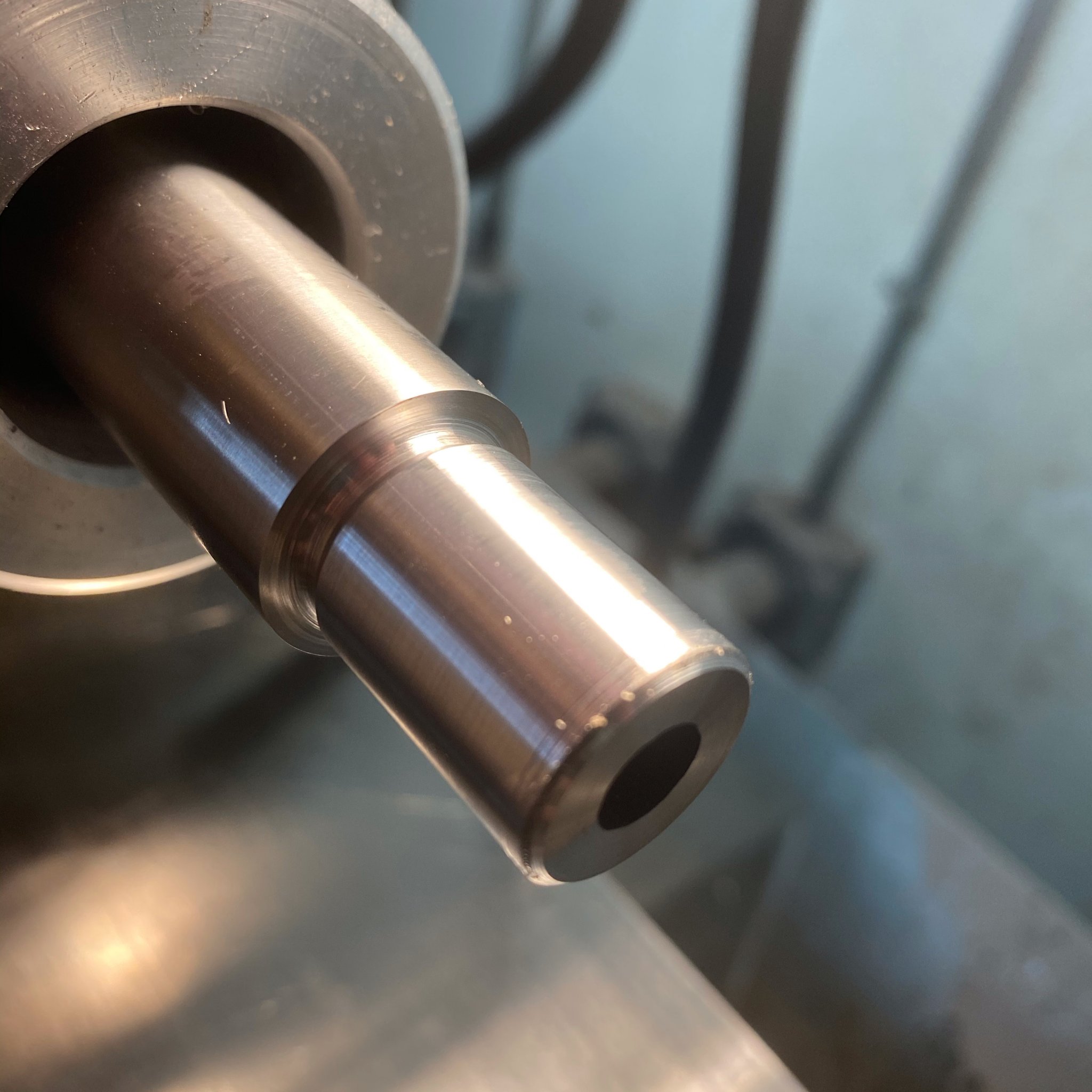

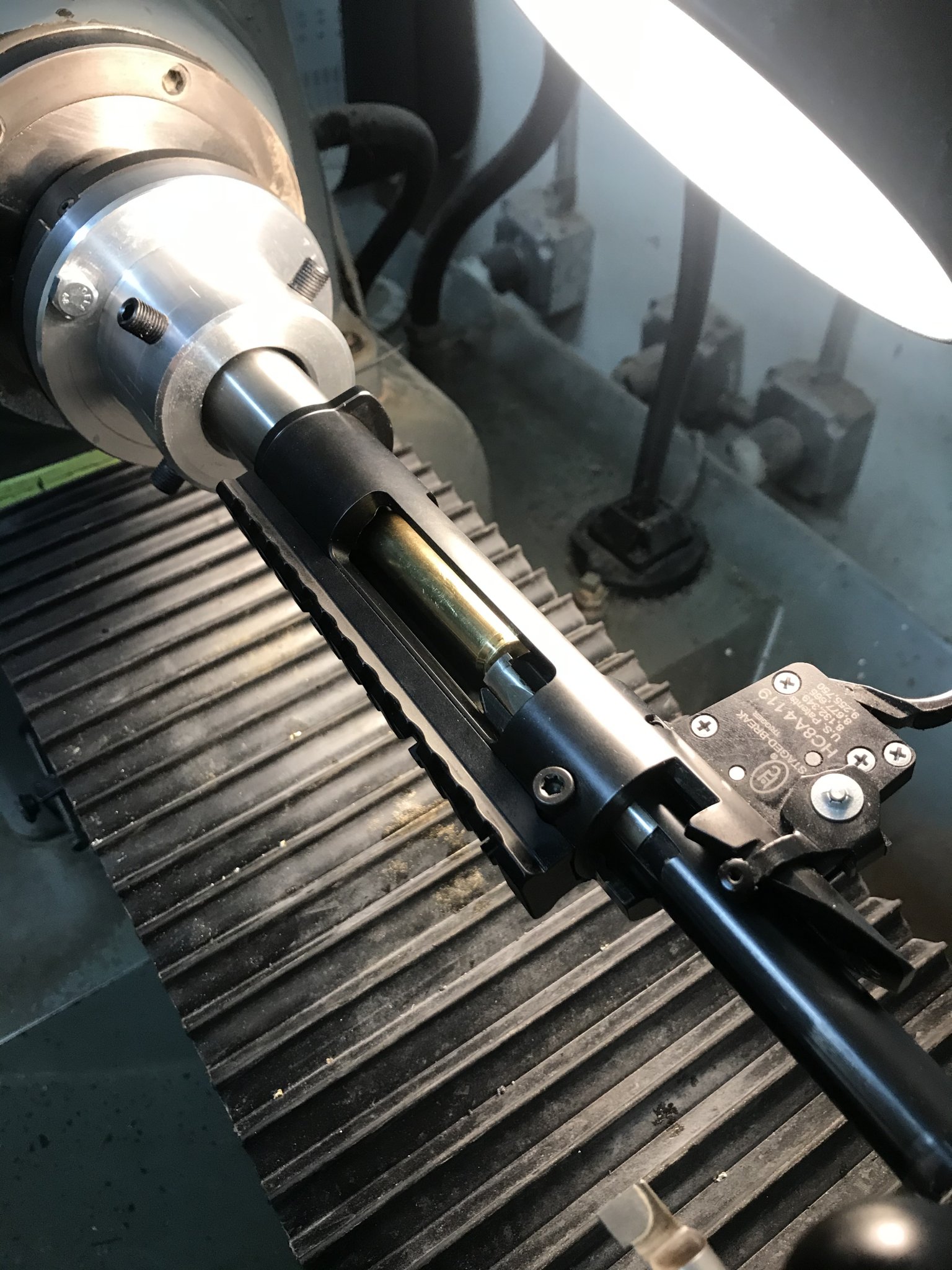

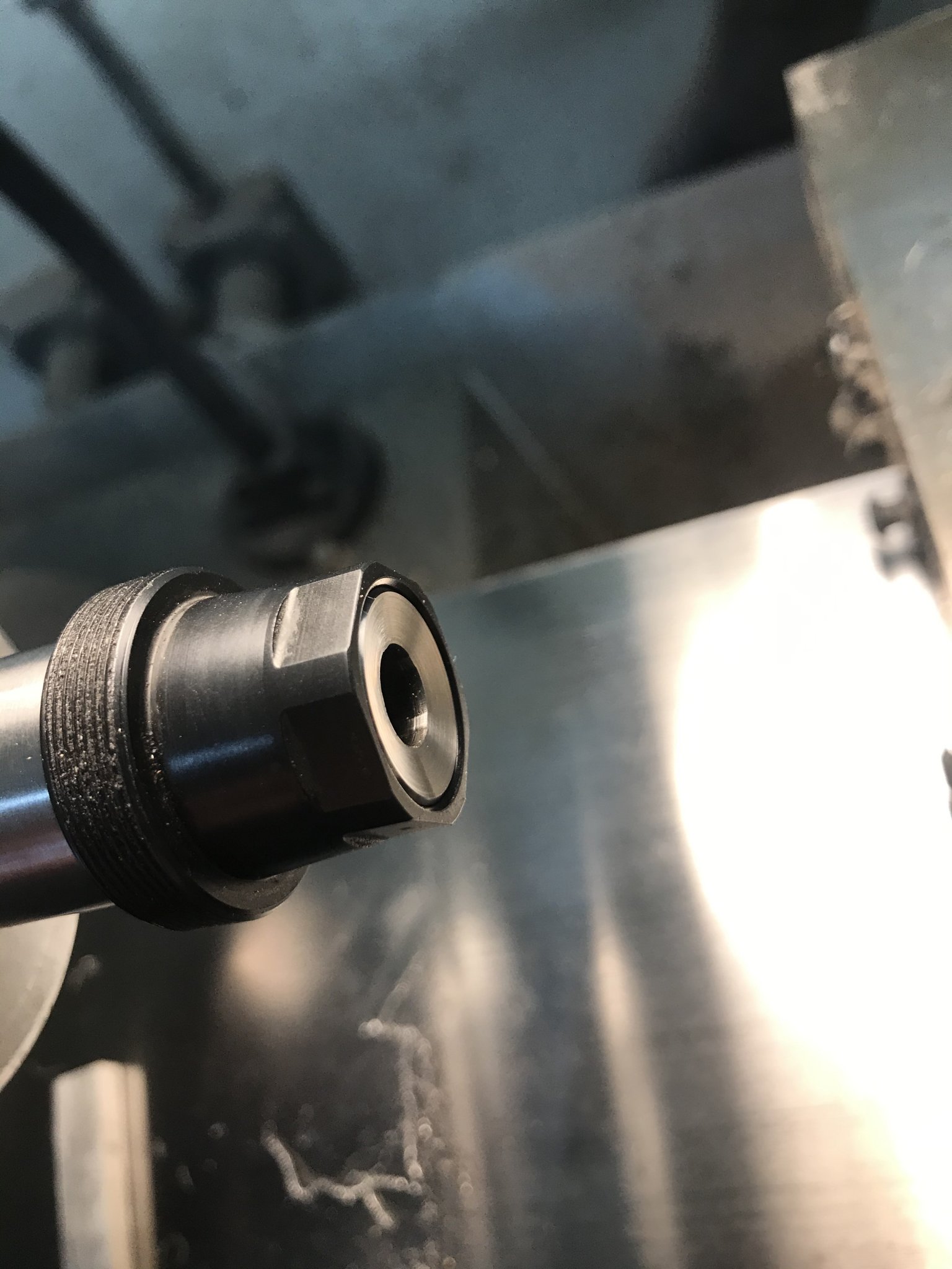

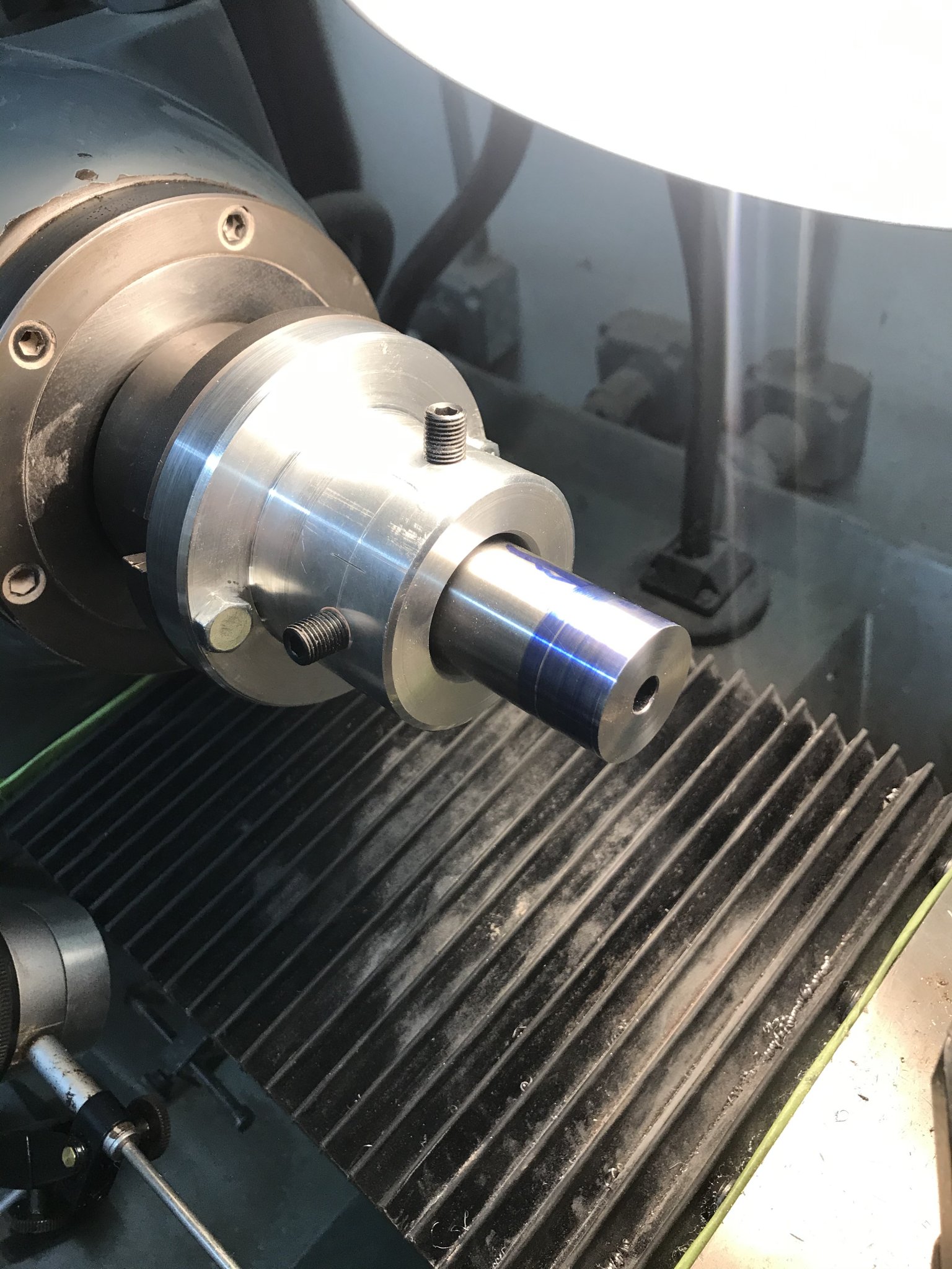

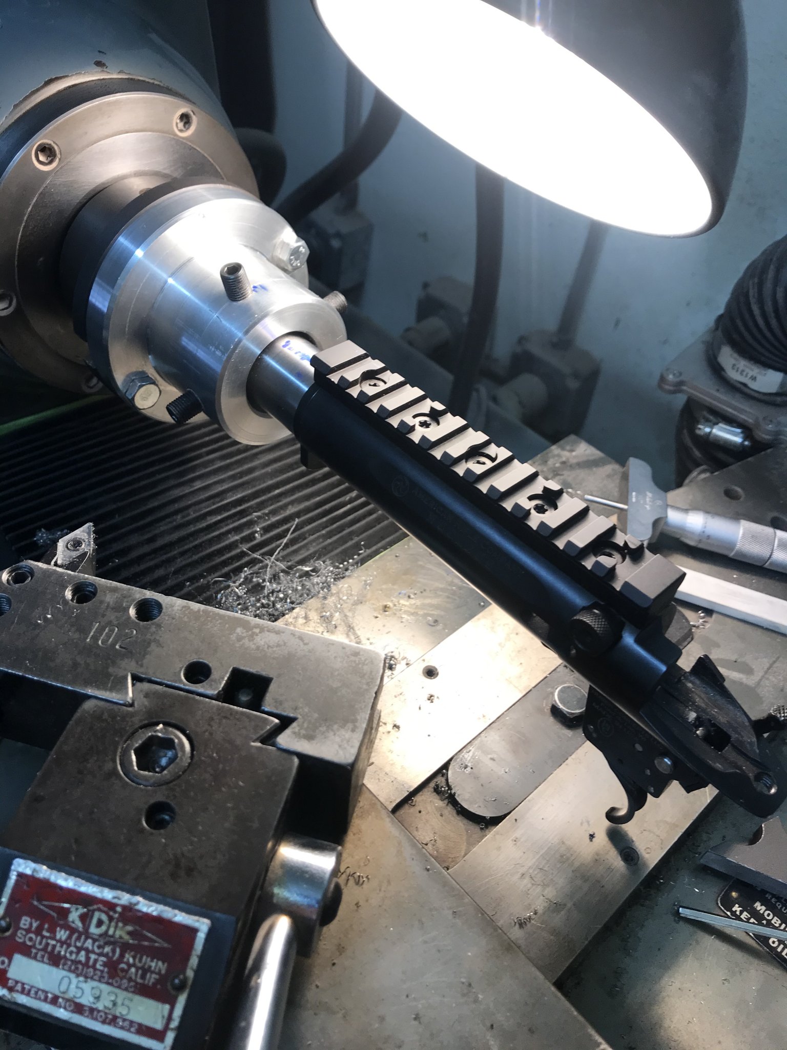

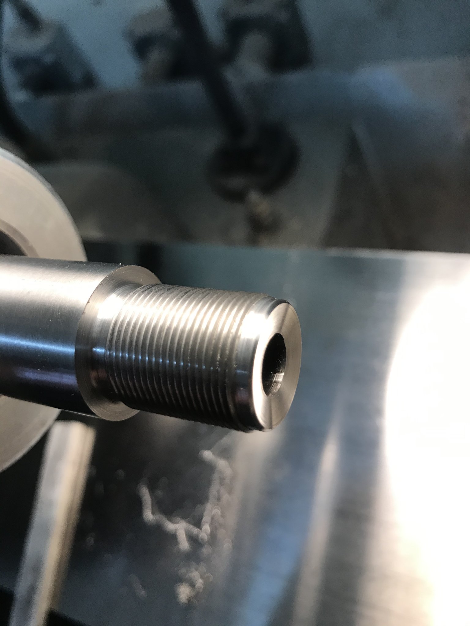

I cut barrels for myself, as I don't want to wait for someone else to do it. It's not crazy, if you can run a lathe, have access and time. I have made some terrible threads that shot fine. Understand it is possible you fuck up a nice barrel. So far I have not had an issue.
Nice to start with an ARC action or someone who gives you tennon prints. Seems to be indicating your bore and making sure your work is concentric to the bore is paramount.

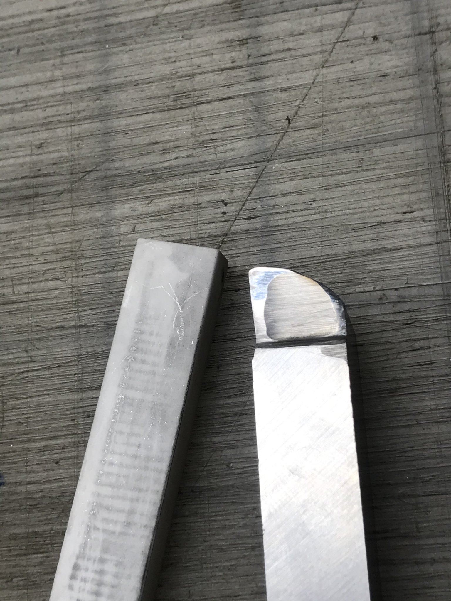

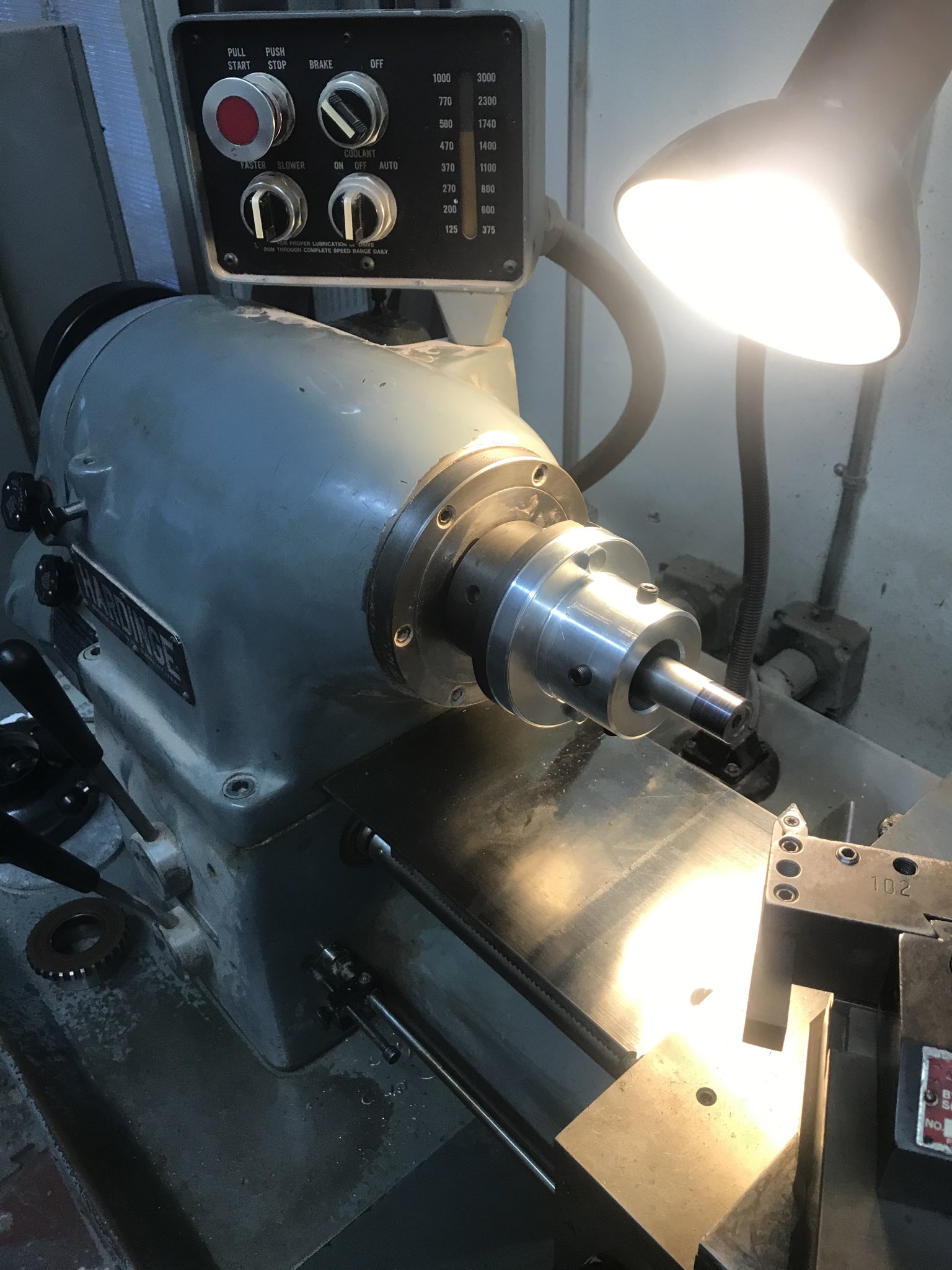

I’m using carbide Er16 lay down threading inserts so to get a decent finish you have to run it pretty fast.
I ran at 1100 rpm this time and it came out really well.
Thankfully the way this hardinge lathe runs threads it’s super easy and not stressful at all.
I could thread at 2000 comfortably if I wanted to.
I’ll video the next set of threads I cut because it’s kinda neat how this lathe operates.
