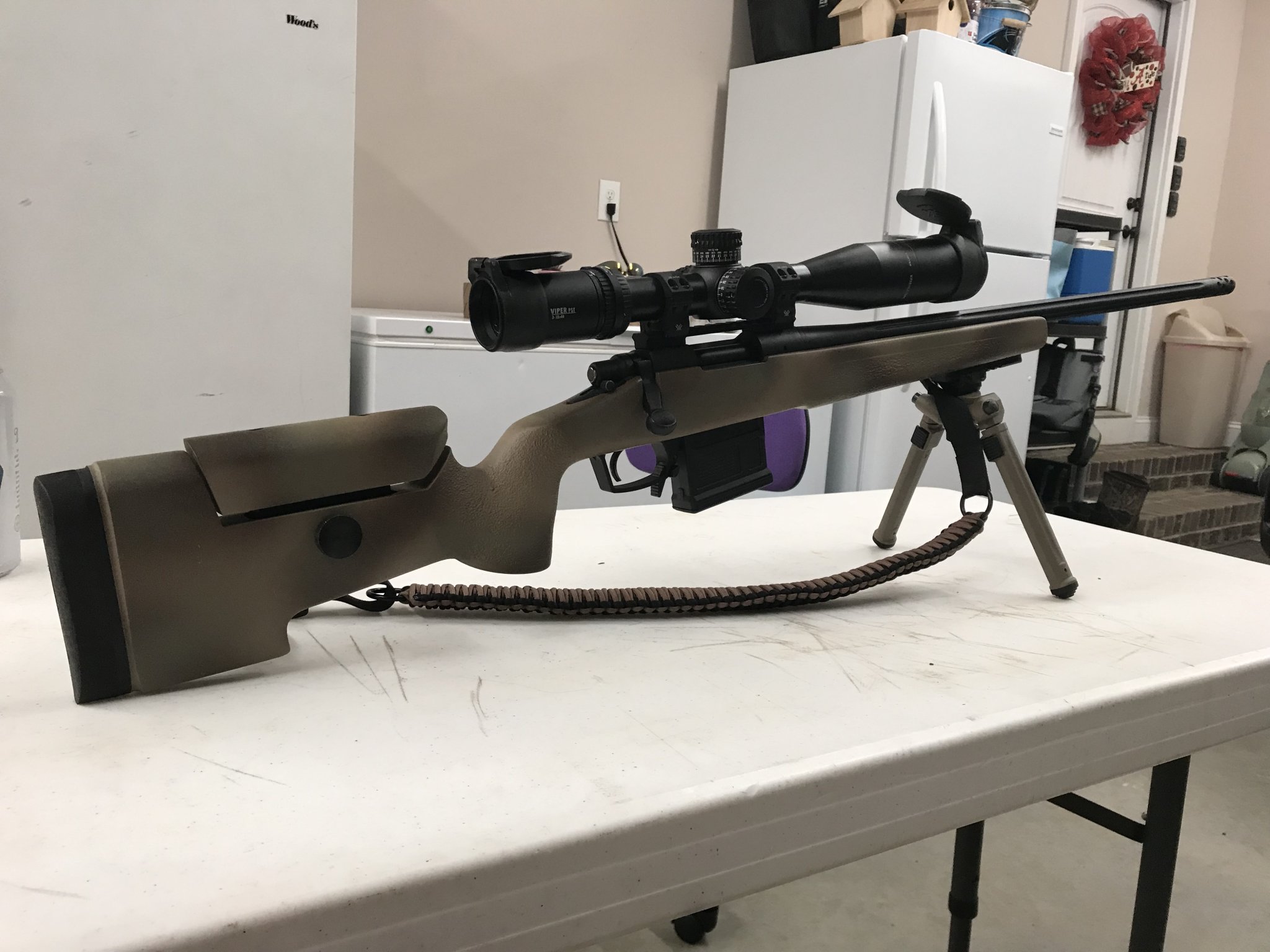

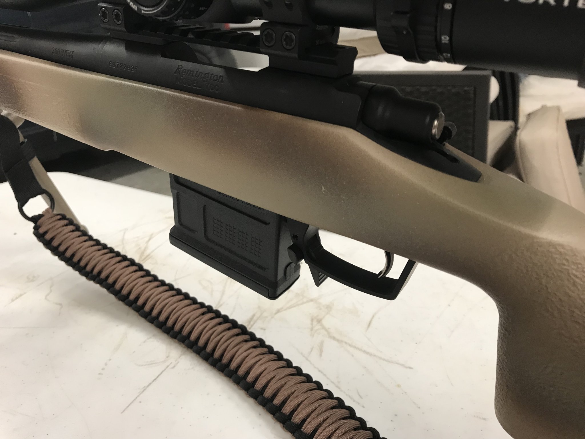

My 300 WSM, very mild custom, R700 action which was originally a 270 WSM. Barreled with a 300 Imperial barrel that was gifted to me and a new to me Mcmillan A3-5 stock and SOL M5 DBM. Currently using magpul mags which only hold 4 but still do the job for now. It’s a hunting set up for me. Touching holes at 100 with 180 gr. Fusions and same results at 200 with 165’s. Never really had a need to work up loads as I don’t currently reload. Absolutely love this set up for a very mild budget build
