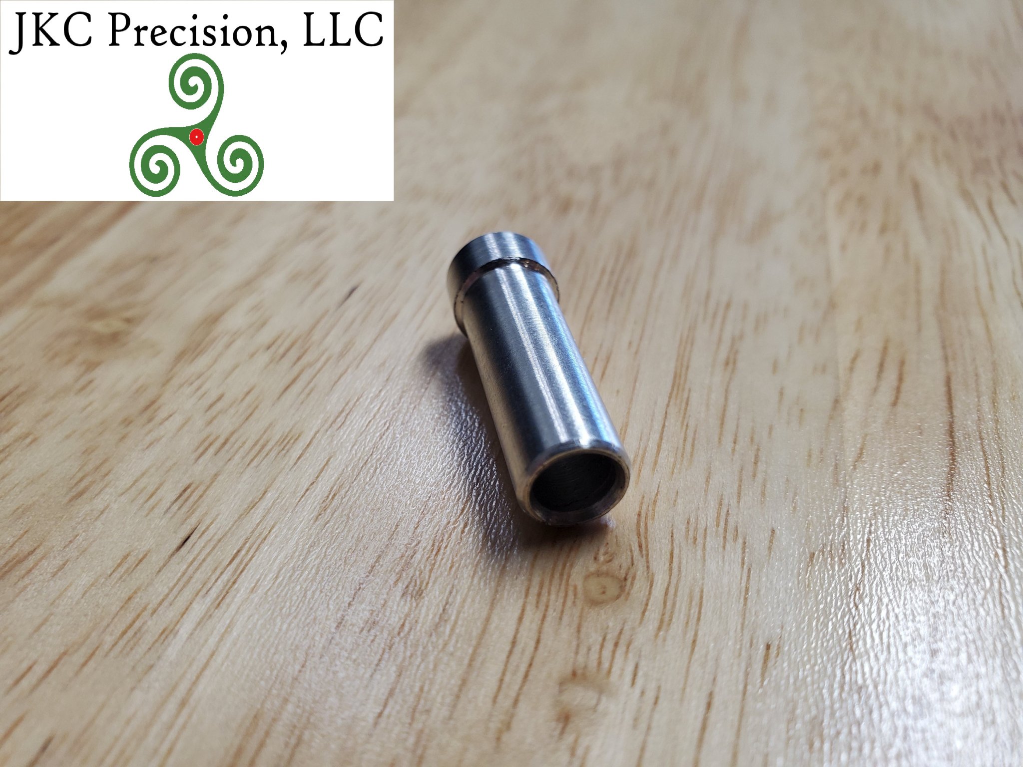

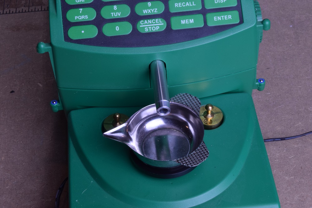

    1. Use an insert/reducer. If you do nothing else I suggest, use a reducer. I prefer the JKC Precision Insert made by my good friend @SgtJKM . The threads on the inside of the dispensing tube on the Chargemaster 1500 and the overall volume can lead to over-charges, especially when using extruded powder. Using an insert/reducer can really help with this issue. A fastfood straw can help, but I prefer something a little more permanent/nicer, plus I've had better results with the JKC Precision Insert.

    Interesting post. FWIW my friend runs a piece of shrink wrap outside the dispenser tube. Yes, it's an expander vs a restrictor. In my use with this machine dropping Varget I have found it too be very accurate. On about 25 drops only a couple were barely over when confirmed on a beam scale.
