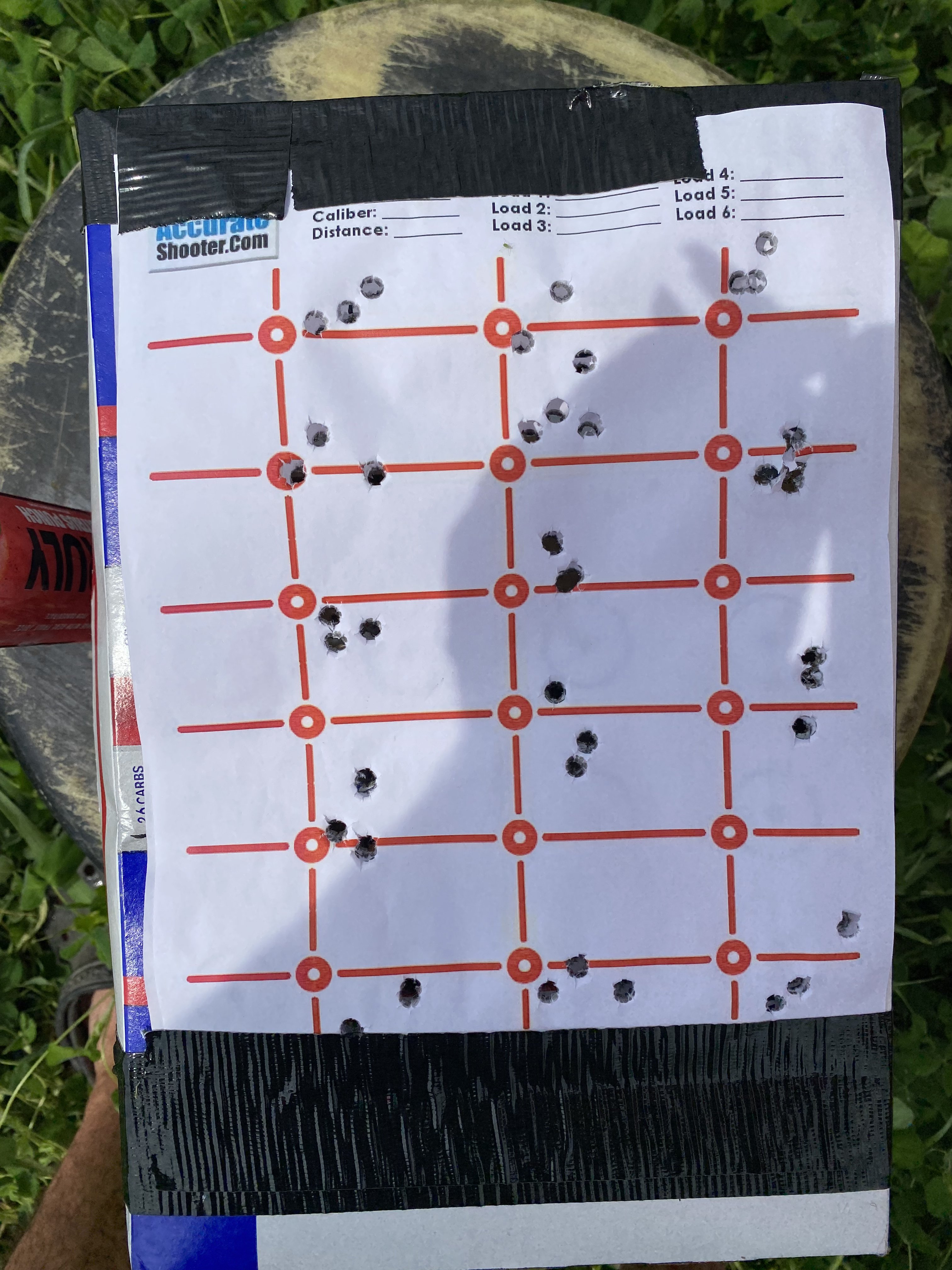

I just put together a new gun chambered in 6.5 creedmoor with some pretty decent parts. I’ll post a few pictures.
This is my first gun on a custom action and I cannot get it to shoot ANY factory ammo. I know this isn’t a huge list of ammo but some of it is high quality and I’d expect it to shoot. All of this is shooting 1 moa at best with most of it over 1 moa. I tried some hand loads I had from an older 6.5 and they also shot poorly but my SD was a 3.8 so maybe there’s hope with the hand loads.

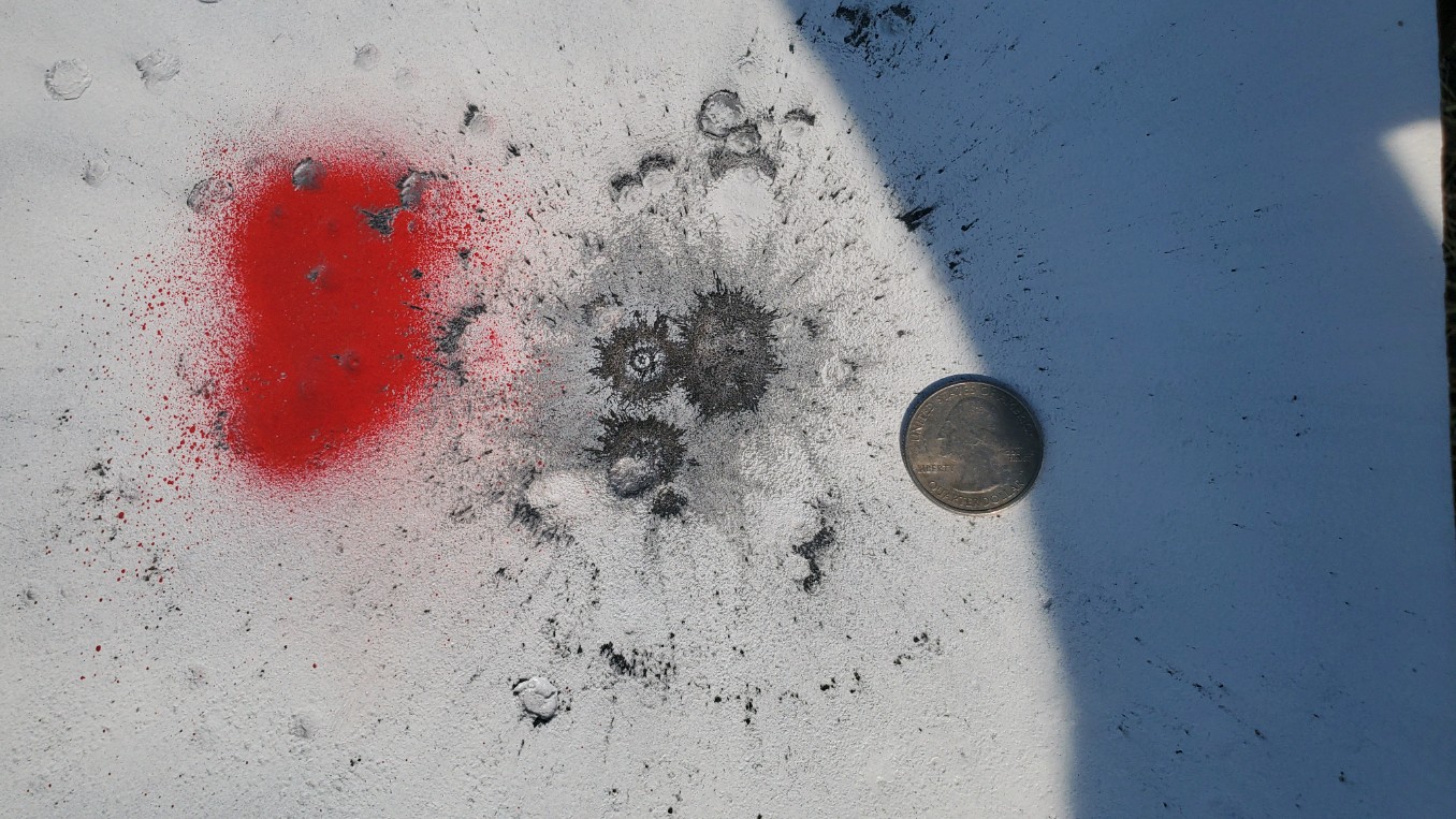

From today, there’s a few .5 groups in there but they’re not consistent. Have tried shooting with and without suppressor, even put the gun in a MPA BA chassis still shoots like crap. Have double checked everything. I’ve gotten frustrated again so gun is going back in the safe and I’m having a 🍺
I haven’t swapped scopes yet that’ll be my next move then a call to proof.
I’ve worked up charges from 40.5 to 42 grains with h4350 and 140 grain ELDMS and Berger hybrid targets. I feel like I’m just wasting components at this point. Everything is 20 thou off lands
Try jumping them more. Berger hybrids like alot of jump. .030 to .100 jump.
If your SD is that low, tune with the seating depths. All the components you have are proven to work well in the CM. I personally shoot 42.5gr H4350 with the 140ELDMs at 2800ish. TBH, some of those groups aren't bad. Just tune with seating depth and you should be fine.

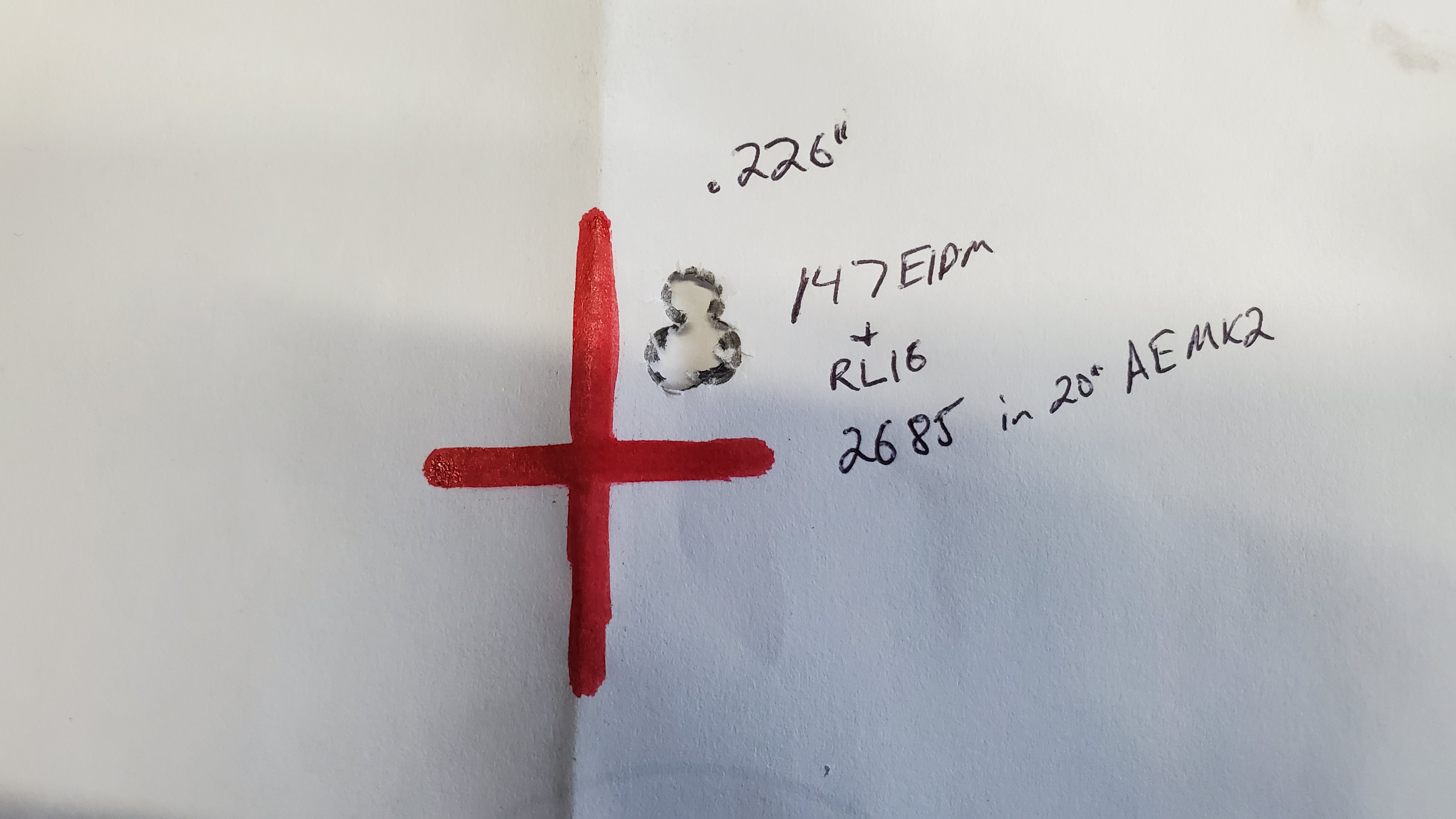

I've got a 26" med palma bart 6.5creed that it's money load is 140eldm@2885. It's warm for sure, but no pressure signs in lapua brass in a badger action. It shot ok at slower speeds but really woke up when I got into higher node.

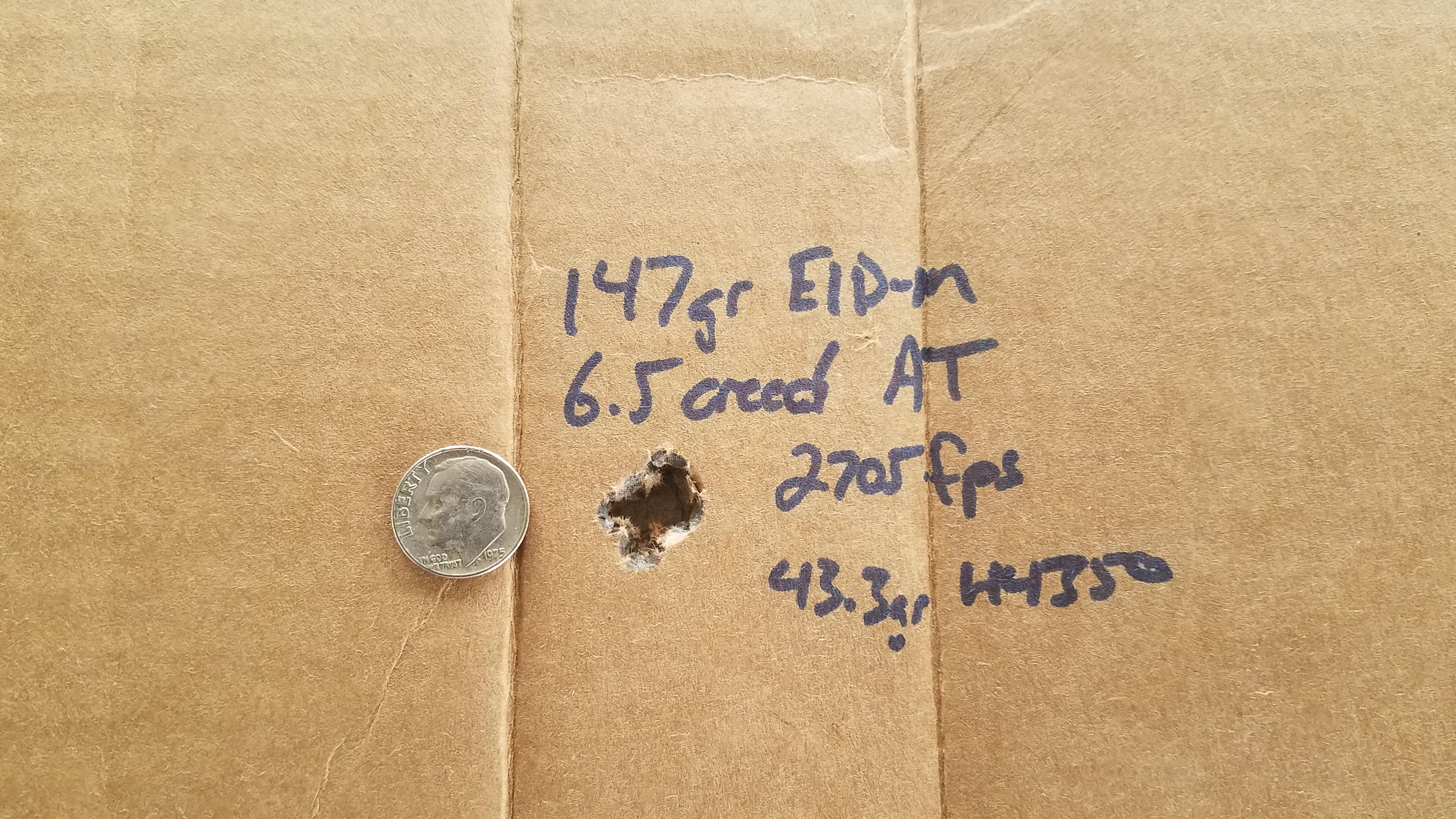

Oof!! 43.3 of h4350 and a 147 eldm in Lapua brass is a tad stiff (ie, pushing well above sammi pressure max )

He is right that is pretty stiff. Get that chamber wet or dirty and you could start running into some serious issues. I don't run more than. 41gr of h4350 loaded long to like 2.925 in any of my 6.5 guns. Keep pressure down to be able to shoot in any conditions safely and reliabiliy.

I'll keep it in mind, but I've shot that load in blowing dust storms, rain and freezing rain. It's been nothing but we'll mannered. If I was getting loose primers at 3 or 4 firings, ok, but it's just been plugging along. Also as far as predictable, it's been used on nuisance permit deers at distances I don't really want to say in public. First rd hits were never a problem.
With 42gn of 4350 I’m at 2830fps no pressure signs and my SD is a 3 but not shooting well. I feel like anything 2800+ is asking a lot of the 6.5 CM. I can push further but I’ve got to be close to pressure
