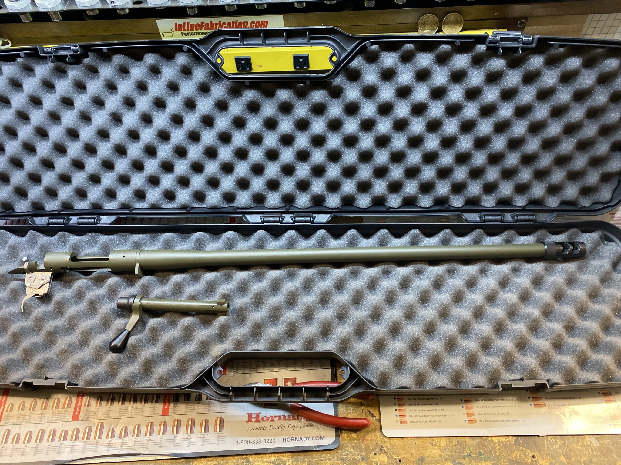

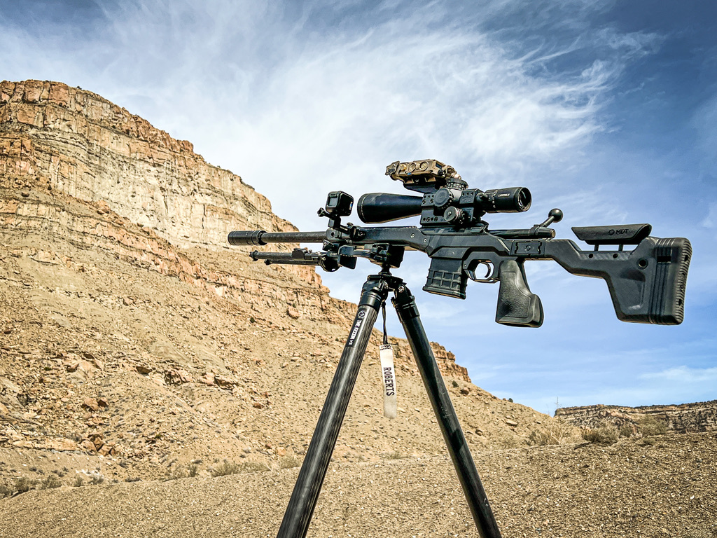

    To prove my Point I am gonna focus on Chris Robert's Rifle here in this picture
    That ^^^^ My Friends is a brand new 224 Valkyrie. Now ask yourself, who in 2022 is dumb enough to build a Valkyrie ? I fully admit that when I my Daughter's kids grow up, there probably wont be a 224V on the shelf. If there is, it's will some bargain bin, 75gr American Eagle leftover that nobody wants but the nostalgic.
    I mean, I just showed you a custom made 224V/6.8 bolt head I have for an Accuracy International. Why on Earth would I waste my time on custom 224V build for an AI rifle - Dumb.
    But this weekend, I again saw excellence....
    I saw Chris take a shooter who was excited to shoot a target at 264 yards get a 1st round hit at 1200... 1200 yards, with this rifle.
    Speed wins, Speed Kills, Speed is our friend... What is the best way to get speed, reduce the weight of the bullet, and it doesn't have to be a lot in the context of our shooting.
    We are talking, we are comparing notes, we even spoke to people like Federal trying "relaunch" the Valkyrie with a new understanding of the round and our success in a bolt action rifle. None of the struggles and all of the hype, seriously. Won't happen, but it's fun to talk.
    Even the bad ammo, works in our bolt guns.

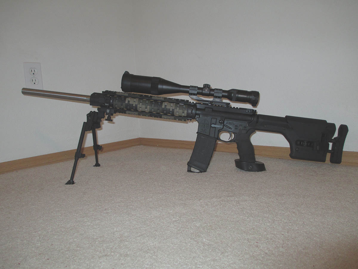

    About 15 years ago or so ??
    I took a 223 and straightened the case walls, blew it out, sharpened the shoulder angle, and shortened the neck.
    I made my own chamber reamer out of O1 steel.
    It's not a Valk, it's not a AI....it's just a bit different but still in the same ballpark....kinda....sorta.
    Chunk it in a Lilja 24" 1:8 twisty and see what happens.
    Ain't gonna post powder and weights because some fool will try to replicate it and see how much shrapnel his face can consume.
    I toss 90 Bergers with it.
    It will reach way out there.

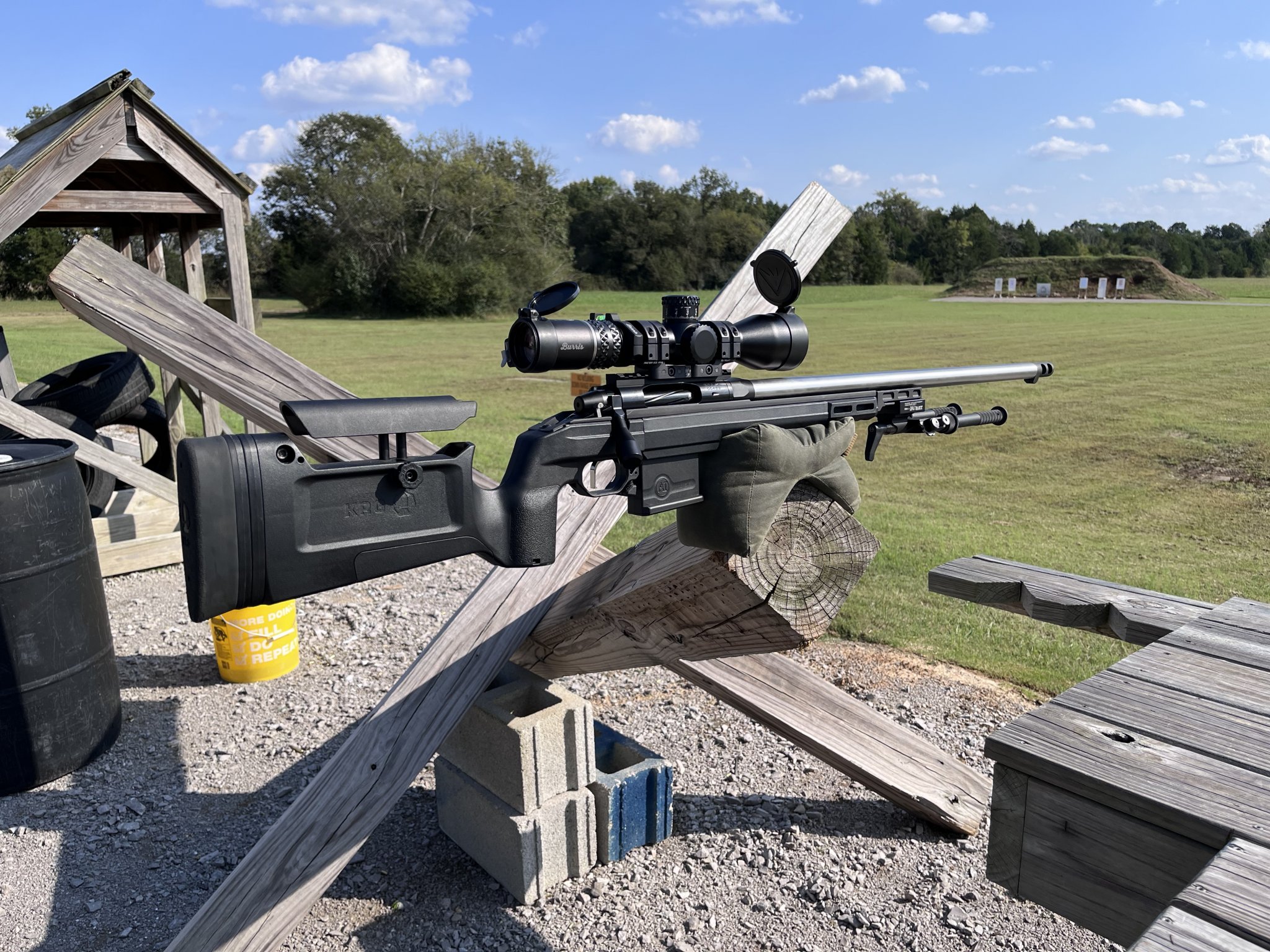

    Watching to see some numbers from the 6.5cm guys. I stuck with 130s, and sometimes wonder if I should bump up to 140. Most of my shooting is 610y and under, so I’m not sure if I would benefit from the 140s from my understanding.
    I shot my 130 otm to 1200 at Arena with Chris Roberts just a few weeks ago. There's definitely something to be said for traveling light, and shooting lighter too. I know Chris likes the .224V, and given the success in the bolt gun world of the round, I am definitely considering it again. The 85.5 just looks ideal, but I'm not sure how different that is than my 223- with a 75gr bullet . I shoot it at pretty good speeds. I guess it's a little bit of a step up in speed and "normal" bullet weights.....
    At any rate, the 224V is a cool round for a bolt.
    So what does all this mean.... Absolutely nothing.
    it means we are having fun, having success with a dead cartridge, but the caliber is alive and well which is all we need. Pushing a .22 caliber bullet at 2750fps to 2900fps lets us play around on the cheap. This stuff costs nothing to try.... if we can finesse, fine tune, enable a neat little pet load that works for the group... boom. Maybe it's an 80gr load, maybe it's 85.5gr, 90gr, we don't know where it takes us.

    26" barrel, .204, factory ammo, extremely flat shooting
    1. 32g Hornady = 4225 fps
    2. 40g Hornady = 3900 fps and better wind drift. This is what I like to shoot.
    3. Cut barrel down 6" and lose ~180 fps
    4. I wonder how far out one could push .204 with reloads and really high BC bullets (that may not exist)?
    Faster twist 22-250 is interesting, but there is no heavier factory ammo, and I'm a factory ammo guy. Maybe 22 Creed (eventually) to the rescue?
    But the thing is seeing the hits within 200-500 yds, and .204 can do that. I don't think 22-250 can, & I don't know about 22 Creed.
