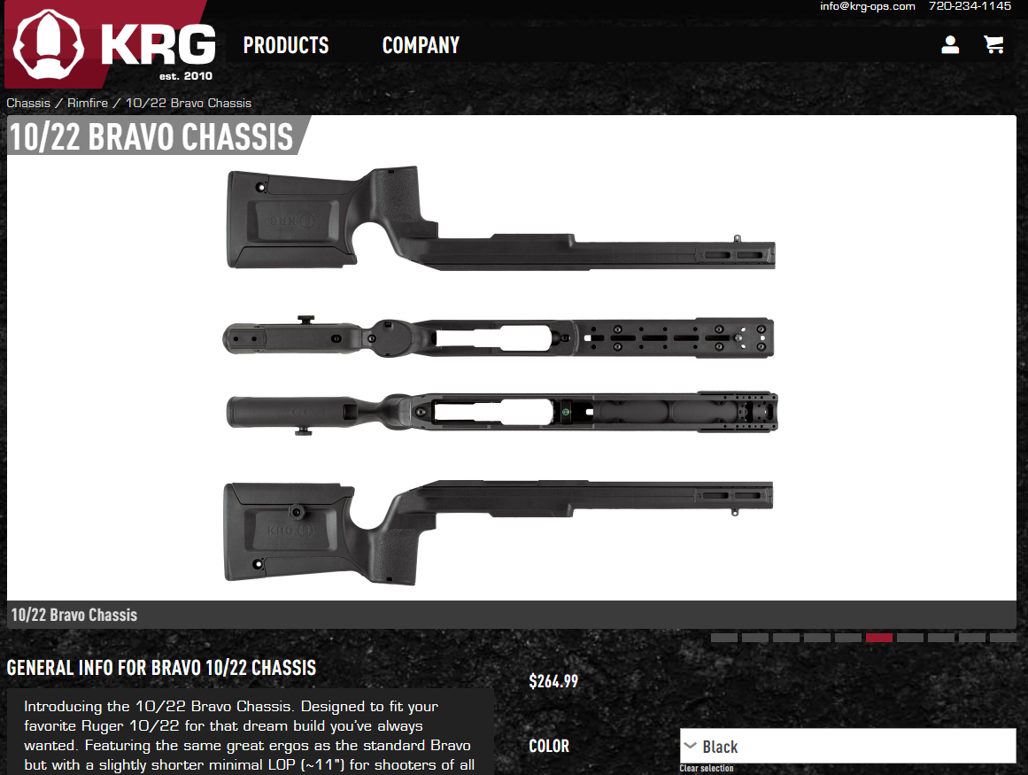

    This might work for you (I don't think it works with the Kidd Supergrade but will with the normal Kidd 10/22): https://kineticresearchgroup.com/product/1022bravo-chassis-rimfire/
    Reactions: RTH1800

    The bravo chassis sucks for the 10/22 imo. My action rocked in the chassis no matter what I did.
    Great centerfire chassis though.
    Reactions: RTH1800
    Agreed unless you have a Kidd Rear Tang installed. That's one of the reasons I went with the Oryx. The rear pinch system secures the action well. Also why I recommended looking at the Crazy Ivan chassis to @RTH1800. It has a rear set screw to secure the back of the action.

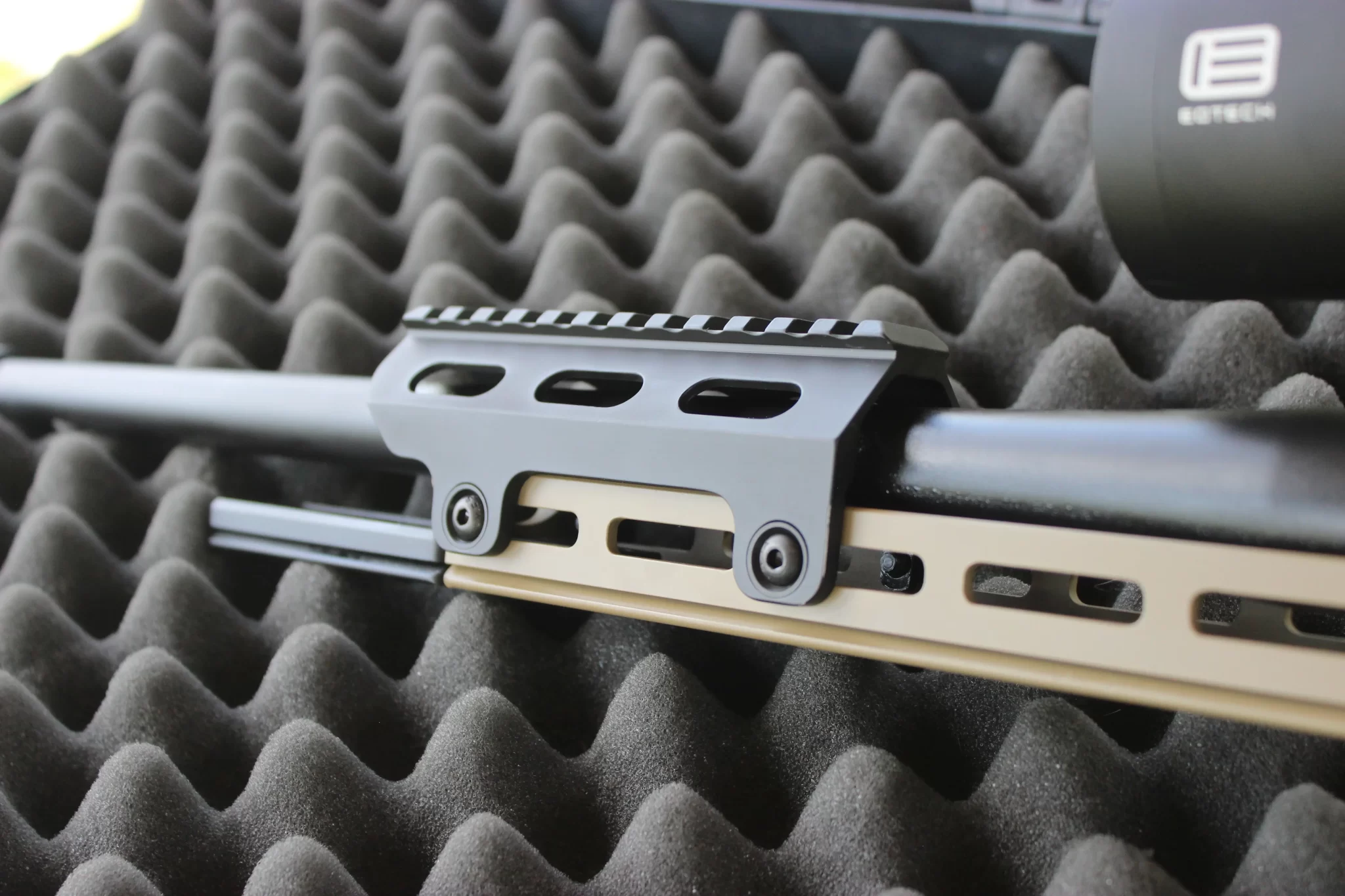

    I guess there is always the option of running a night vision bridge on another chassis, but I don't think the KRG Bravo has enough m-lok slots to get the rail far enough back for the clip on unit.
    The KRG night vision bridge is reversible so you will have plenty of room. You can't run any m-lock night vision hood on any chassis because all the widths are different. The stars would have to align for it to work out
    Oh, I didn't realize they made one that would fit the Bravo. But looks like they updated it a while back with the bolt holes on top for mounting one
    Looks like an excellent option in that case.

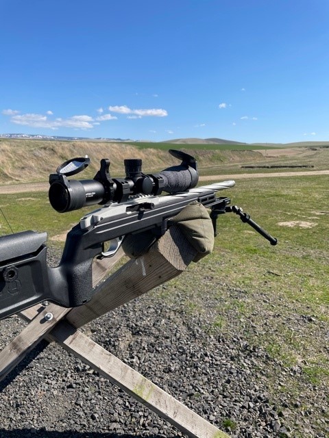

    Brey Birch La Chassis DLX. It has a rear setscrew for securing the rear of the action in the chassis so no rear tang is needed. M-Lok as well as Arca Rail. KIDD Supergrade shown.
    The XLR NV bridge is just slightly too wide to fit the grey birch. You can make it work if you squeeze it, but it's far from ideal.
