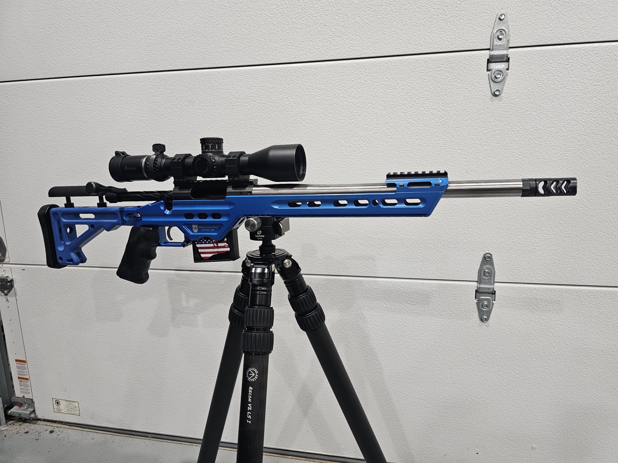

I built my daughters on a MDT LSS XL with the carbine attachment.
Worked well at age 10 (3 yrs ago now)
Used a Luth AR MBA 3 with adj cheek.
A decent option for the buttstock now would be the Magpul DT PR with a cheek riser (what she has on her AR).
She loves the chassis and grip (MDT adjustable) and while she could go with something else, she really likes it.
