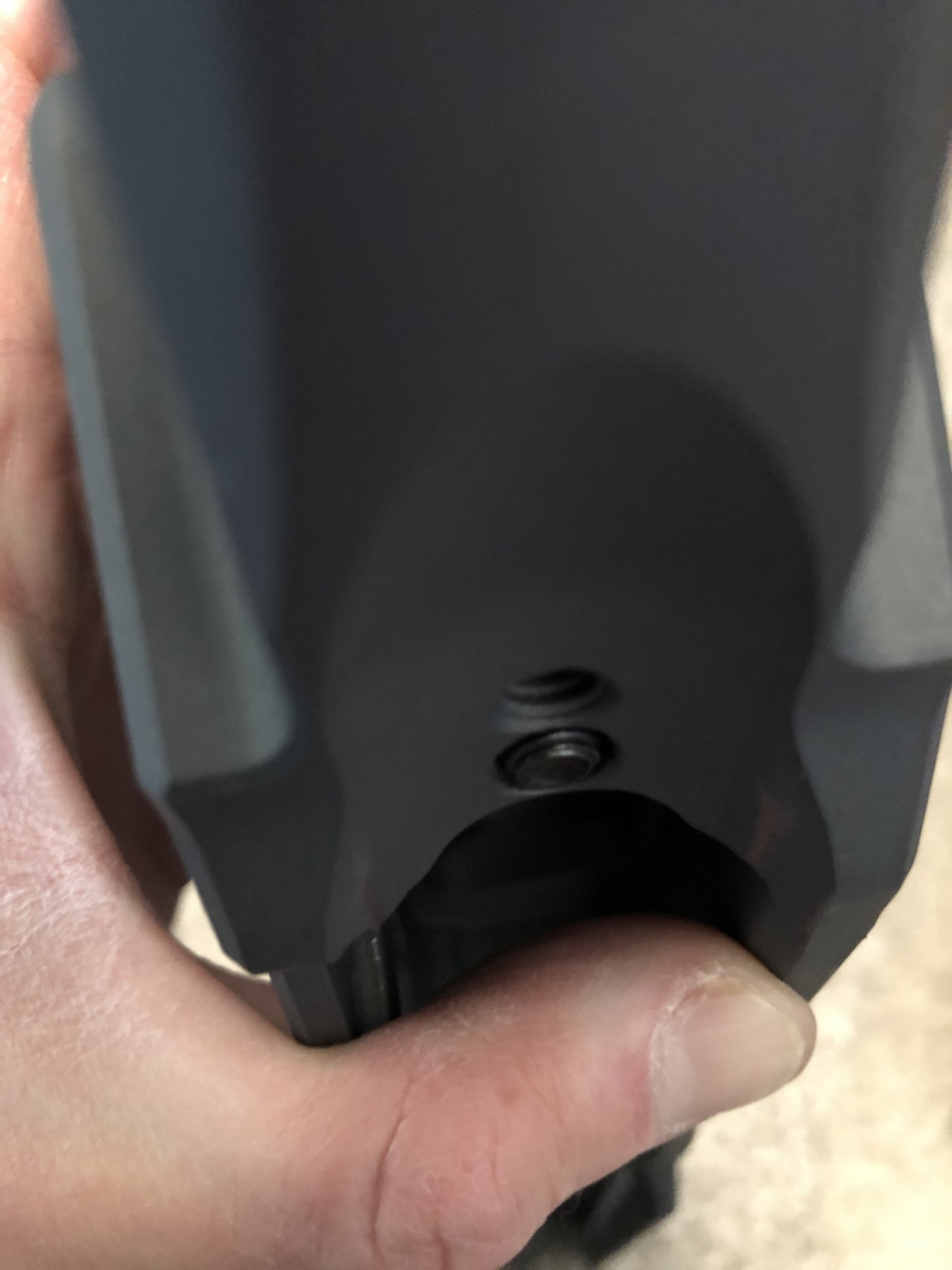

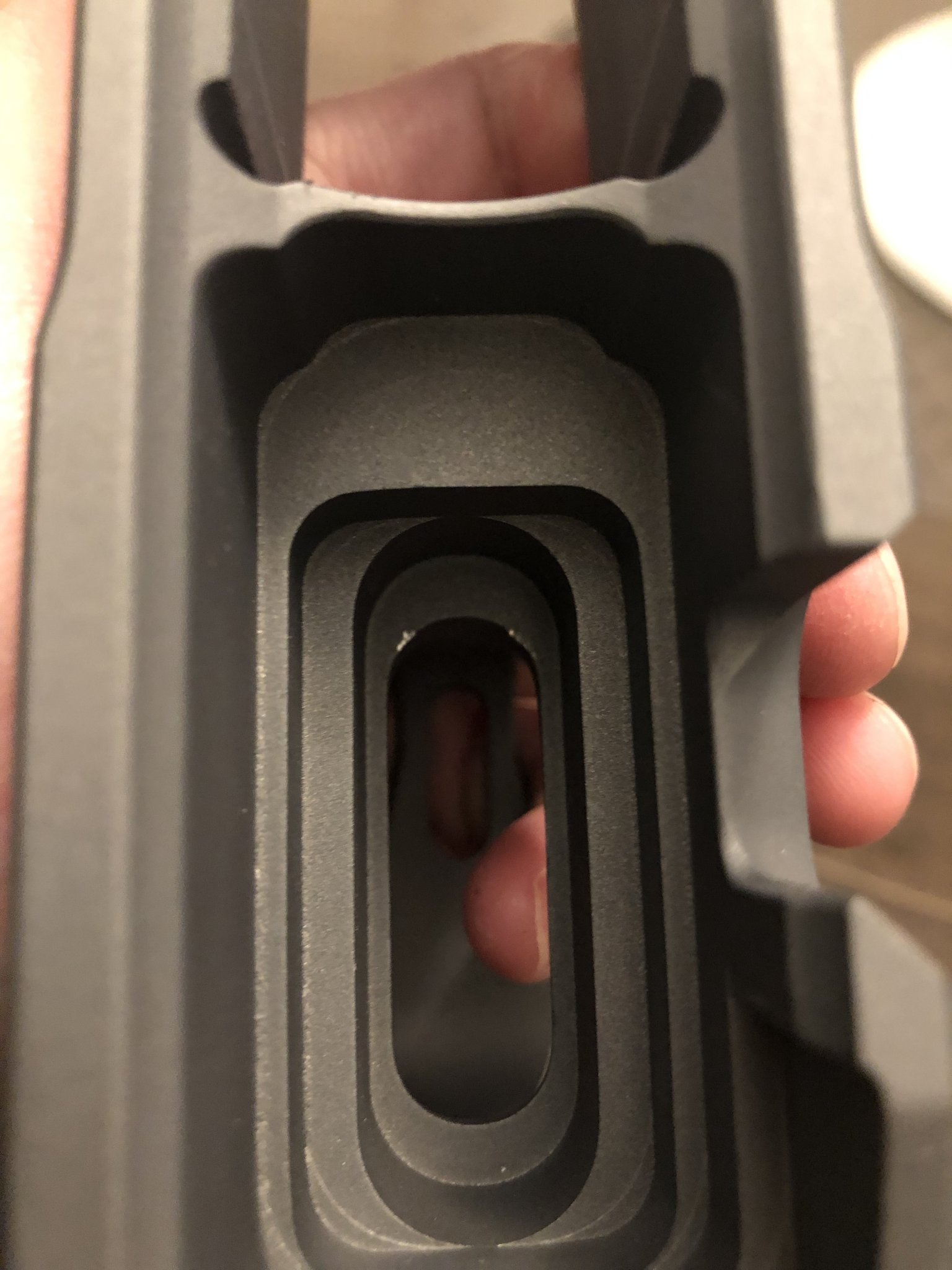

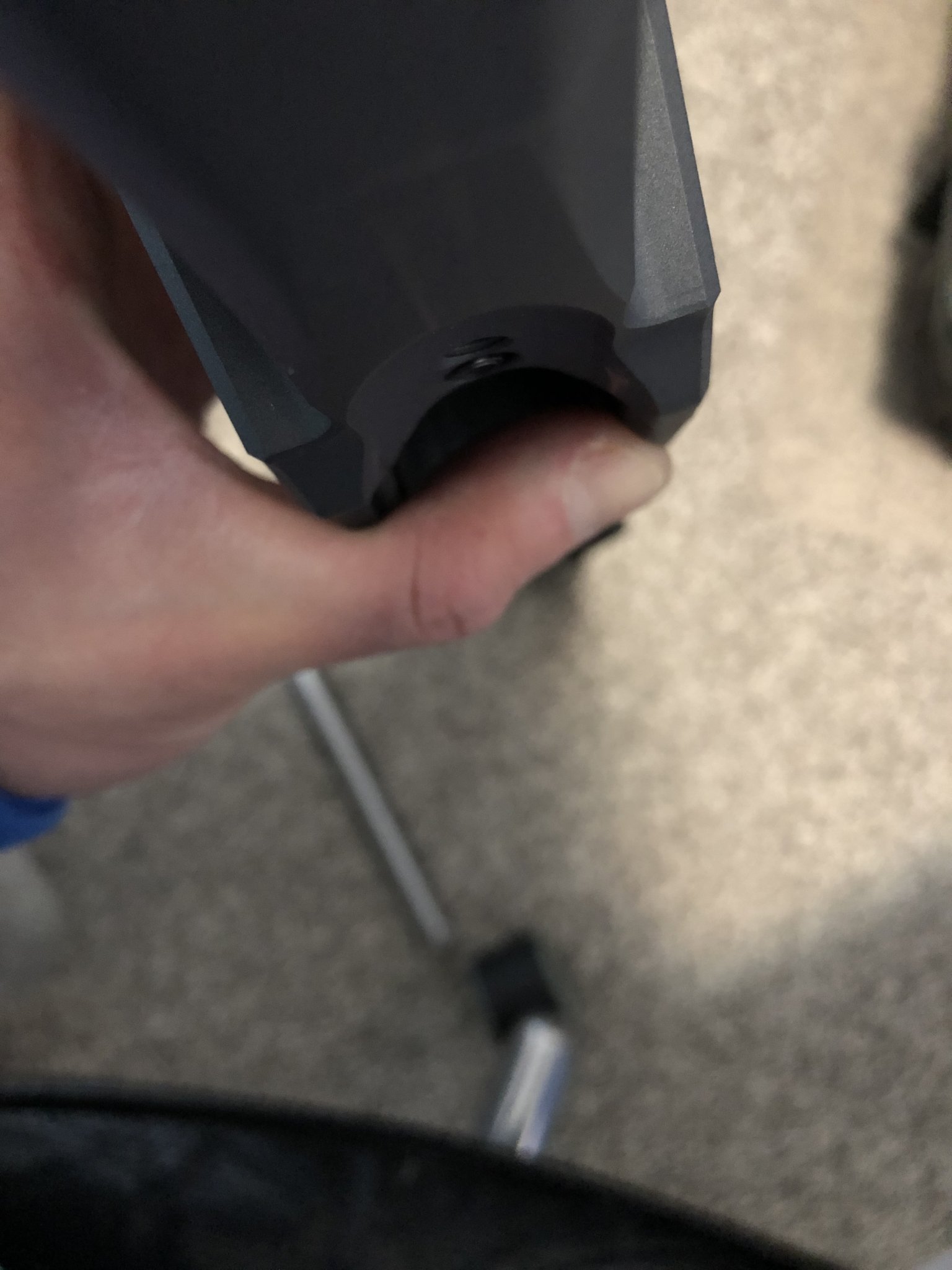

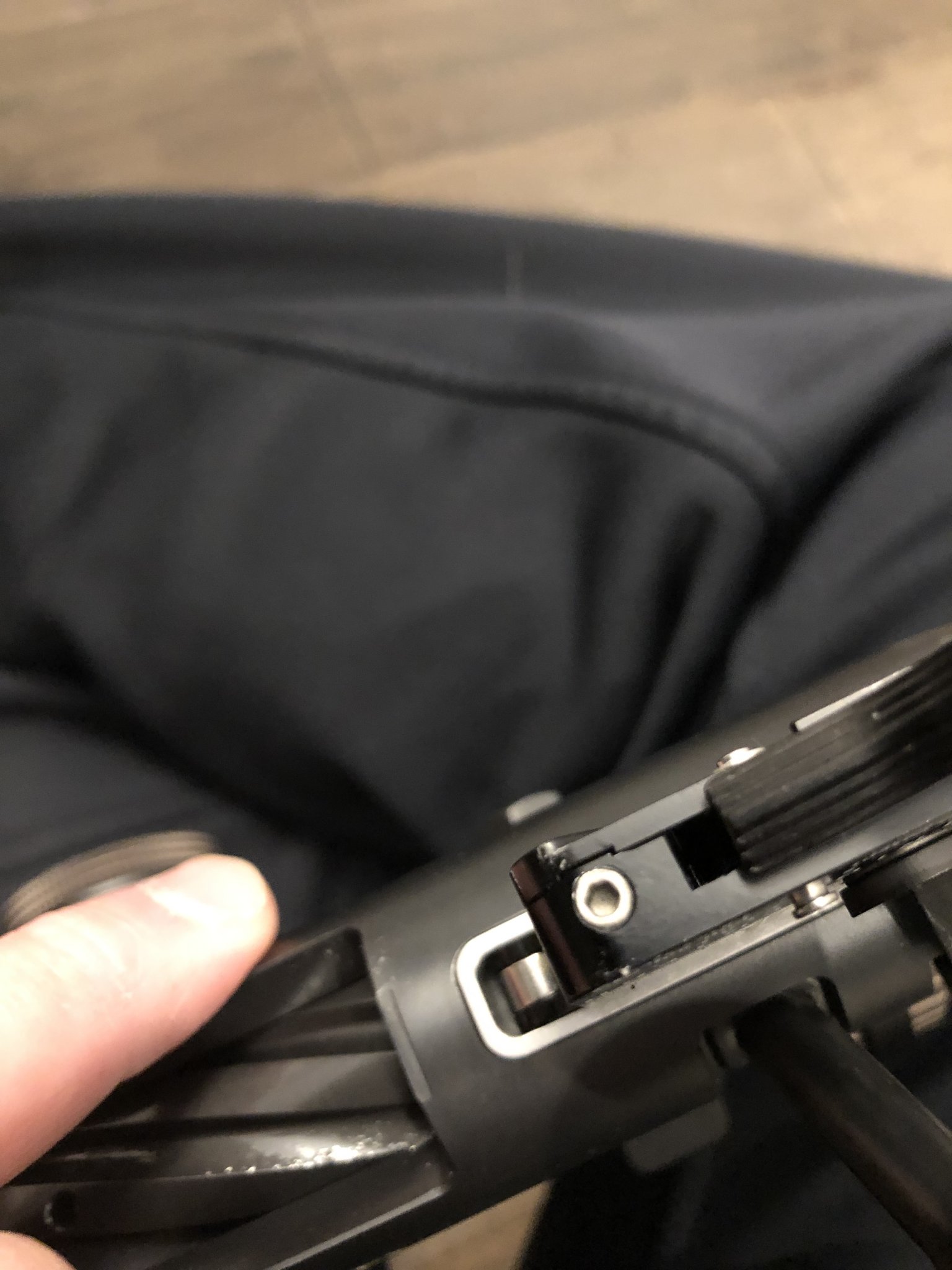

I just tried to installed my deadline barreled action into MDT ACC but there is def some fitment issues.
I ordered this MDT ACC chassis with deadline action inlet required in order note in Dec 2018 and I received short mag catch/release, one extra crushed washer and torqueing instruction for action screws(65 in/lbs front and 40 in/lbs rear).
Deadline barreled action was also ordered during boxing day sale in 2018 and I just received it yesterday(26th Feb 2019) and it has a low S/N,UP0007X. I need to use some lube and small hammer/punch to install two trigger hanger pins. Its a bit oversized IMO.

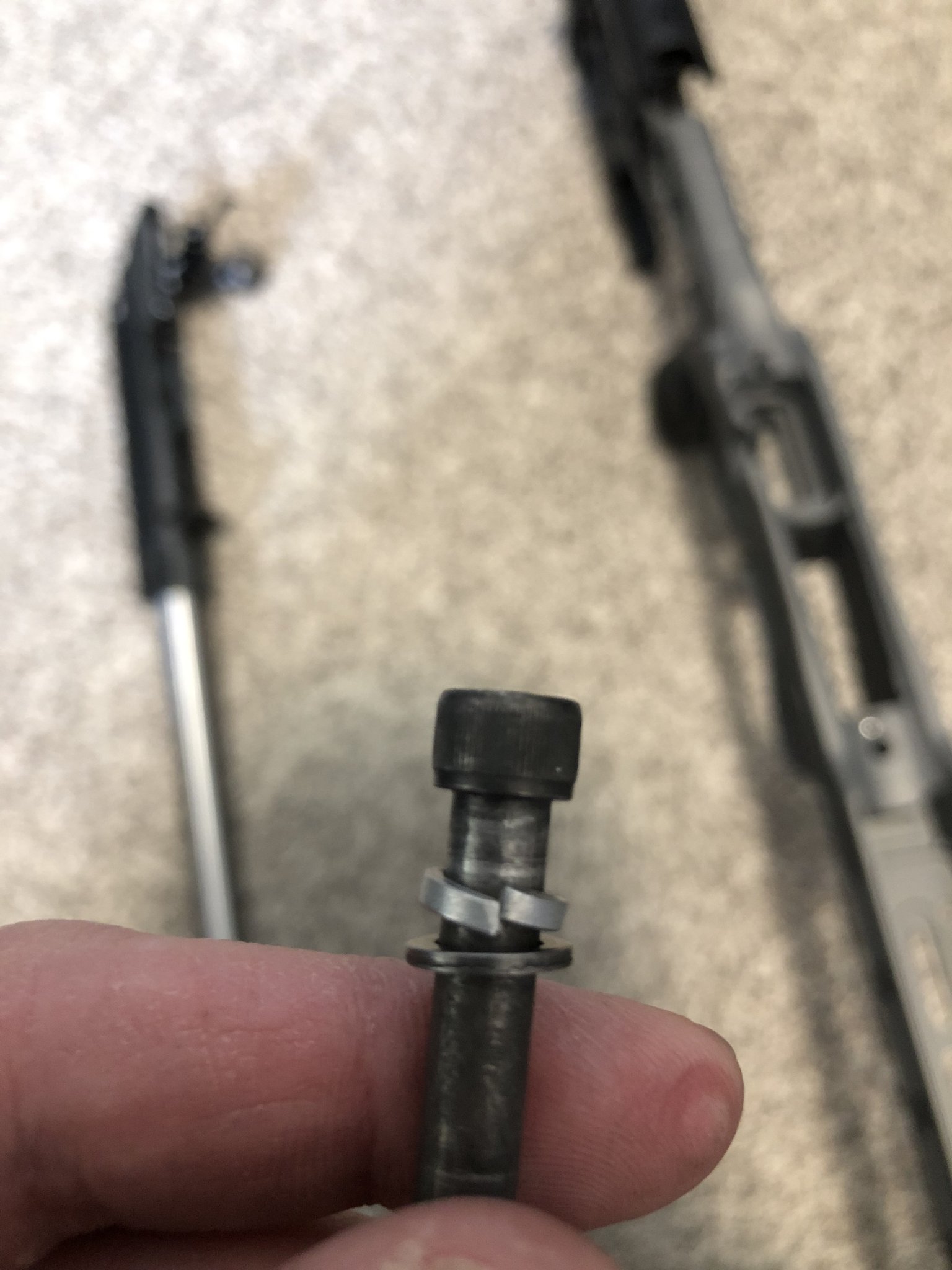

1- Threads won't catch with two washers on rear action screw( One normal washer, one crushed washer and both are provided by MDT),
2-Only able to torqued to 13 in/lbs with 1 washer installed on rear action screw. Bolt can't be cycled if I torqued rear action screw higher than 13 in/lbs

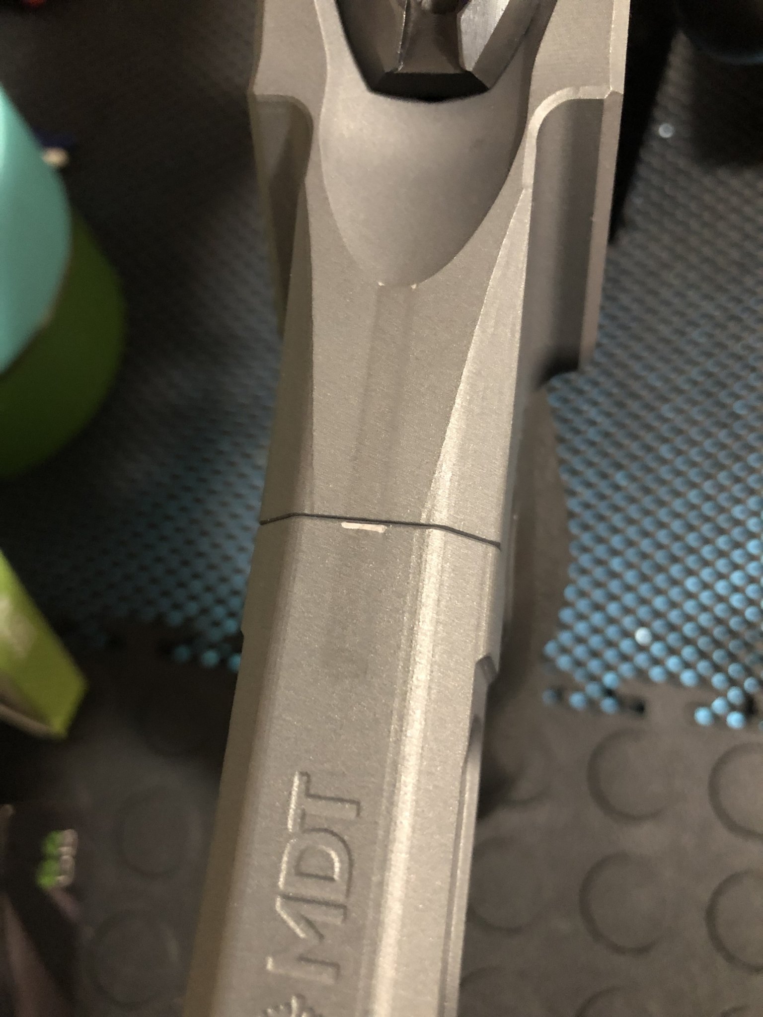

3-Riding mark right above pistol grip, connection point between chassis and stock area
4-Contact points around trigger housing (Trigger tech special rem700 trigger used)
I already contact MDT and awaiting for some feedbacks
I am on the support ticket for this one and I have some ideas for you ;) Don't worry, we'll ensure that we get things worked out!
@MDT_Josh Thanks for the speedy CS and I can ship my ACC chassis with barreled action back for some works if that's needed.
Hey Josh, I’m having the same issue with the Deadline action binding up when the rear action screw is torqued down in my ACC. There seems to be a ton of induced stress in the action, preventing the bolt from cycling even remotely smoothly. The washer is sitting between the rear screw head and the chassis. No dice. It seems like there is a small gap between the bottom of the tang and the chassis. Are you talking about putting a washer there to act as a spacer? Any other thoughts? Thanks!
I saw the support ticket from you too I believe! We are currently running a new run of chassis with some pretty significant changes that should solve your issues. I will be working with Ryan and Anthony here to ensure that we get your issues sorted out :)

I too had issues with binding when torqueing the action down to 65/40. Ultimatum sent me shim, it was placed just behind the rear action screw. I ran the action 60/60 and no longer have issues. My trigger is a TT, the chassis is a MDT ESS.

On Monday I tested the first ACC with the "Deadline fix" and it ran multiple full mags at 65/65 in/lbs front and rear. The production run is going ahead and we'll have some available for you guys out there that are having issues :) They are not for sale/on the site just yet, but we'll have them spooled up probably for next week or the following one?

Why is a shim needed under tang? The bottom of action is on the same plane, front receiver ring and tang. The only issues in most stocks is the trigger hanger, rear bedding area needs clearance in front of screw. The bolt cocking piece can drag on stock, aics or sentinel(older ones without groove). Sounds like most chassis are pretty well drop in, with exception of mag catch, shorter rear screw, and checking for clearance of trigger hanger and cocking piece. Seems like adding a shim between tang and chassis, and not front, would add stress to action once its torqued in.
Reactions: jzwolen and Pgd
The shim is a temporary fix for the Deadline in our chassis and solves a "conflict" in geometry between our V-Block and their action. I'll send you a PM to explain more.
