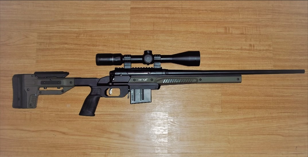

I have an Oryx on a Savage and you can add a sling mount to it. The cheek riser on mine has a cutout on it so the bolt can be removed without having to take the cheek riser off. They also make an ARCA adapter to add accessories. Again this is on a Savage AxisII so I to was limited to what choices were available because of bolt spacing on the action. It is a solid chassis but a little on the heavy side.
Another plus was the ability to use AICS mags which upped my mag capacity from 4 rounds to 10 Mine is in 6mm ARC.

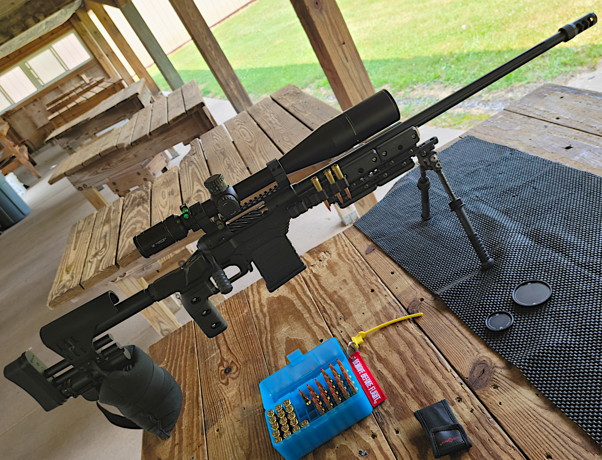

I'm running an LSS-XL Gen 2 which I chose over the Oryx because of a number of factors- I wanted to be able to choose my buttstock, I wanted the integral thumb rest, and I wanted the M-Lok stuff on the sides of the fore end. I added a shit load of weight and extended my bipod forward. I'm pretty happy with my choice *but* I think it might depend heavily on what kind of shooting yer doing which choice is best for you.

Nice set-up! Which buttstock is that?
I initially thought it’d be good to ad weight, but it’s only a 223 and I have a brake so that’s probably not an issue on this one. My 6.5CM sure is nicer with weights on it though.
The buttstock is an XLR Industries Extreme stock....they no longer make offer this one which sucks 'cause I'm wanting to build an exact gun in .338 Lapua. Probably better stuff out there now as it's going on 4 years I built this gun up.
