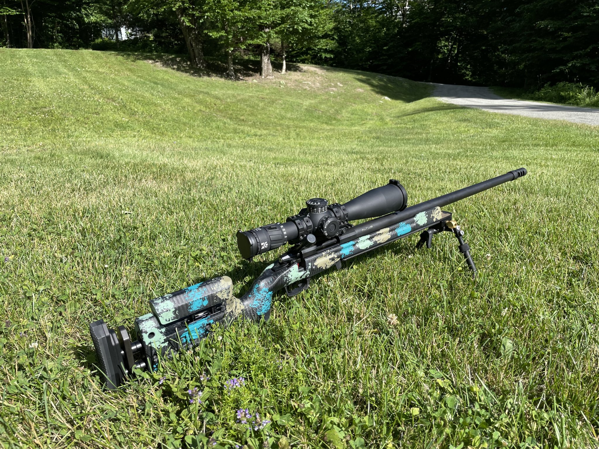

I've owned/ own a Matrix, MDT ACC, XLR Envy, OG JAllen 700, KRG Xray, Magpul 700 Pro, and ARC Xylo.
I still have the Xylo as the main match chassis, the Xray for the 22 lr, and the Magpul 700 Pro for the backup/ practice rifle.

The Xylo is insanely comfortable to get behind, and the walnut grip doesn't get hot. Presumably it won't get too cold either. It's also featured out the wazoo. It, like the Matrix, is a bit heavy to carry, but it balances better.
