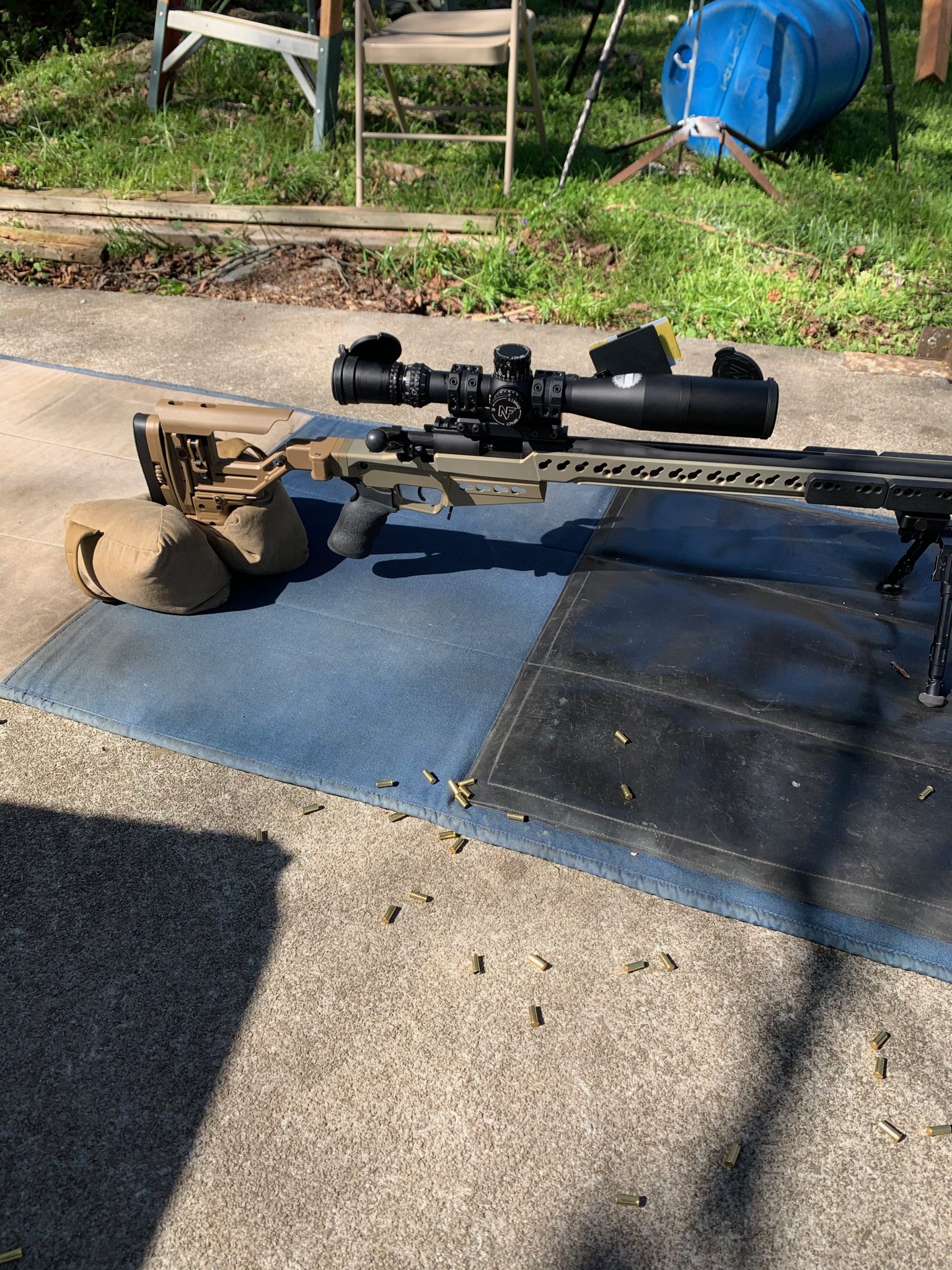

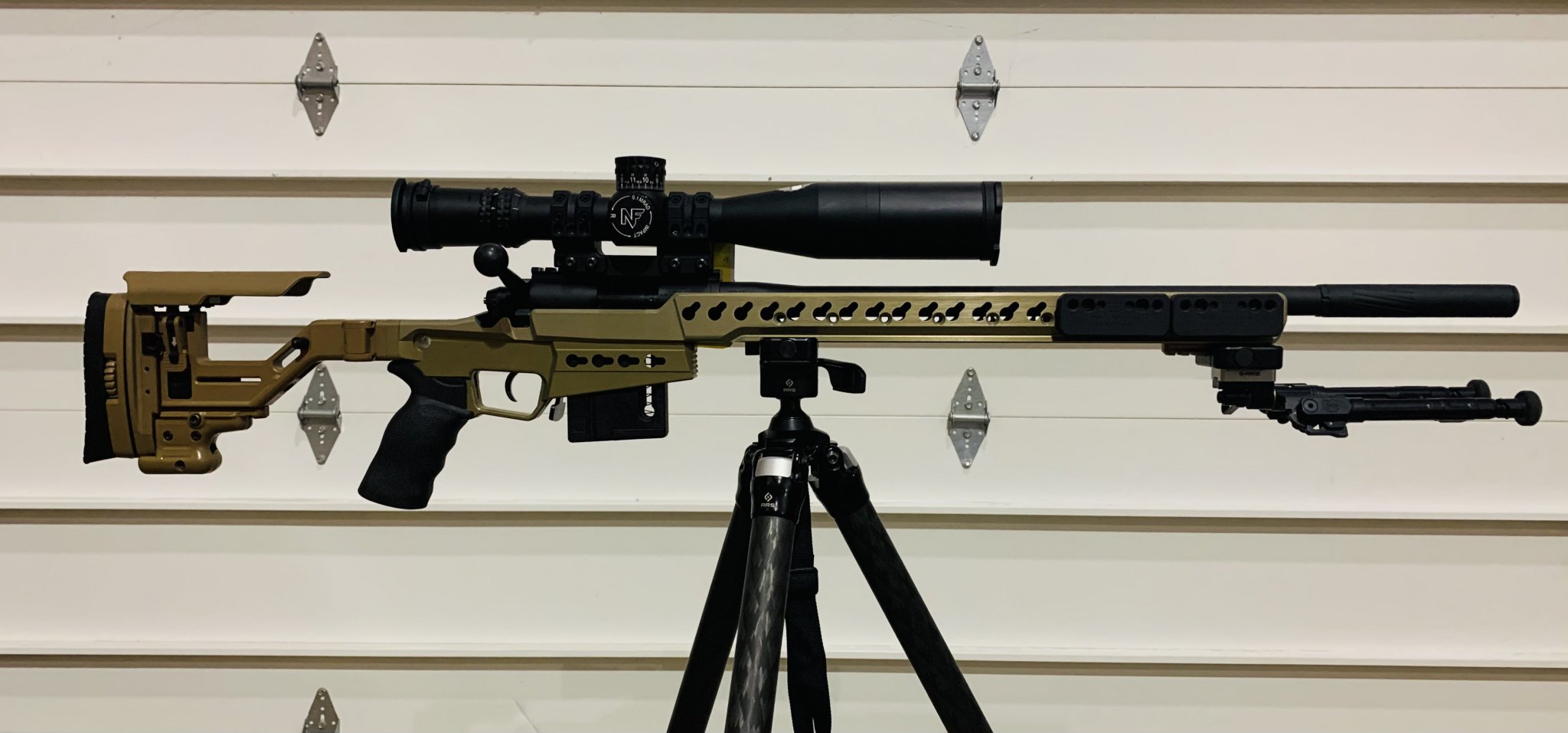

    Fits and runs just fine AICS AT-X
    Barrel profile please… Can I get away with an MTU profile barrel in the AT-X…?
    If you look in the big AT-X thread, early on there was some discussion about barrel contour. I think it will fit up to about 1.1 inch straight with the NV bridge and it was implied that it would fit 1.25 inch straight without it. I cannot imagine there would be any issue with the MTU contour.
