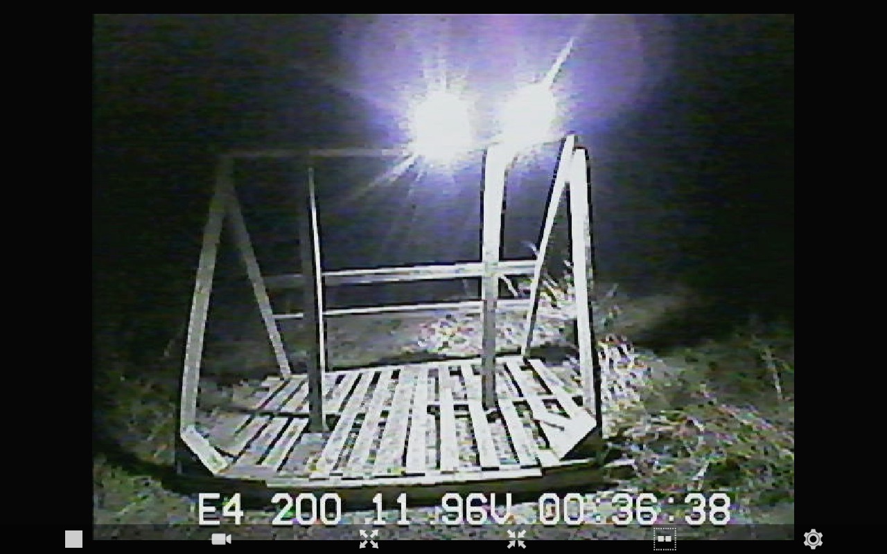

Saw this video on here somewhere. Cost a little more to build now but still pretty cheap. Worked out to 2,000 yards. Need to elevate the camera a little more for a little more signal and give it some sort of armor to keep from shooting it. But it works.
Also now that I know a little more have some experience, there are cameras with much better picture quality, transmitters with more power and receivers that work with iPhones and ipads not just android.
This is a screen shot from a kindle fire.

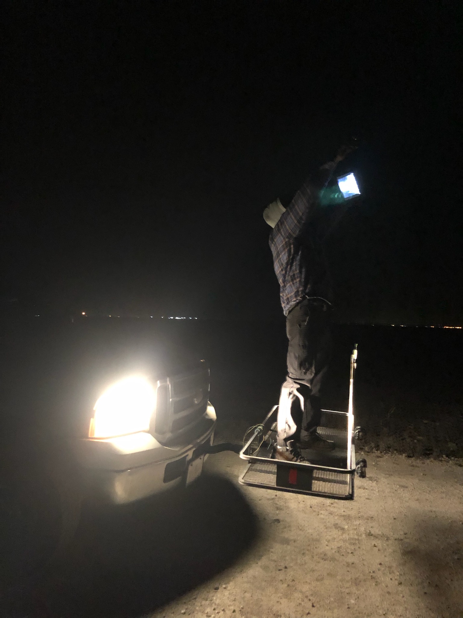

My buddy standing in the basket on my truck at 2,000 yards. Picture had a little snow, but it was there.
