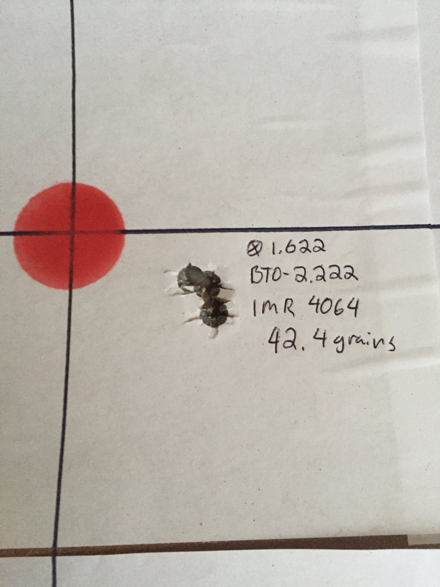

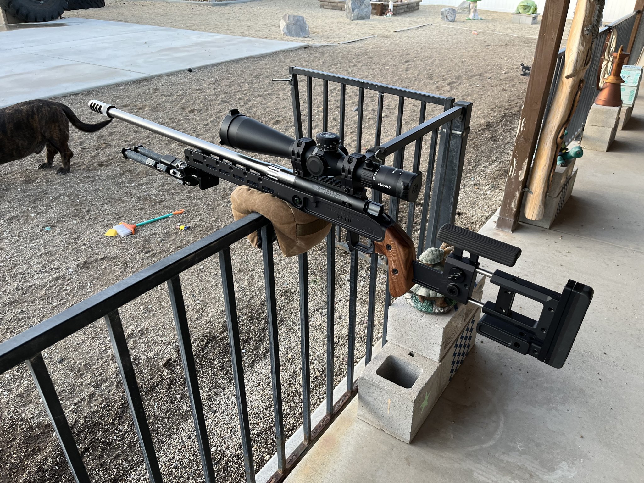

I started handloading about a year ago. shot this today with an $80 single stage press with the charge weighted on a $30 digital scale.

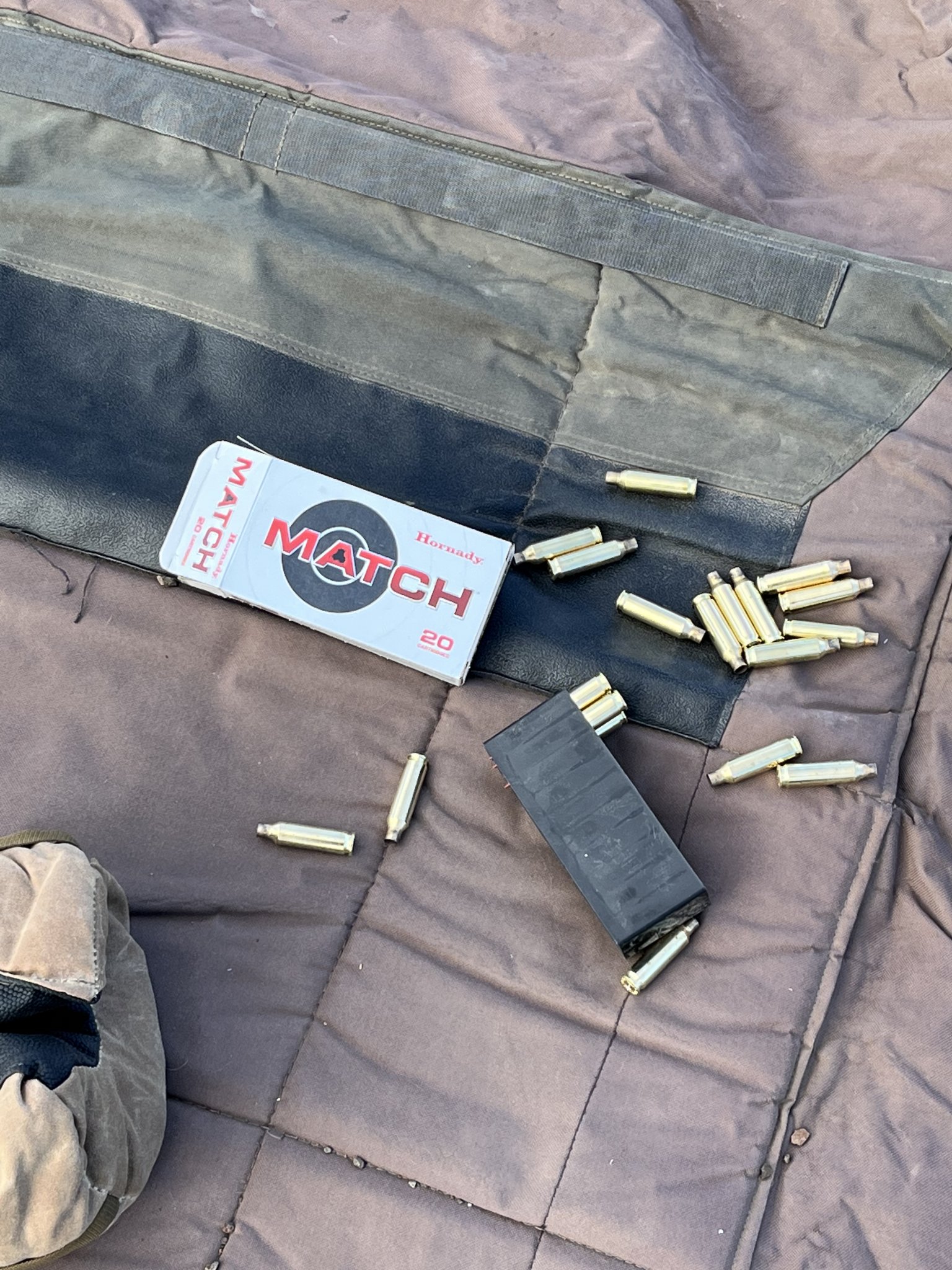

I just recently(last couple months)got back into shooting and I will not be reloading…I doubt factory ammo will be holding me back in any tactical, positional and or prs type of match.

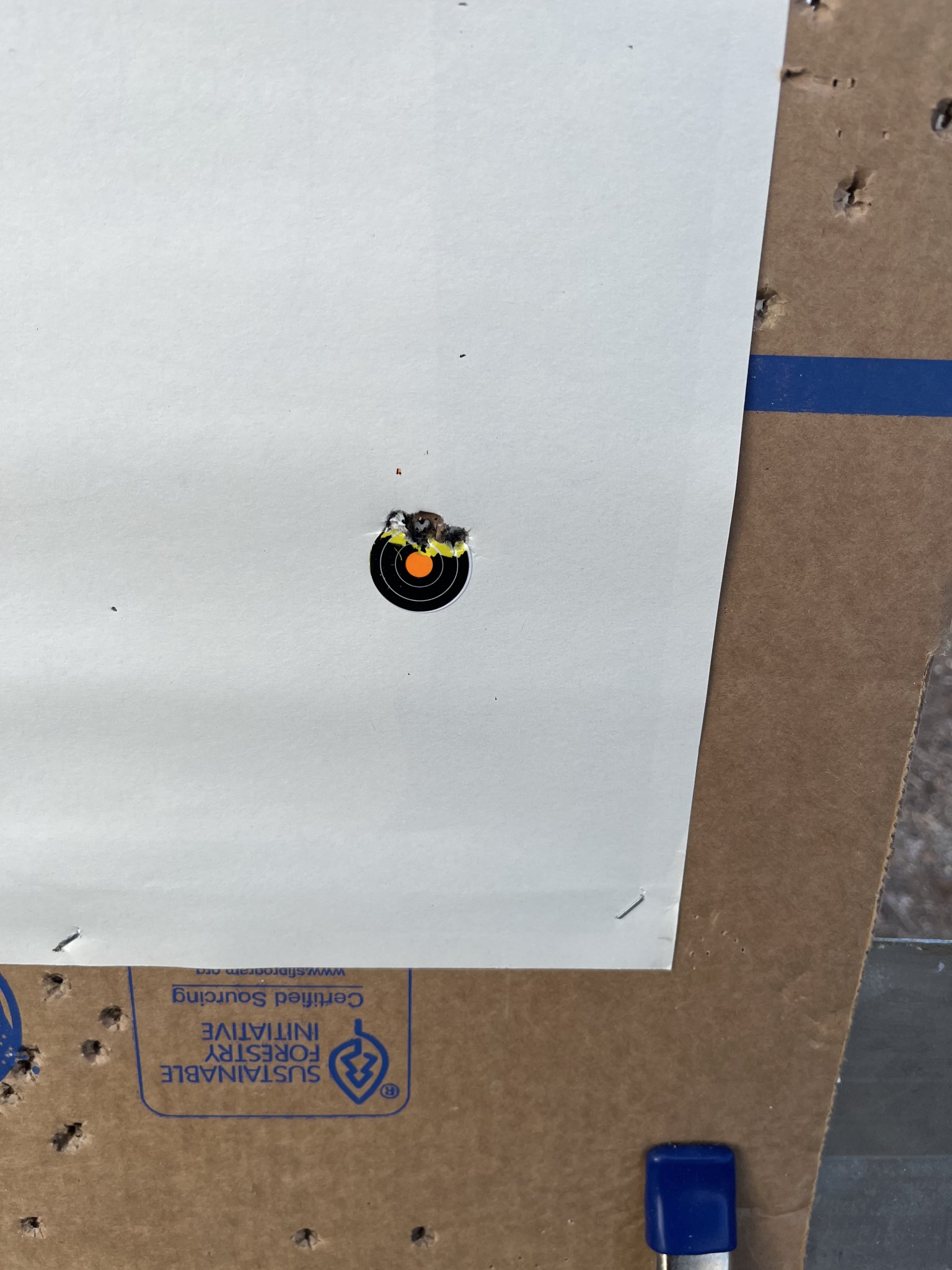

I shot my first come back match a couple of weeks ago in a 20-30mph wind with off and on snow and took 10th out of 18 shooters with only 40 rounds through a new rifle(pictured).
the group pictured is 5 at 100yds with the factory ammo pictured.
You do not need a 1/4” gun and do not need to reload to win prs, tactical matches.

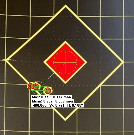

I don’t have a lot of opportunity to shoot past 500 here is the socialist state of Maryland and it’s environs.
But I do get to shoot paper (splatters hot type targets) out to 400-500. And during a Frank/Marc clinic we shot grouos at 300 which seemed to be enough to open em up and show us our shot execution errors.
Now this one was at my cousin’s club in SE PA. 400 yards. I normally shoot 5 shot groups but when I saw this after 3 shots I chickened out! Haha. I was pretty sure I’d open it way the hell up if I shot more so it was more like take it and RUN. LOL

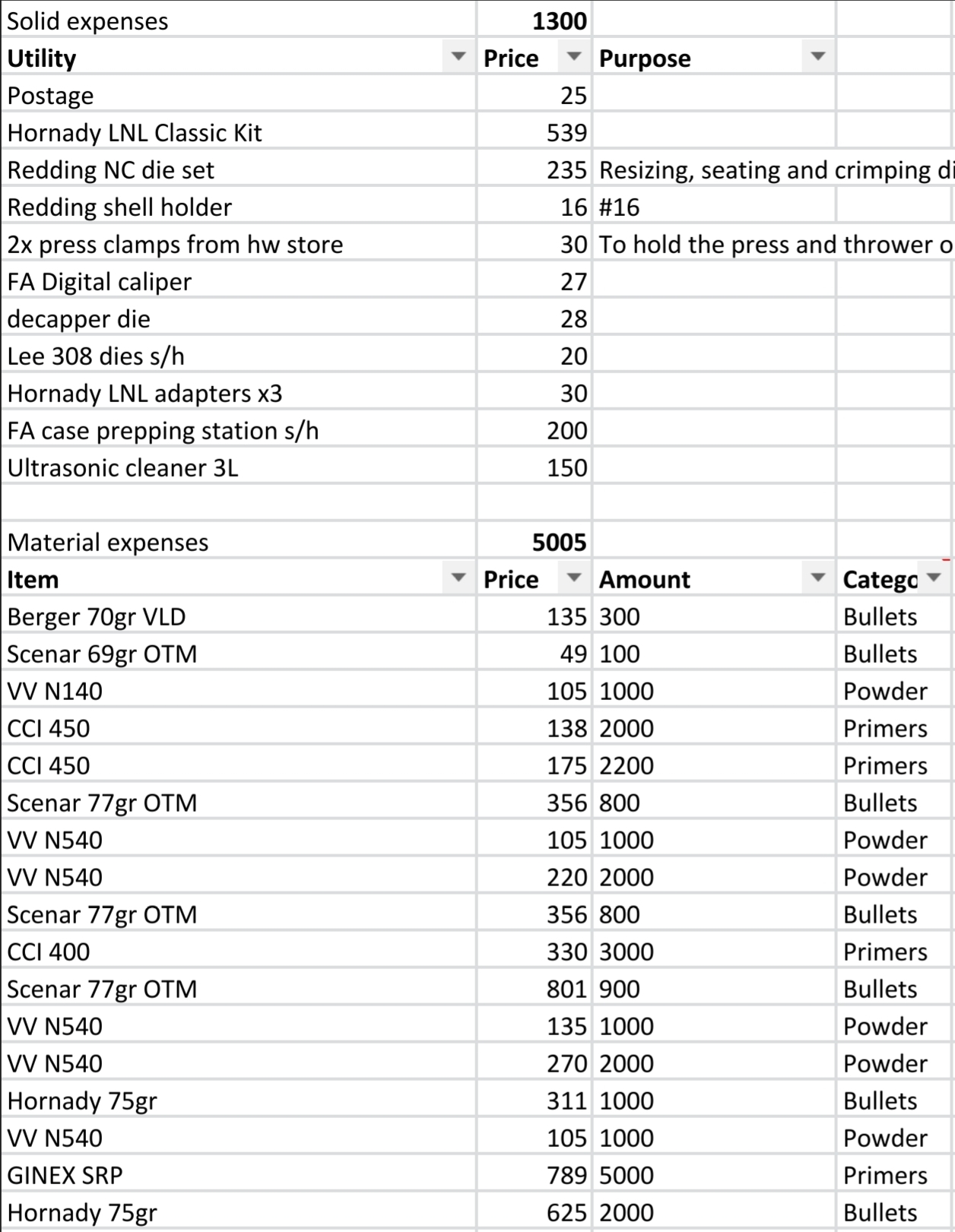

I have reloaded 2K precision 223 ammo this year and started reloading in February.
I have thousands of cases prepped ready.
I have a feeling my barrel is near final so I am not going to start bulk loading until I break in the next one but reloading does allow great flexibility.
At the moment I have 1300 spent on the kit and 5k on materials which most are unspent.
My rounds cost 65 to 75 cents to make (24% sales tax) and at shop they cost 1.2 to 1.4 at minimum at the moment and availability is bad.
So after a little under 3K ammo is done, my equipment has paid for itself. I guess my next item is automatic powder dispenser, maybe. 223 ammo is quite sensitive to small powder variations.

As far as reloading, it's not something I really enjoy doing. I end up at around $0.70 cpr not including any brass costs, but I don't really track what my cost is because it's not the point for me. I have thousands of dollars worth of reloading equipment to speed up the process and churn out very consistent ammo to my liking. Did I save any money? No probably not yet. Will I ever? No probably not. I'm going to keep buying expensive products to shorten the time it takes me to load and increase my consistency. Shooting time and family time are much more important to me than loading time, so if I have to spend money so I can spend less time loading so be it.
The point of reloading for me is that I get full control over everything. I get to choose what bullet I shoot at what velocity, meaning I control how much time of flight I have on most engagements which translates into seeing impacts and misses more often. I get to choose what compromises to make and where. The problem with factory ammo is that it takes all of that choice away because the decision is already made for you. 60% of the time, I'm not satisfied with the choices that were made. I don't hunt. I want every possible advantage I can get to give me the best chance at maximizing my score at my current skill level in competition. Example: Hornady 6GT factory ammo is great ammo. Shoots sub half MOA consistently and has single digit SD's with a good bullet. Absolutely capable of winning any PRS match out there. They run 2900 fps plus. That bullet gets to the target slightly faster than I want it to. I now have less time to reacquire the target and see impacts. Sure, you get better ballistic performance but I don't think that's really an advantage for the game I play. If I ran that ammo however, that's what I'd be stuck with.
I’m just saying American gunner is near mafch grade. S and b is known dog shit
When I started shooting matches last year I got accused of reloading shooting American gunner lol
