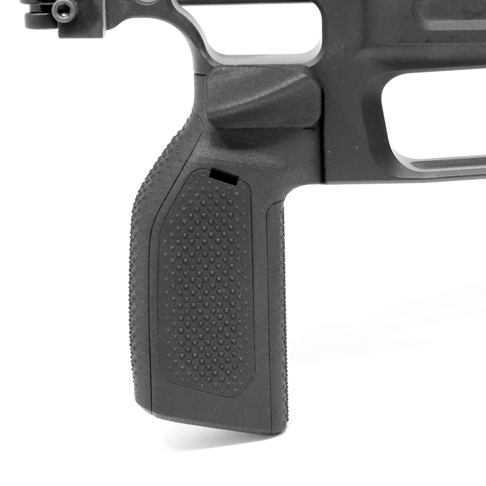

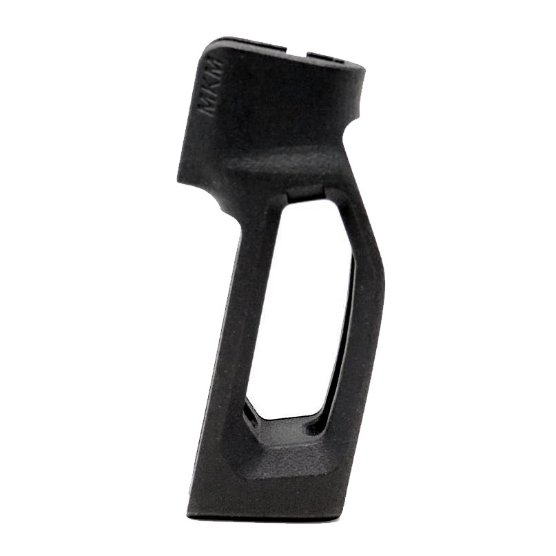

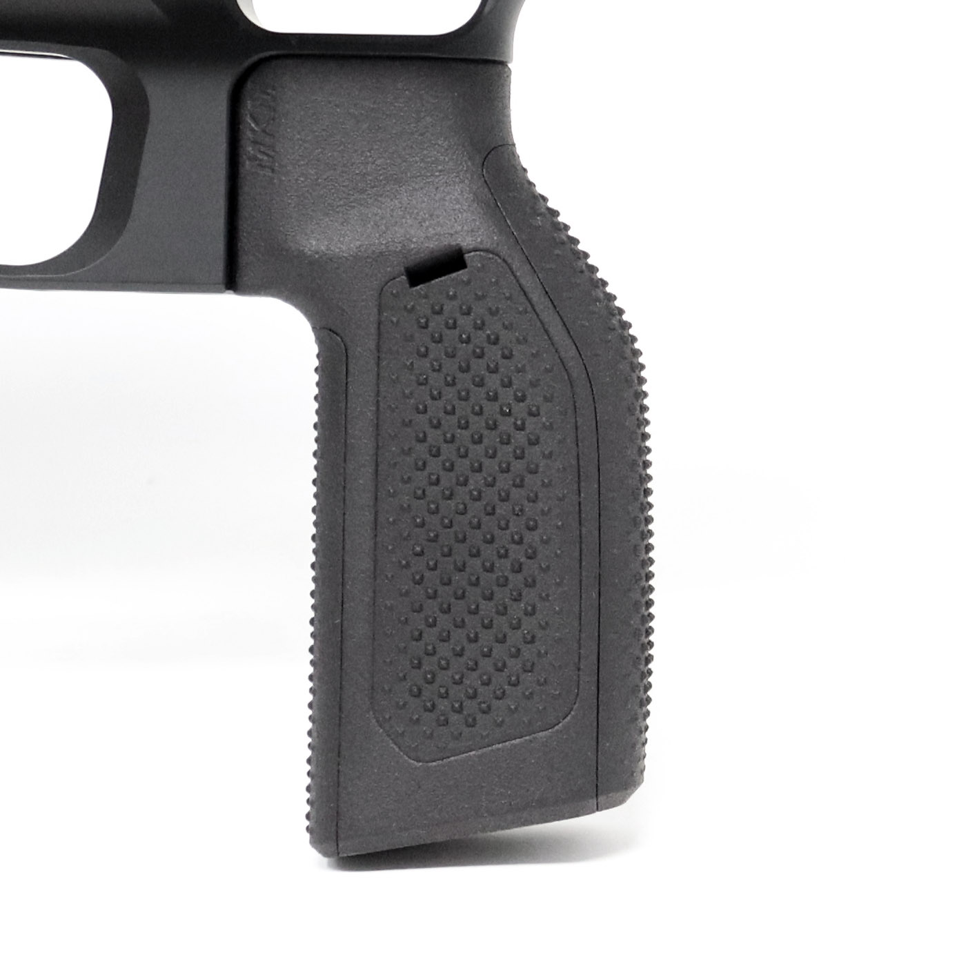

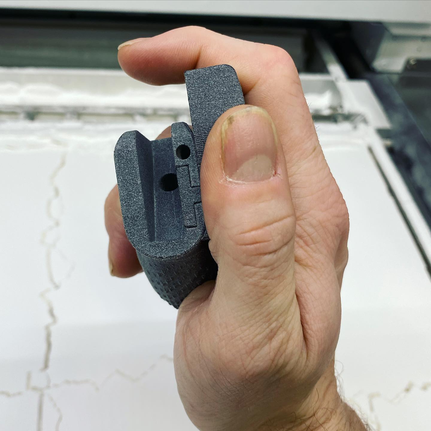

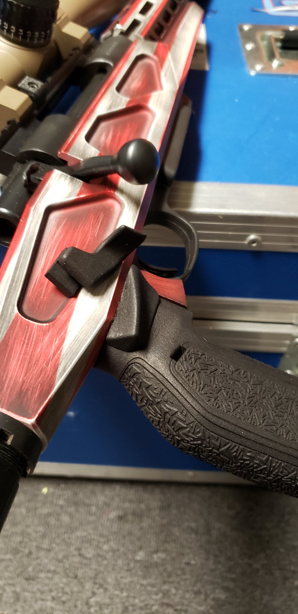

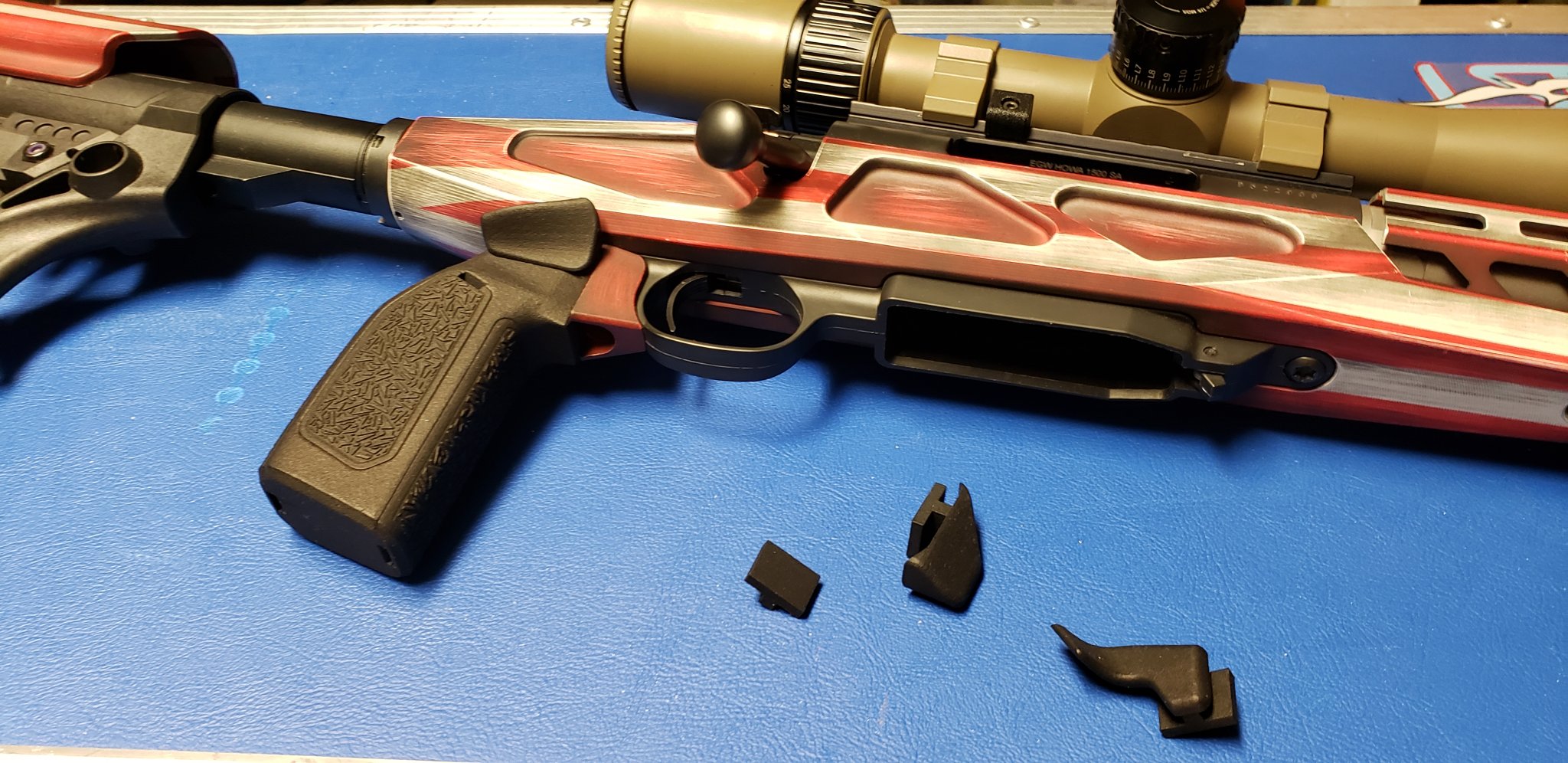

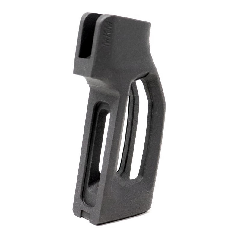

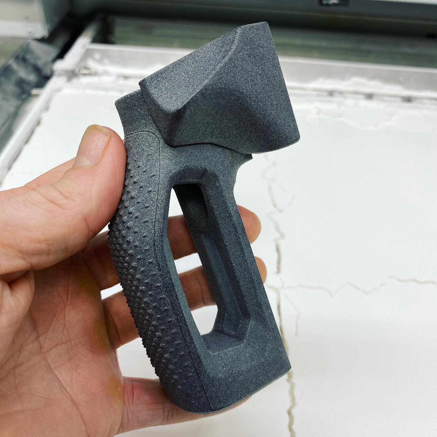

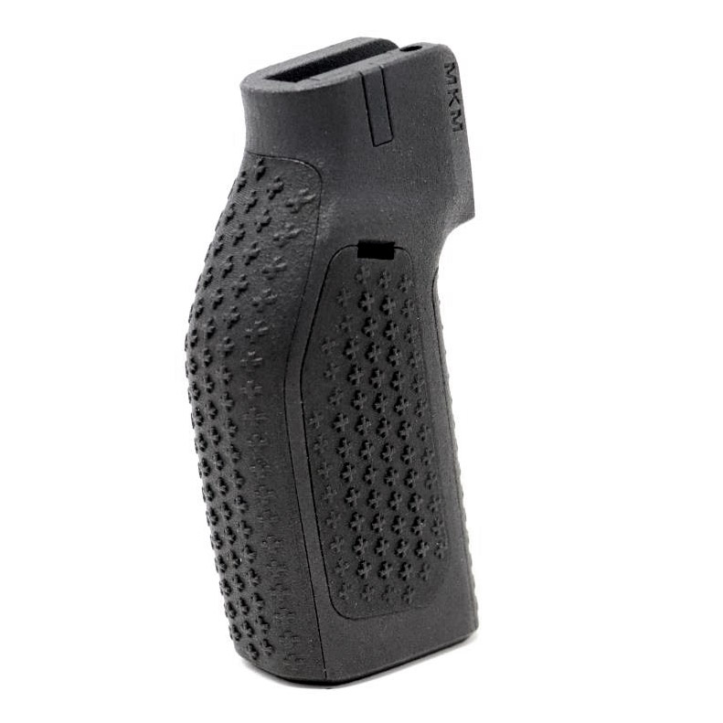

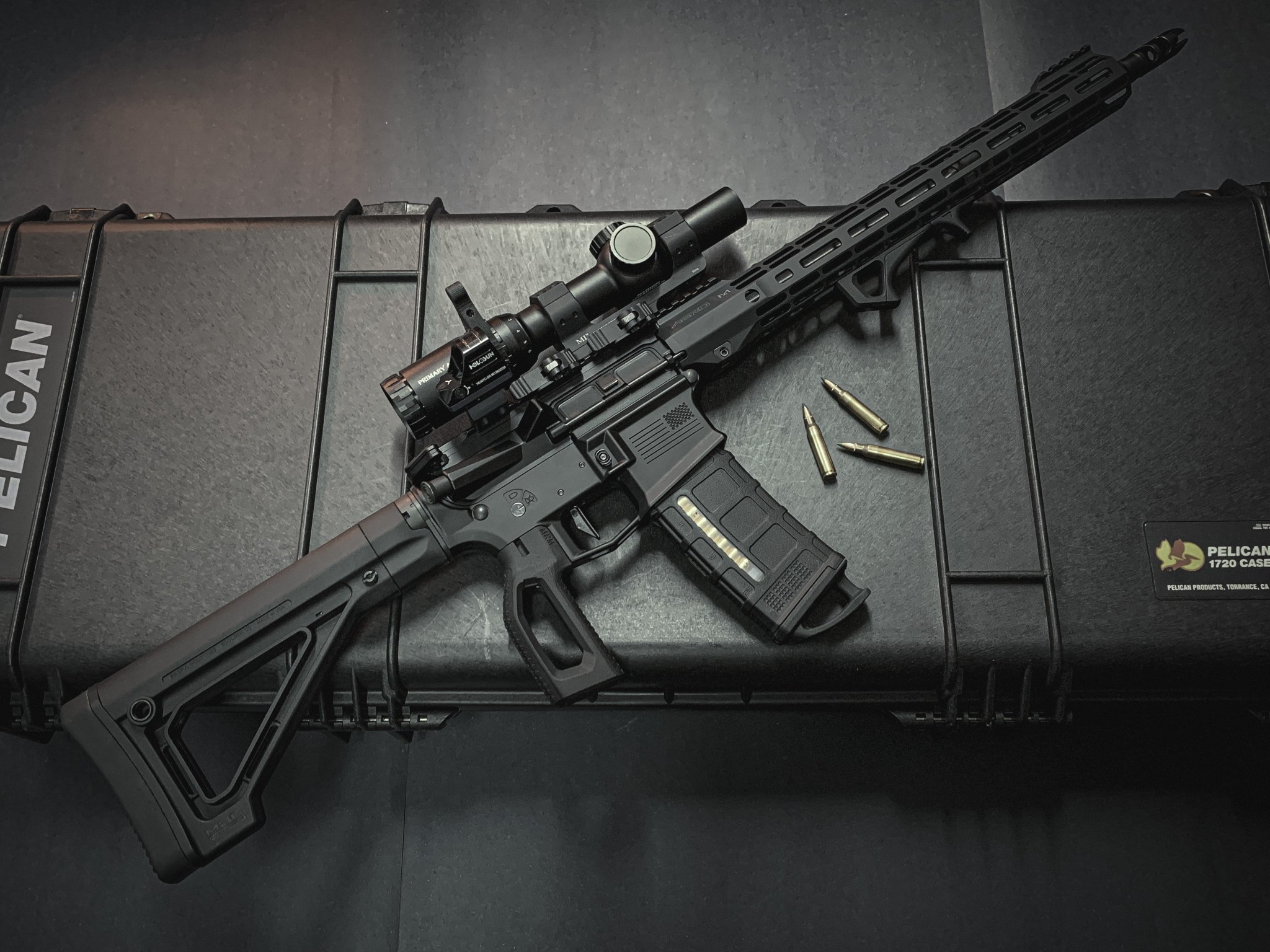

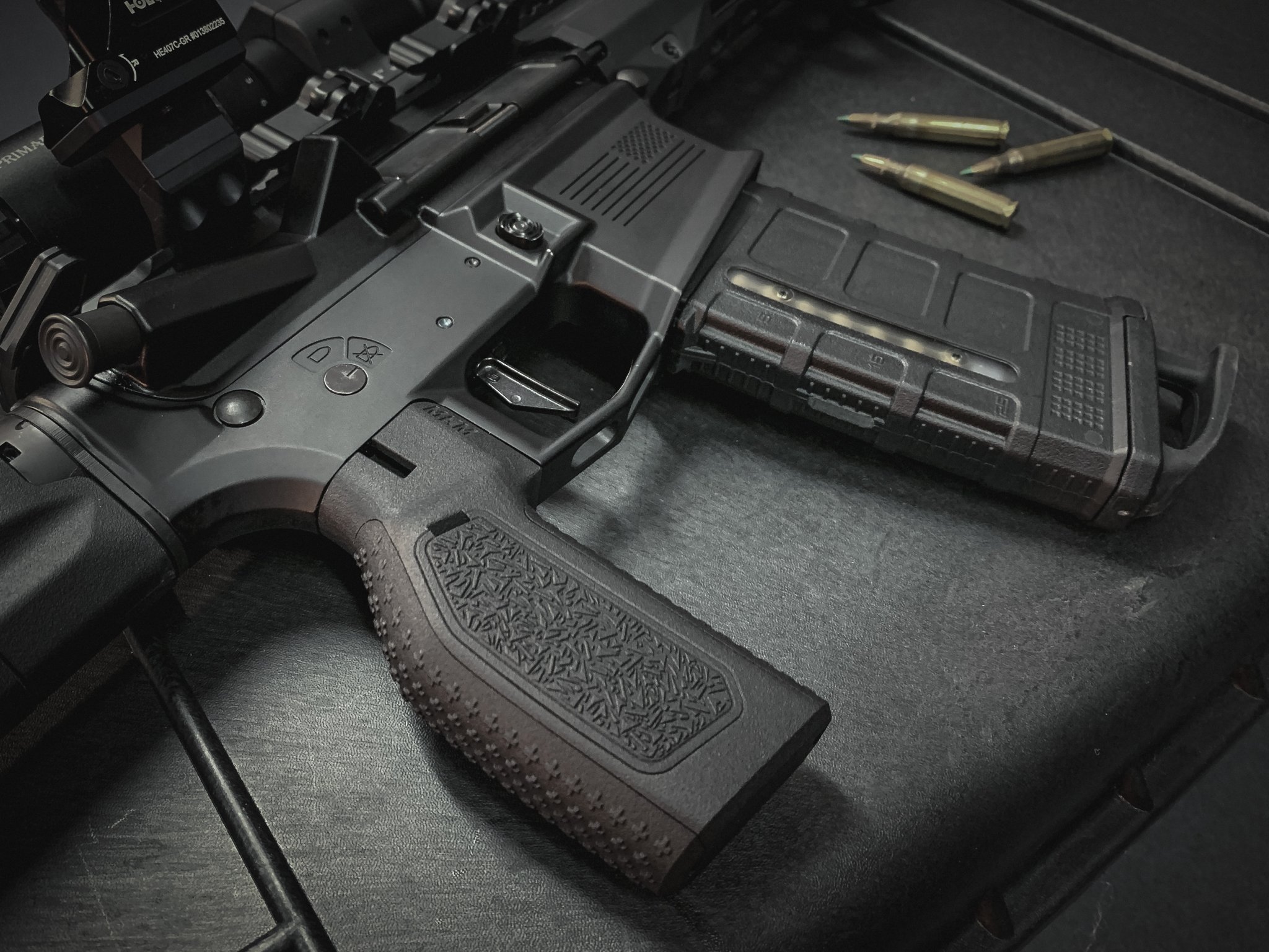

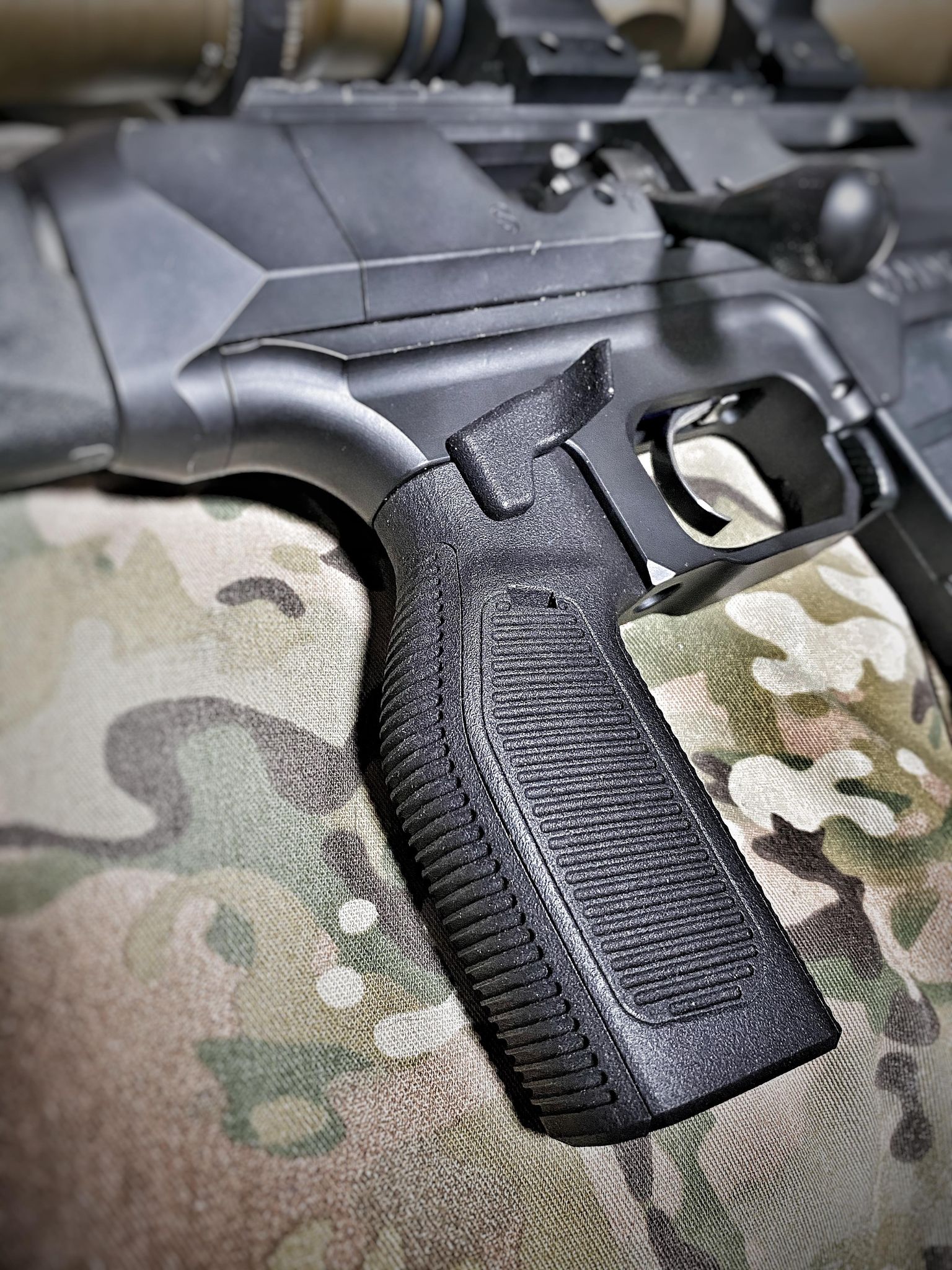

Hello all, look forward to your input on my newest product. I've spent quite a bit of time and effort prototyping, testing, etc to get this to a place I like.
There seem to be "AR" style grips for actually gripping your rifle, and "precision" style grips not really for gripping, but for proper hand placement for accuracy oriented shooting. The 0 angle Ergo is the closest thing to doing both, and I like it enough to include it as the stock grip on my MK2 bullpup chassis.
There is not (to my knowledge) a customizable, "crossover" style grip that is oriented at filling both roles, with a 0 degree angle.
Enter my "Adaptive Precision Grip". There are a myriad of features and customization planned. As of now at launch there are several different textures and thumb rests available. Coming in the near future are different palm swells, backstrap thicknesses, "finger placers", and more.
It's all based off a chassis system with interchangeable snap fit parts, made possible via my MJF 5200 3d printer, using nylon 11 material which is not at all common, but perfect for my needs. I'm hitting good tolerances and the part finish is very close to injection molding, without the need for tooling.
Without further blathering, here's some pics, and I look forward to your thoughts. You can check stuff out here:

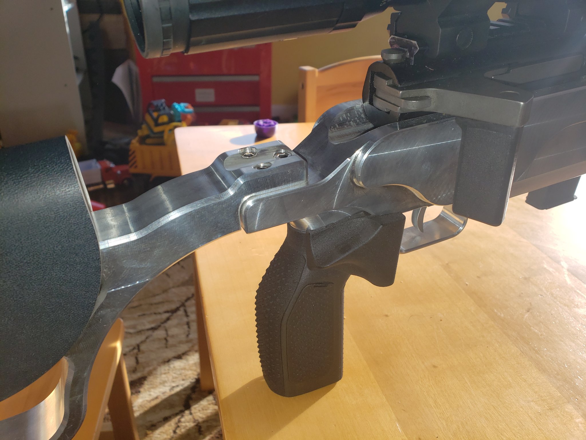

Got one with a finger placer and am trying it on my Izhmash Biathlon. Haven't had a chance to put actual rounds down range but have cycled and dry fired a good bit. Had to mill a tiny bit on finger placer to fit on an ARS chassis as the chassis is a bit wide just above the grip area. It feels great and puts my thumb in a comfortable position with easy access to toggle. Gives a good 90 degree trigger finger position. Going to try on a bolt gun next to see how it feels on that.

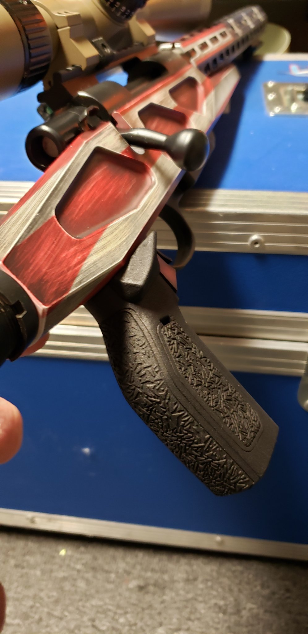

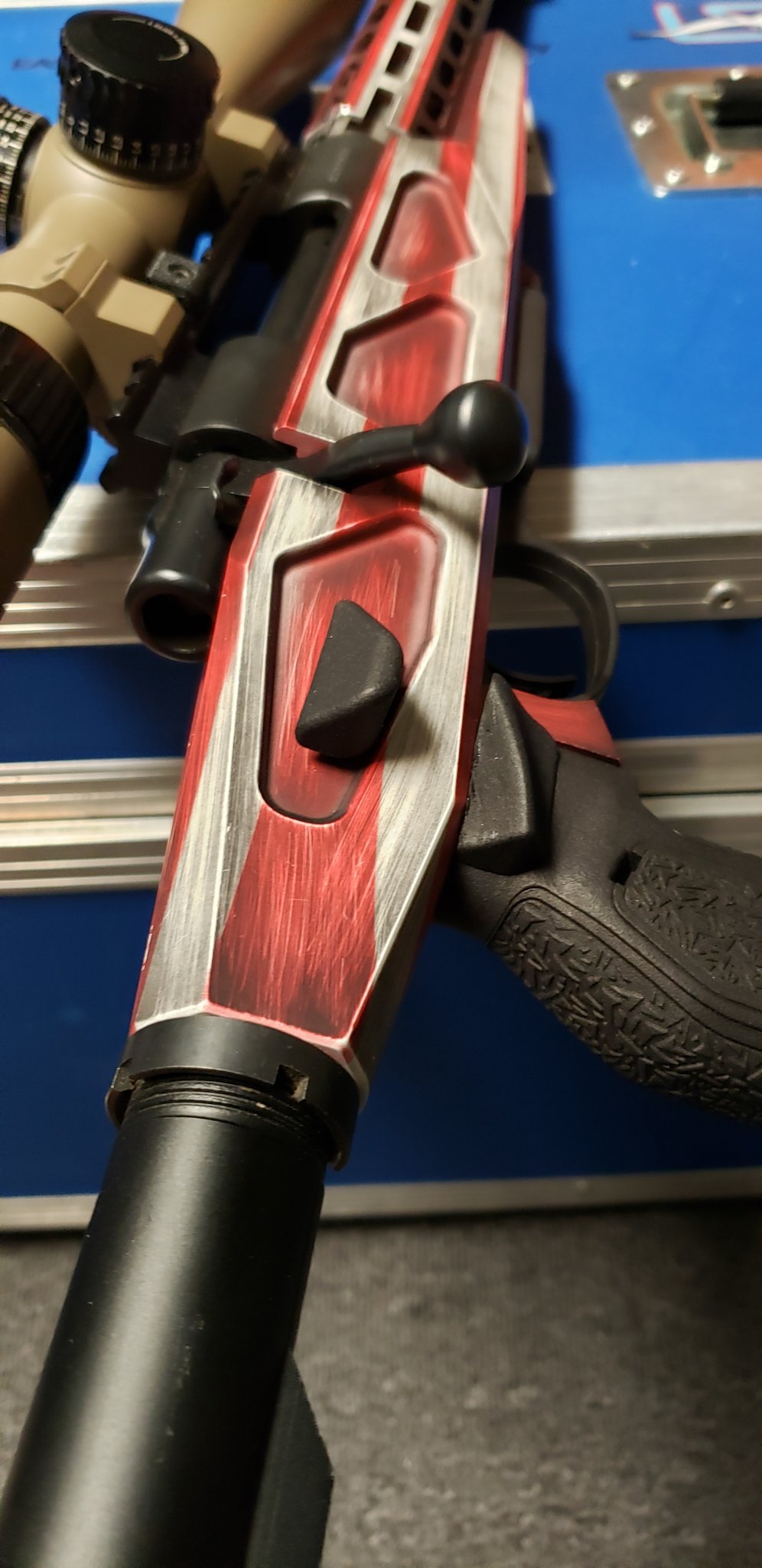

I think my one shelf was printed upside down or something, the 5th pic posted in the original post.
Overall it seems nice. Had to modify the shelf on the grip now to fit with my chassis. When gripping the shelf doesn't get in the way of my trigger hand, but locates it quite nice.
The area that mates up to the lower trigger guard will probably be modified as well to make a smooth transition. But again that is just on my rifle.
The texture is nice, and feels grippy but not overly aggressive either.

My employees shipped you my damn left handed prototypes! Please contact [email protected] we will fix you up. I had done a few lefty grips and thumb rests and they accidentally got mixed in with the rest of the grips.
Email in coming man.
Its not a big deal, will go in the box with the bubble level with no level. Lol. Shit happens so no worrries.
