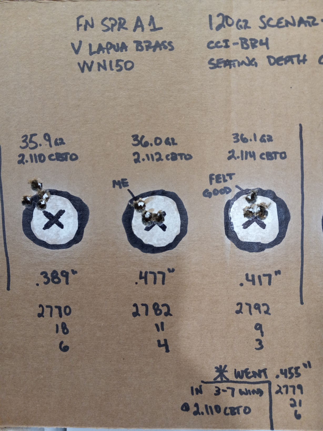

This was me just checking small seating depth and charge weight changes from an initial load that showed promise. This was all done on virgin brass.
