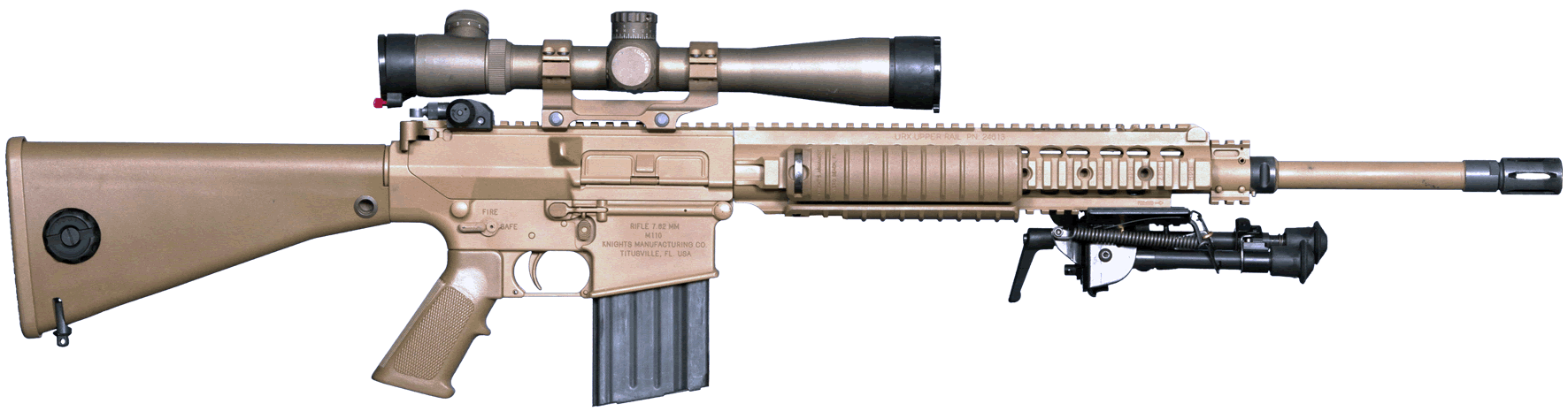

the M110 is my duty rifle I need a cheek riser for it that won't interfere with the charging handle. I was told my solution of padding and tape was unacceptable as well as switching out buttstocks. With that said anyone have any luck with cheek risers for a A2 style stock more specifically the the M110 stock? Thanks in advance.
For those not familiar

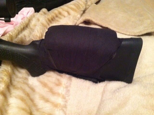

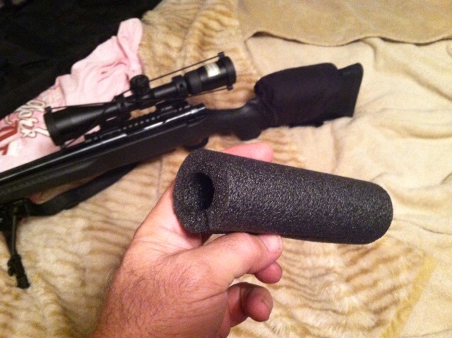

image.jpgI use water pipe insulation, the black or gray foam stuff, and black sports tape. The tape sticks good to itself but not to my stock and leaves no sticky residue on the stock.image.jpg
