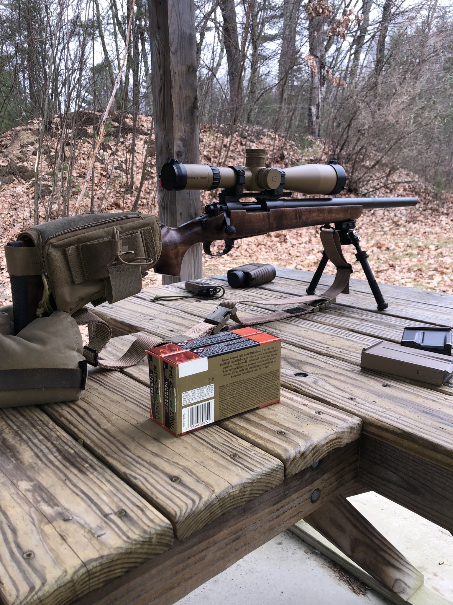

I just add a Triad stock pack to my new wood stocked rifle that needed some cheek elevation.
Here is what one looks like on a Model 70.....
If you order from Triad include buying extra riser material. It's just strips of hook/loop Velcro used to build the comb.
These stay surprisingly tight on the stock if you put them on well.

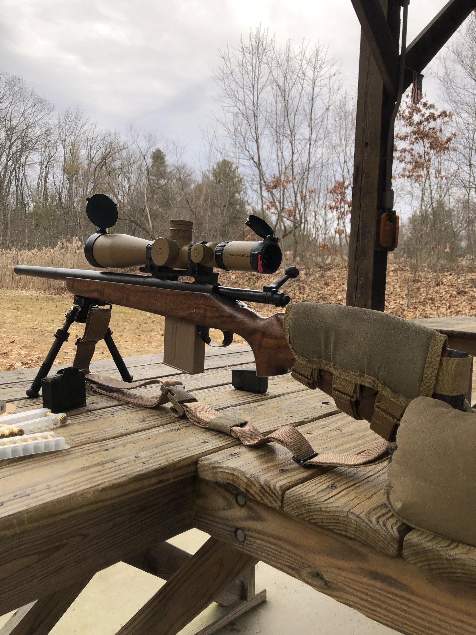

Watch for my weekend post when I take my newest nice wood rifle to the range with its new Triad stock pack.
The new rifle adds the problem of being a Monte Carlo style stock yet still the Triad fits tight.

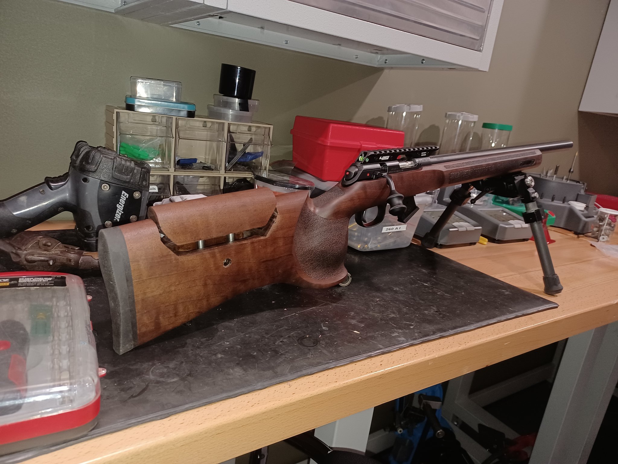

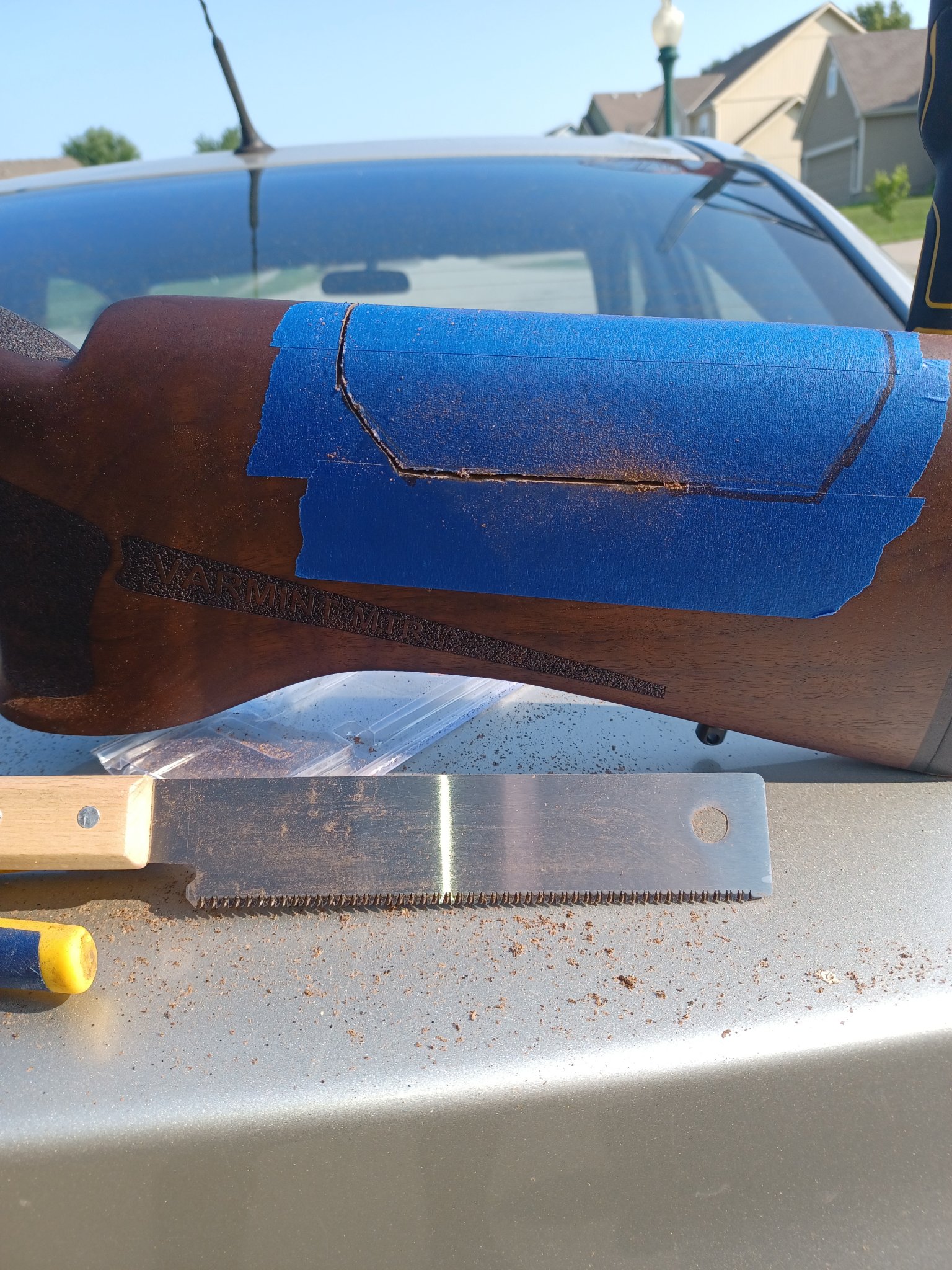

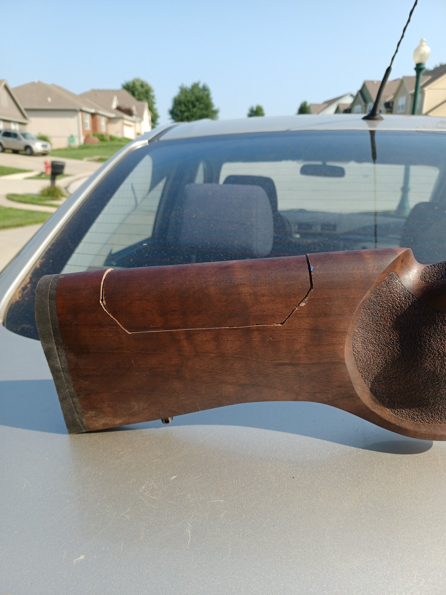

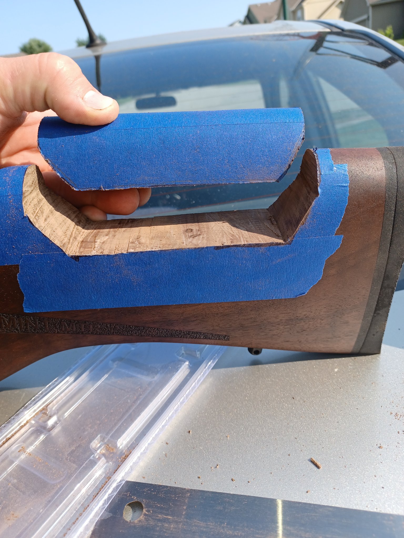

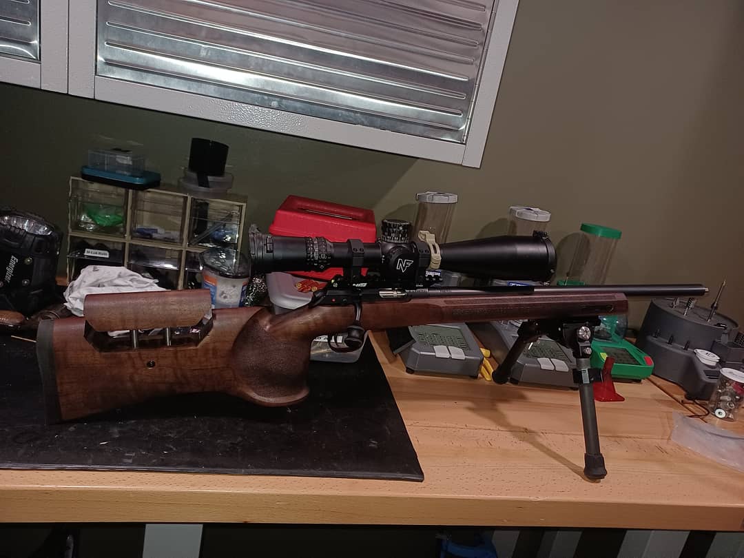

I know you said you didn't want to cut up the stock but here is one I did on my CZ 457. It was relatively easy after some thought and planning and 3 cans of liquid courage. I purchased the riser hardware on eBay for $40. The way I figured, $40 was cheaper than a new stock, and if I completely butchered it, I'd have to order a new stock anyways 🤷🏻‍♂️. I guess my point is, you can do it!!! Good luck.

That looks good...and good on you for giving it a go!
Wants to save money..... installs NF later :ROFLMAO:
Thank you!...
I had that Atacr for a future build that hadn't happened yet so I threw it on there. The CZ will wear an Arken EP5 when it's all said and done.

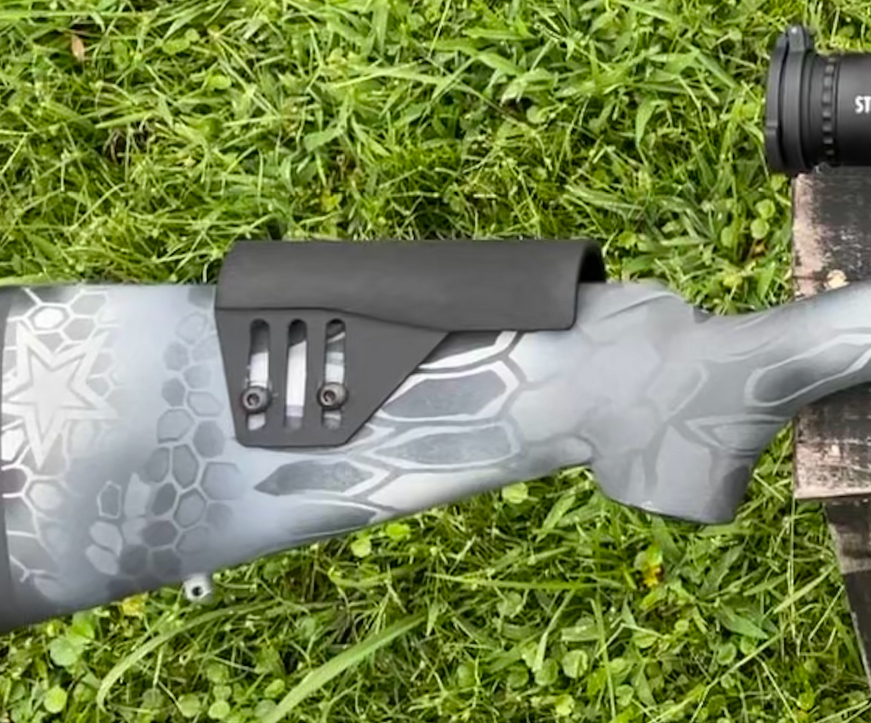

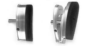

I do not recommend our cheek hardware for a field gun, Reason being it has a snap ring retention system that allows cheek piece removal and replacement without loosing your height adjustment.
Knocking around in the field will surely result in a lost cheek piece. It was designed for range use for target shooters.
View attachment 8037113View attachment 8037114View attachment 8037116View attachment 8037119View attachment 8037120

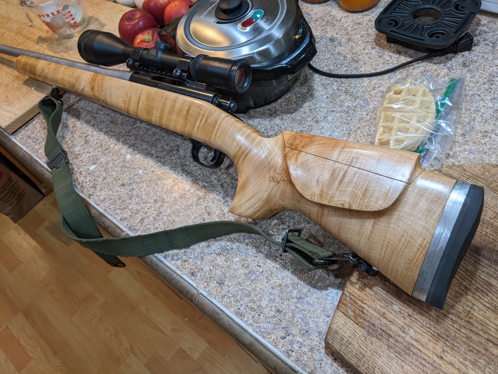

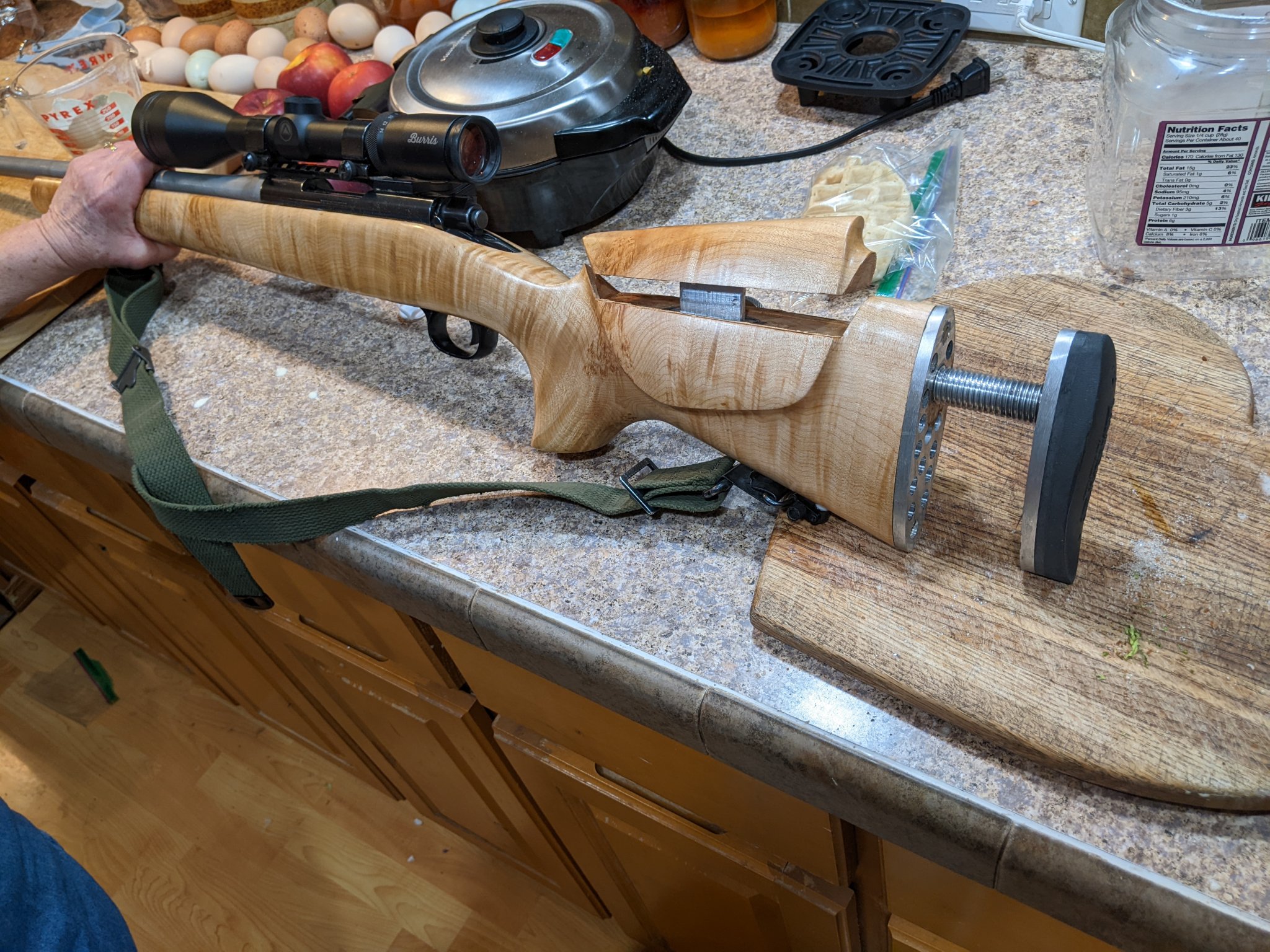

If you angle the back and front cut then by flattening the two faces that are horizontal the more you remove from those faces the lower it sits so you can eliminate the thickness of the cuts just for your own info, I think it's great that you have it a go and if what I mentioned bothers you on the next time you can try . here is the stock I just finished as the weather was poor so I got bored and I have a lot of this maple from a tree I killed
