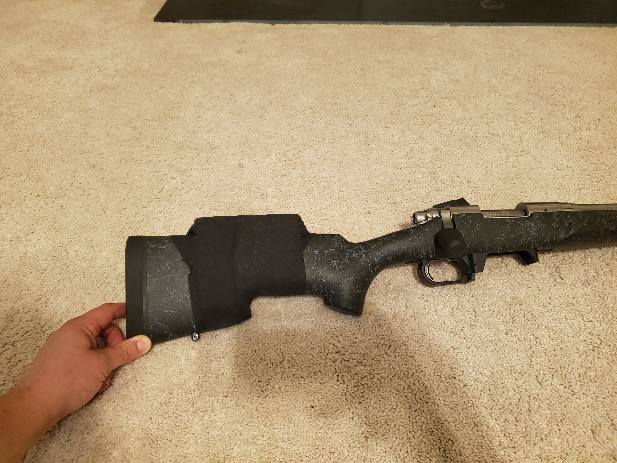

I struggled with a cheek rest on one of my rifles because I needed a considerable amount of height added and in the quest to find what worked I tried several stock packs and check rests. What I ended up with was quite comical as it was stuff I had laying around the whole time. I took some paper towel rolls and folded them up and then taped them together to build the height I needed, then I took some hockey tape (the fabric kind used for taping up sticks) and then wrapped the stock like a hockey stick with the riser in place. This was not only perfect because I could just cut it off if I needed to (I need to do this to run a cleaning rod) but it was infinitely adjustable in firmness and height. Really works well for me. Its not the best looking but honestly its not as bad as I would have thought it would be. Ill pull the rifle out of the safe tomorrow some time and take a picture if you like.

Yeah now I’m at least curious. I’ve considered doing something like that before but never really tried. My thinking was that some of the bags and adjustable kits are fairly cheap and maybe worth a shot
Here you go. Currently in the process of putting a new optic on this one (had a direct mount before that was for a 30mm tube) so it looks a little funny with no scope base and scope but you get the idea.

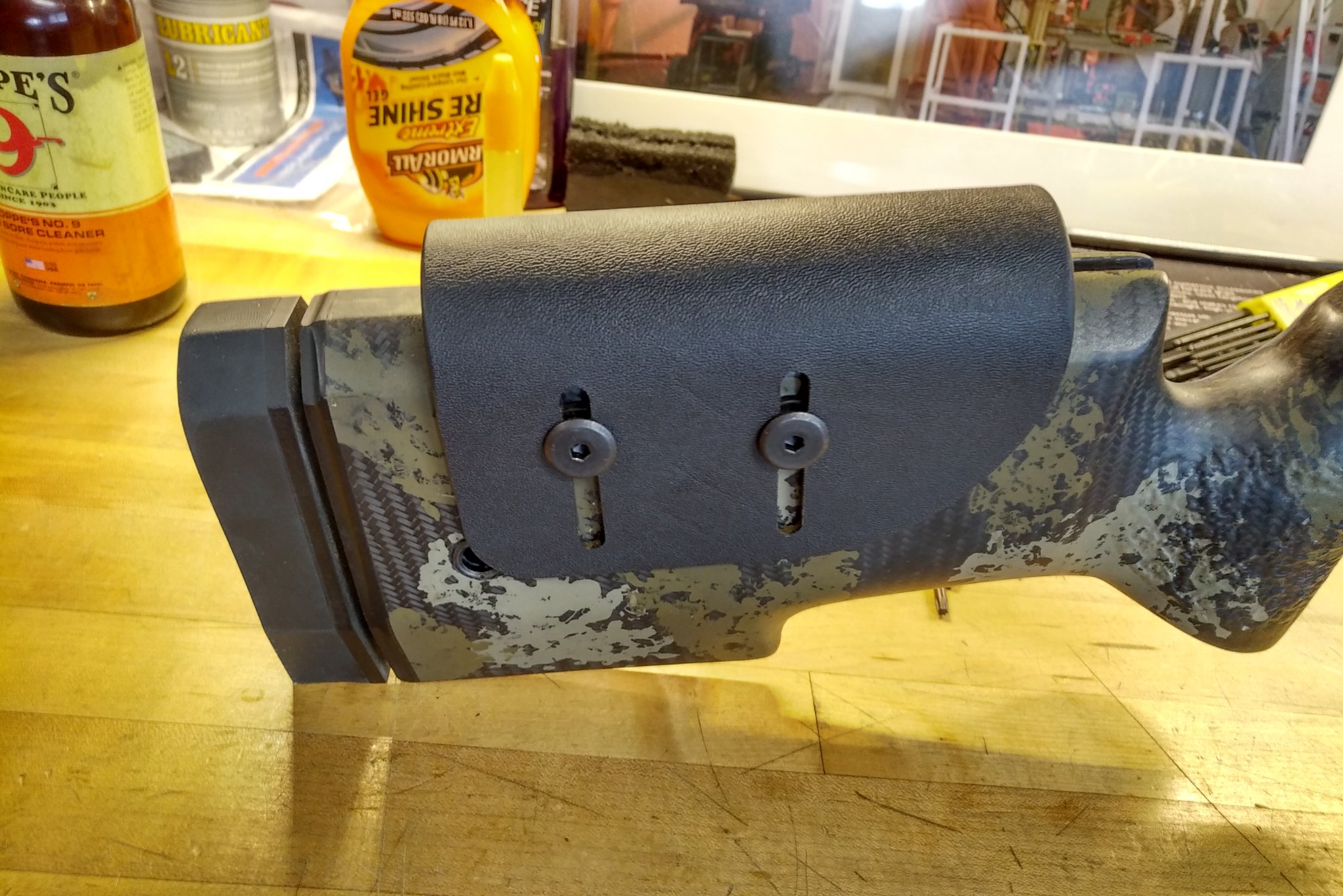

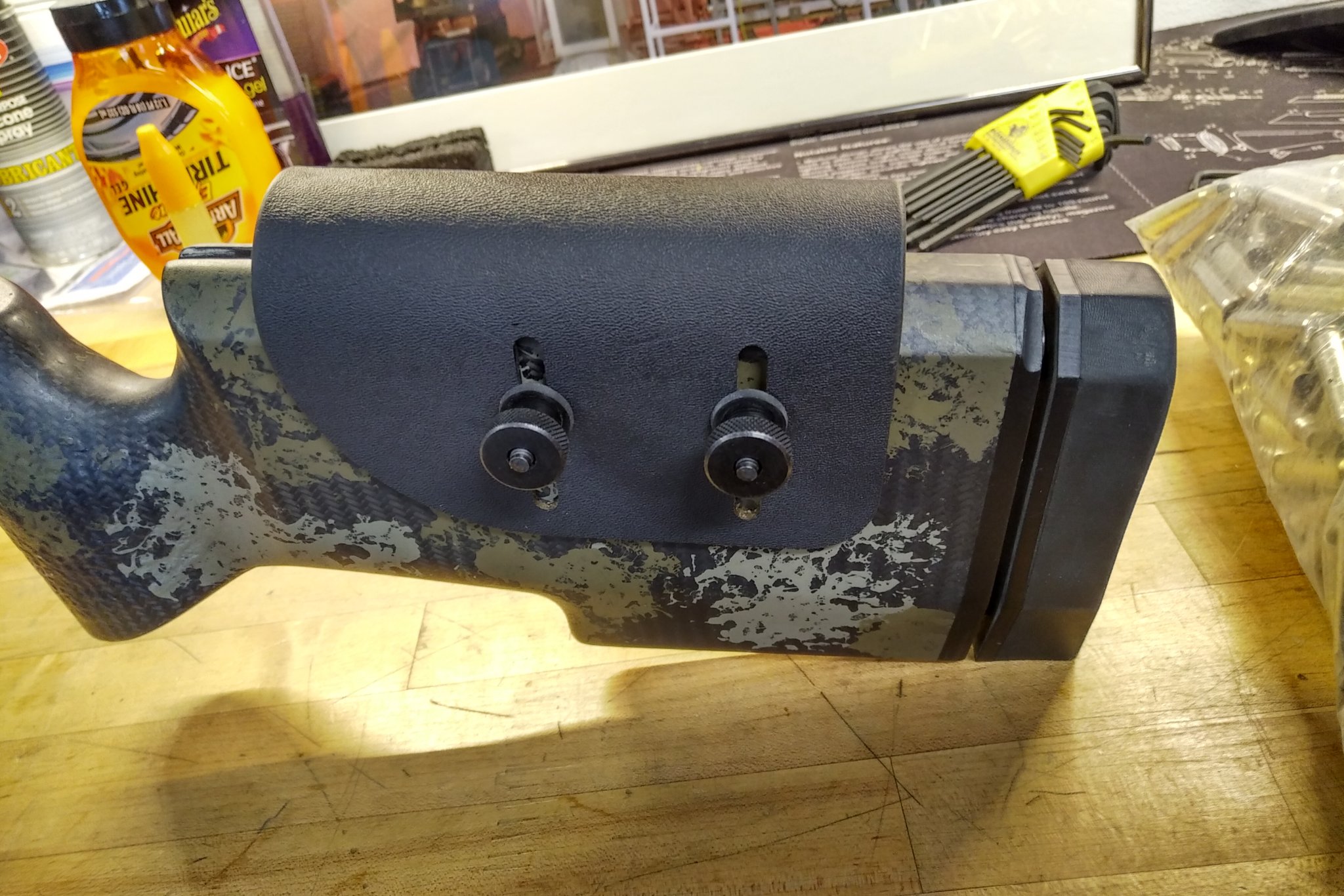

Or, you can be like me and do search for a kydex cheek riser on Ebay or similar, grab hold of your manhood, and drill a couple 1/4" holes in your Manners T4 MCS :)
I need to get some neoprene to put on top of that.
70 rounds of 7mm RemMag in one day left my cheek looking half chipmunk. ????

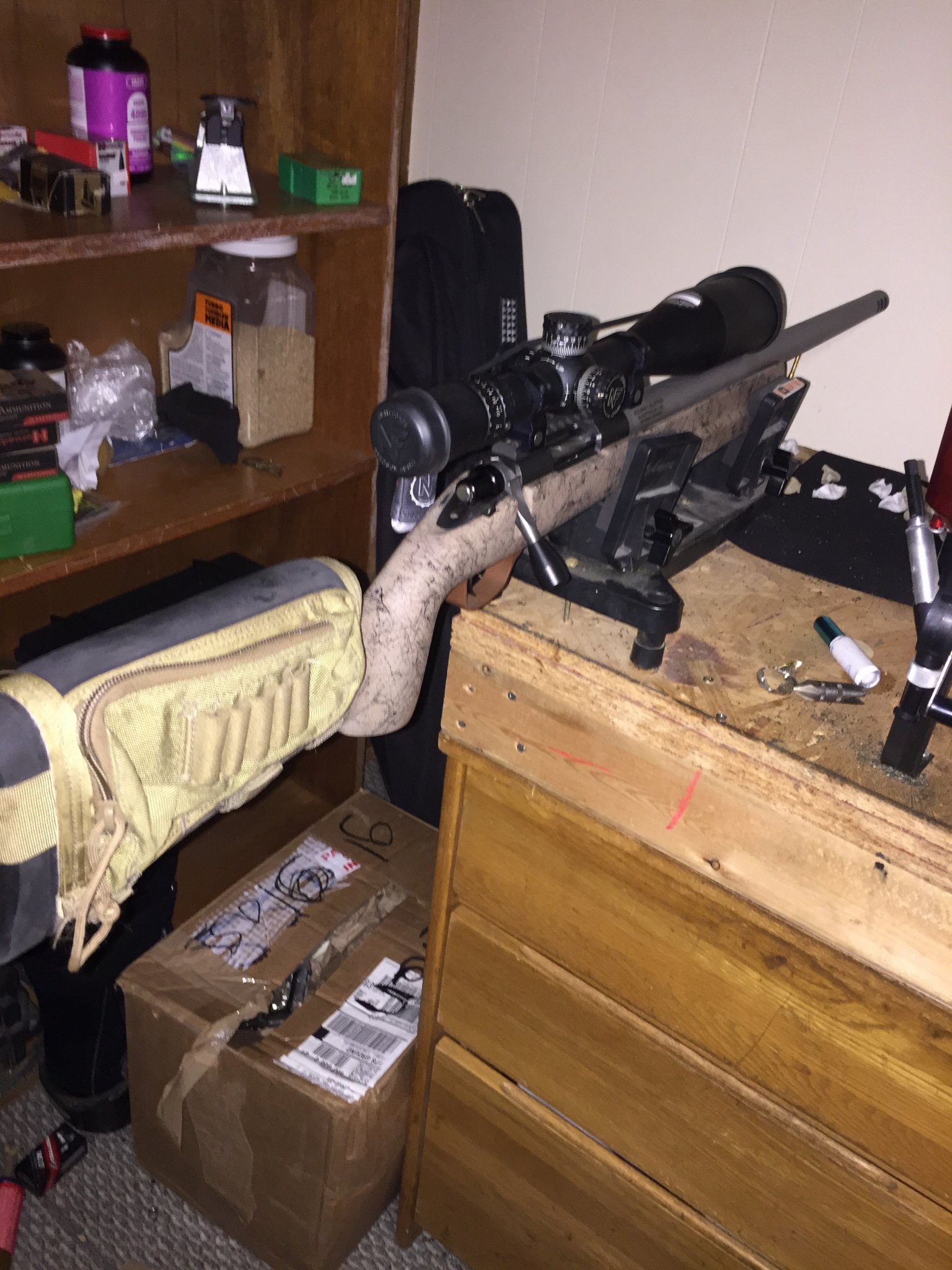

I like a stock pack, hard to beat a Triad. To me it's very comfortable, soft, warm in the winter and good grip / texture
I've had the kydex DIY risers and a Triad. The Triad wins hands down for overall comfort and can be adjusted just as well in my opinion, even if it takes a few more minutes to get right.
The pack comes in handy for dope cards, small oil bottle, whatever.
