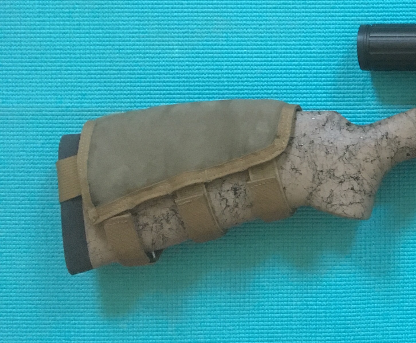

Looking to add a cheek saddle to a McMillan A3, is there a typical way this is done? Just order the kit from McMillan? Or are there other solid options out there? I have seen the ones that strap on with Velcro, but they are nearly the same price as the aluminum kit from McMillan.

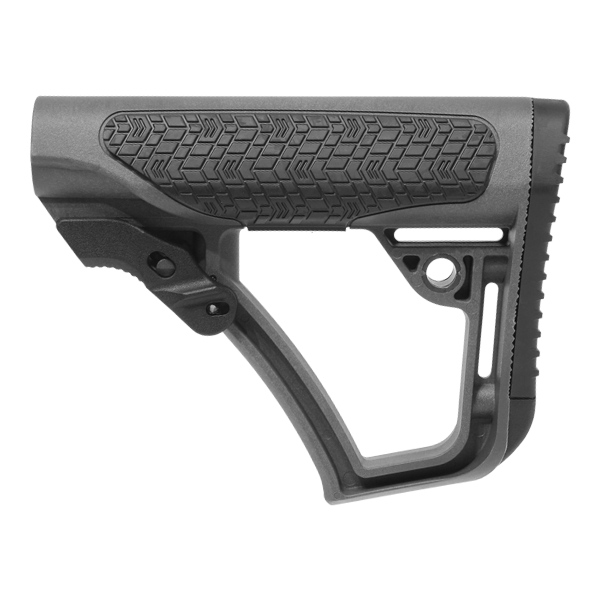

Also, what about proper cheek weld with a beard? The fiberglass feels awful slick. I haven't shot in quite some time, and just dry firing the other day I noticed a sliding on the stock. Obviously the beard was not an issue while in the Corps, lol. I've seen AR stocks with raised stocks and a sort of rubber pad, is there anything like that as an aftermarket solution? My brief Google search while at work hasn't yielded anything decent. Thanks in advance for any guidance. PFA regarding the pad.

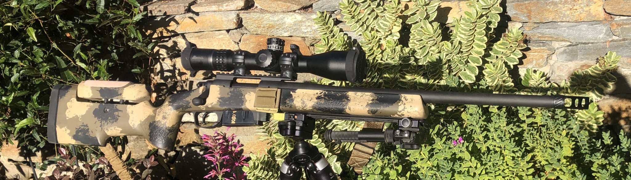

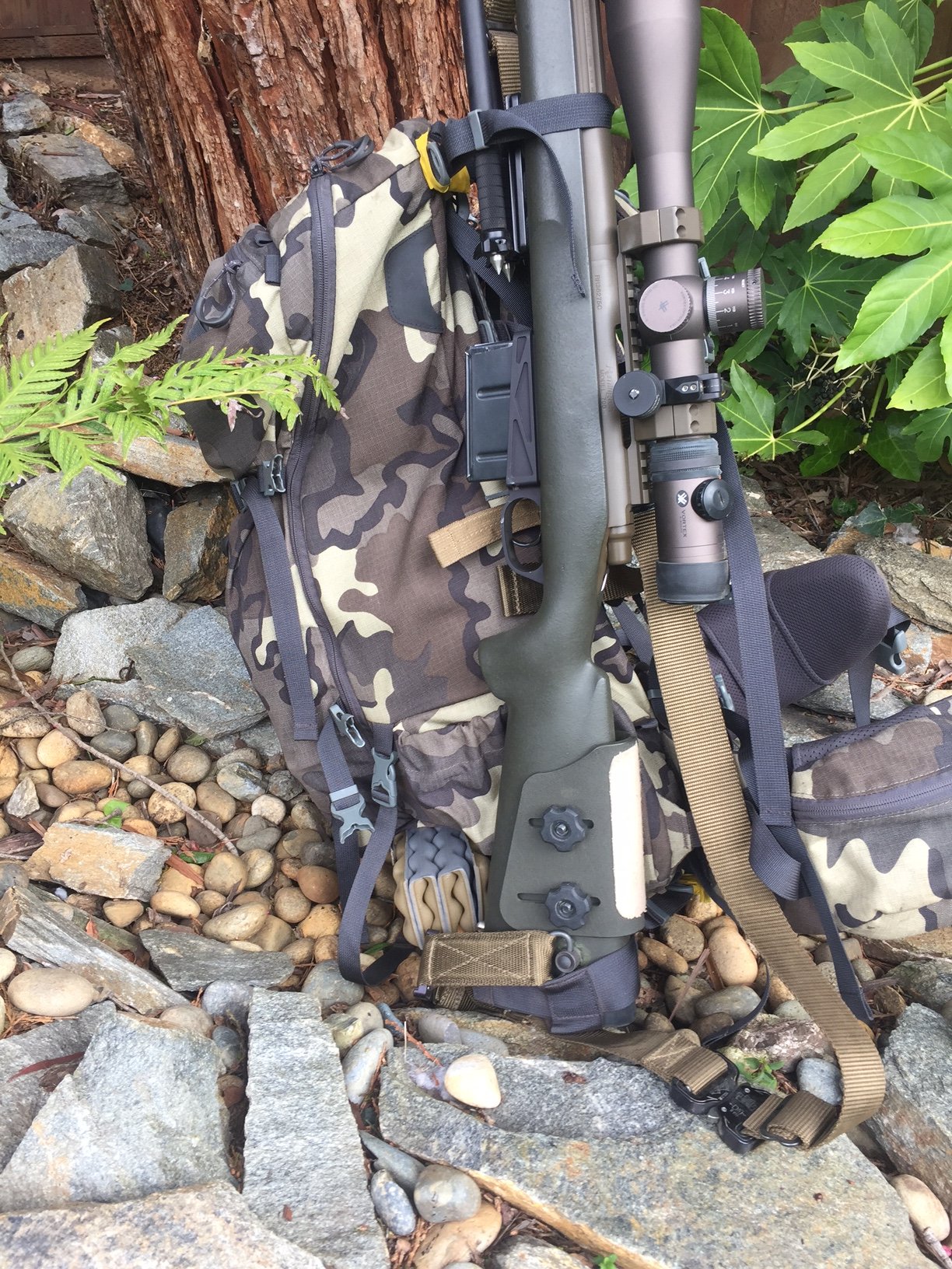

You could also send it to Stocdoc for an adjustable cheek with KMW hardware, the biggest issue with add on styles is it actually increases the width and works to move your cheek weld away from the centerline of the rifle.
The KMW hardware allows both vertical and horizontal adjustability for a more refined fit.

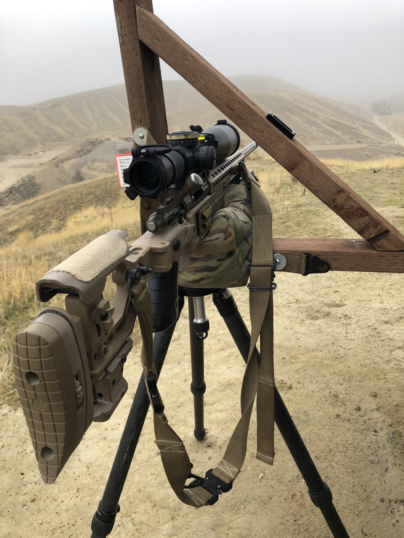

i have always used adhesive backed craft foam (you can get it from and craft/ hobby store)......just peel, stick, and cut.......its not slippery but also not aggressive......and you can layer it if you need to add a little height.

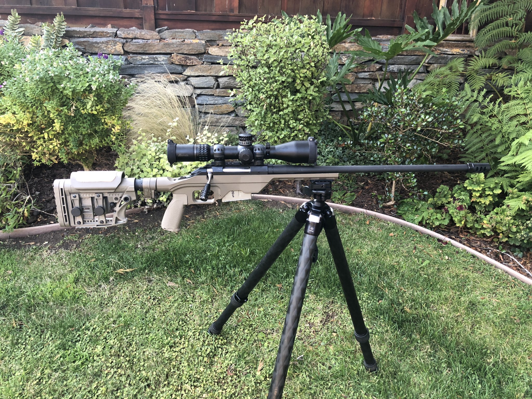

The stuff above is almost the same - but very cool in the sun -- not cold in the winter, never slippery -- and lasts a very long time.
God'-A-Grip has prefit and sheets of sorbane[sp?] with adhesive in thickeness from 1/8 in. to 3/8 inch. Gave just the right height and comfort on my Magpull stock. Not very exspensive about $20.00 for prefit and sheets for less. godagrip.com
