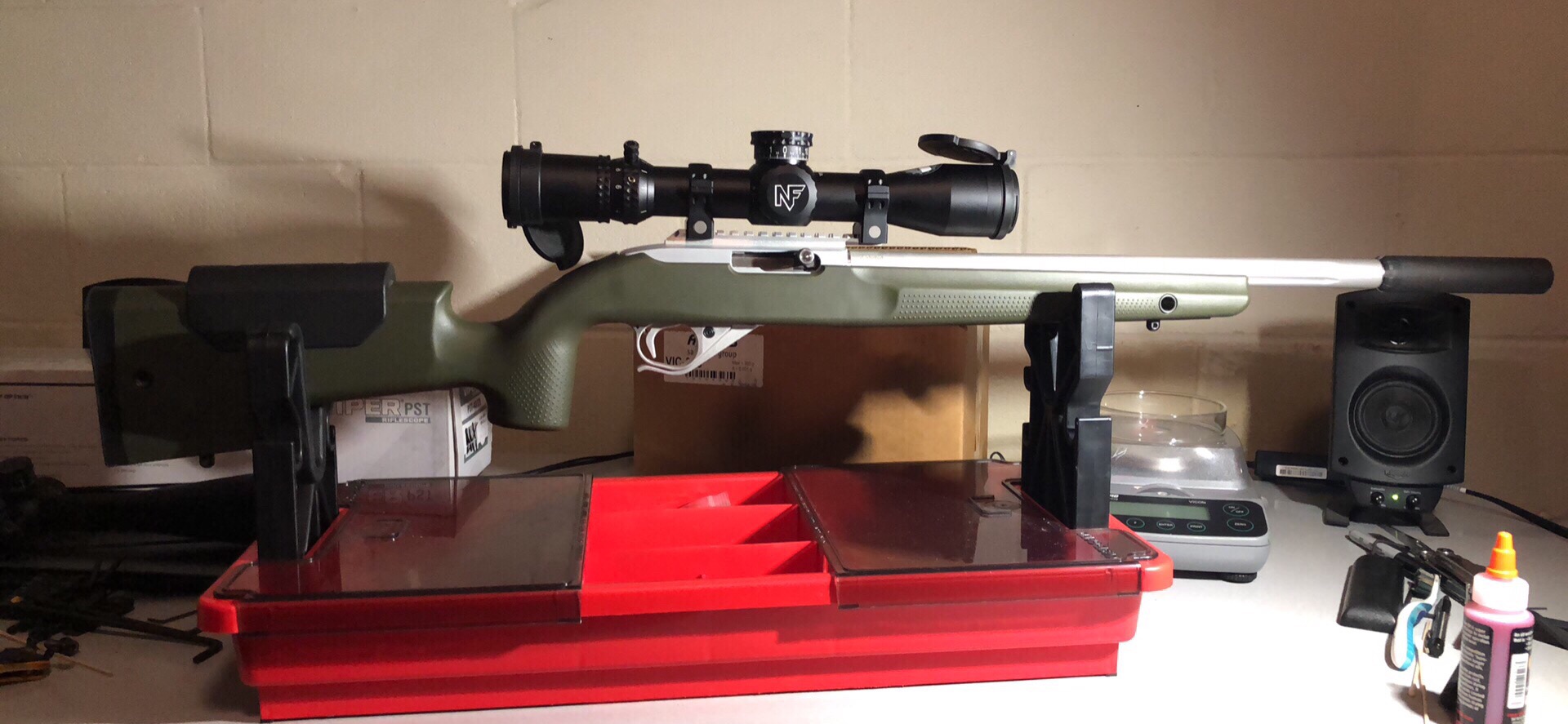

However, My current .22 match gun is a full KIDD supergrade in a PMACA chassis. If I had the chance to go back in time I would have ordered a full KIDD supergrade with the Magpul X-22 stock from KIDD as they do NOT sell the modified X-22 stock as a stand alone item (I tried, begged, pleaded, but they only sell the modified X22 on complete rifles), I ordered a barreled supergrade action. But that is $1100 path vs the CZ upgrade path at $450 rifle + $350 barrel + gunsmithing. Wait for the Tikka.
Tiger,
I'm waiting on my barreled KIDD Supergrade to drop into a PMACA chassis. Why do you wish you got the X-22? I'm sharing this rifle with my wife so I needed the quick adjustability of a collapsible stock with a cheek riser - hence the PMACA
Getting the Magpul stock with the rear tang inletting from KIDD is a one time option when you order a rifle. I like the magpul x22. Like I said earlier, I am using a PMACA chassis for matches, I do like that set-up. I am assuming you got the long nose PMACA since it has a rear tang inlet?
Correct. That's the primary reason I went with the PMACA. Lightweight, had the adjustability, and readily accepted the Supergrade without inletting. So far, it looks good. Excited to put it all together and check it out
Kidd supergrade PMACA currently with SS 18" barrel
CZ455 with worked stock
Kidd standard with std magpul stock
All wear SWFA 3-15 milquad reticle scopes on 0 MOA bases
