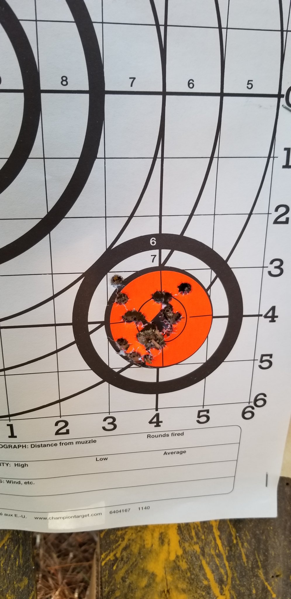

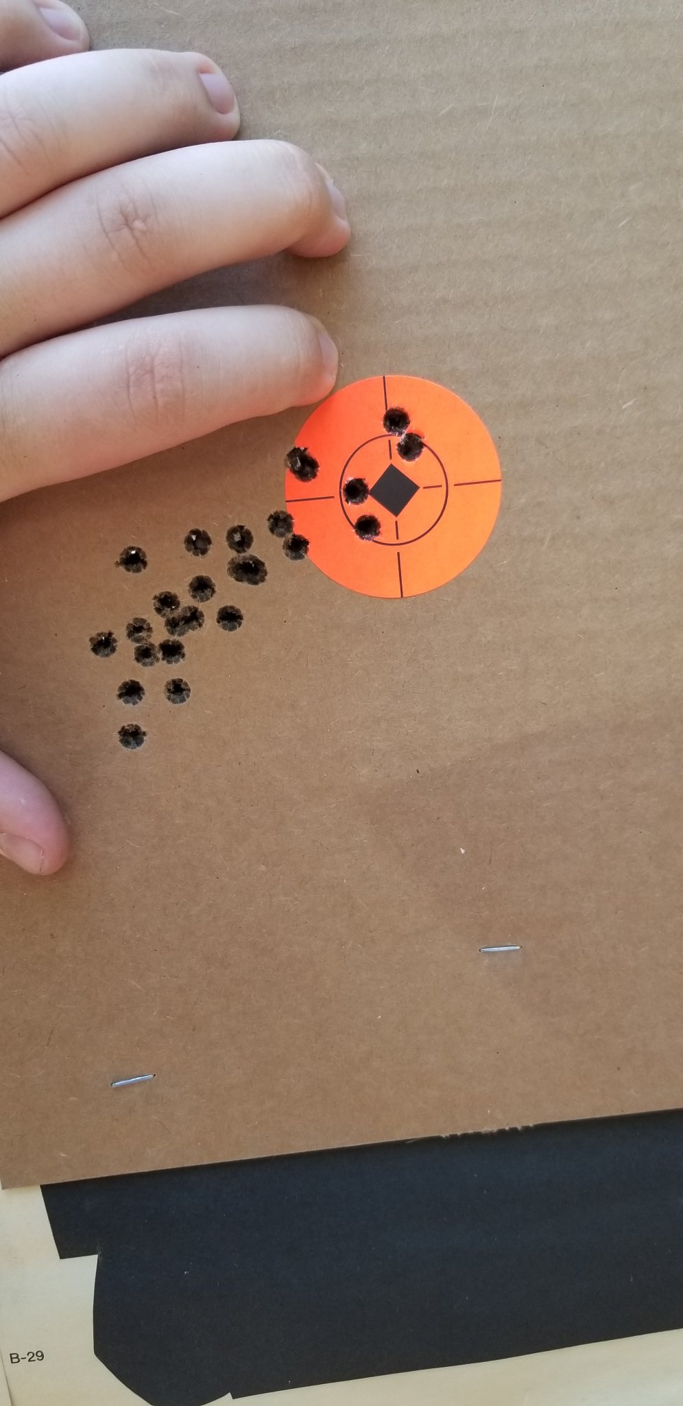

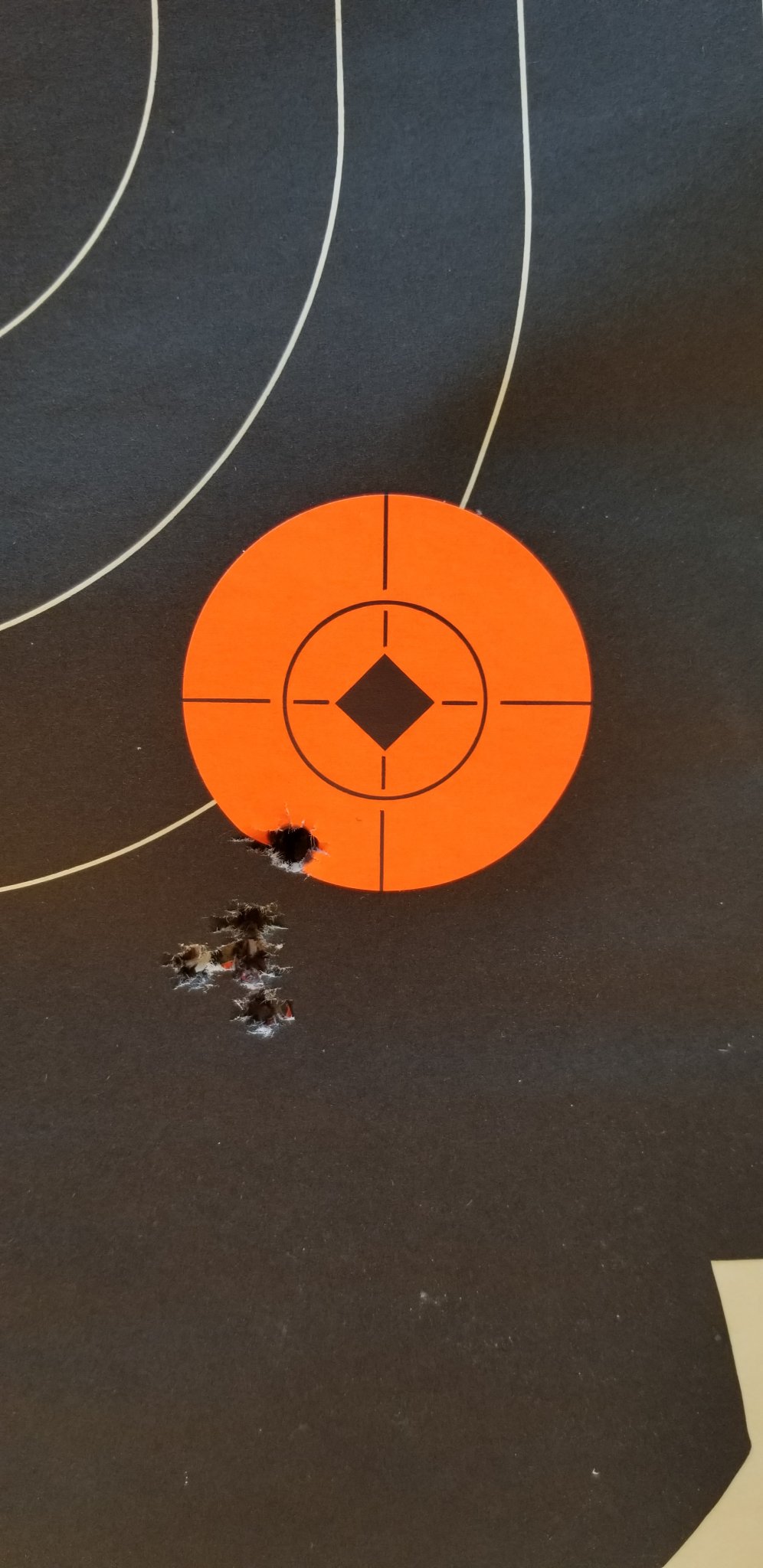

ISSUE 1: CONSISTENCY
I would get 2 or 3 rounds tight then flyers, and at first I was thinking it was just me. So after last time I double checked the torque on EVERYTHING on the rifle. I began to notice as it got warmer, the groups shifted big time (an inch or more), and we are talking just a few shots. I tried taking a few moments between shots and that didn't help either. So I decided to put 25 rounds through the rifle ( had 2x 10 round and 3x 5 round mags with me) and fire a steady pace to see what the group looked like.
This was fired from a caldwell "tac driver" front bag and a rear bag.
First 3 shots were tight on the right, the next few were around the middle, then the rest began walking down and left as it got hotter. I experienced the same issue with a Atlas bipod and sandbag as well. I did the same test with my Tikka in the next photo.
This is 25+ rounds, fired in relatively quick succession. I did not take my time near as much as I did with the MPR and got much better results. I did pull a few slightly.
I understand a hot barrel will open up, but this is not "opening up" its walking low and left the hotter it gets. Anyone got any ideas wtf is wrong with it?

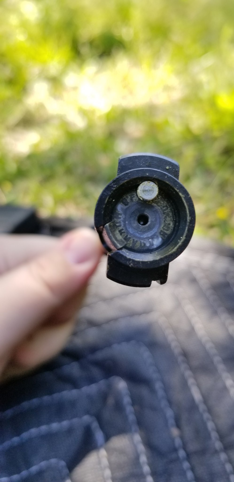

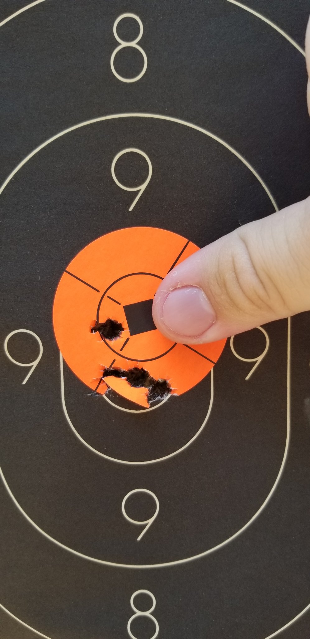

PROBLEM 2: Ammo pressures -
I've seen pressure signs on several loads, many of the "match" loadings are showing some primer distortion, but nothing too serious. Till I tried this:
I cleaned up the bolt and checked the rifle, everything appeared fine. I only fired 2 rounds of this ammo and both did this, and I experienced a sticky bolt as well. The other 18 rounds fired flawlessly through my Tikka with no pressure signs. I was under the impression most ammo was made for longer barreled 6.5 CM. I do not understand why 6 inches would show that much of a difference. All other rounds of other ammo types were fine.

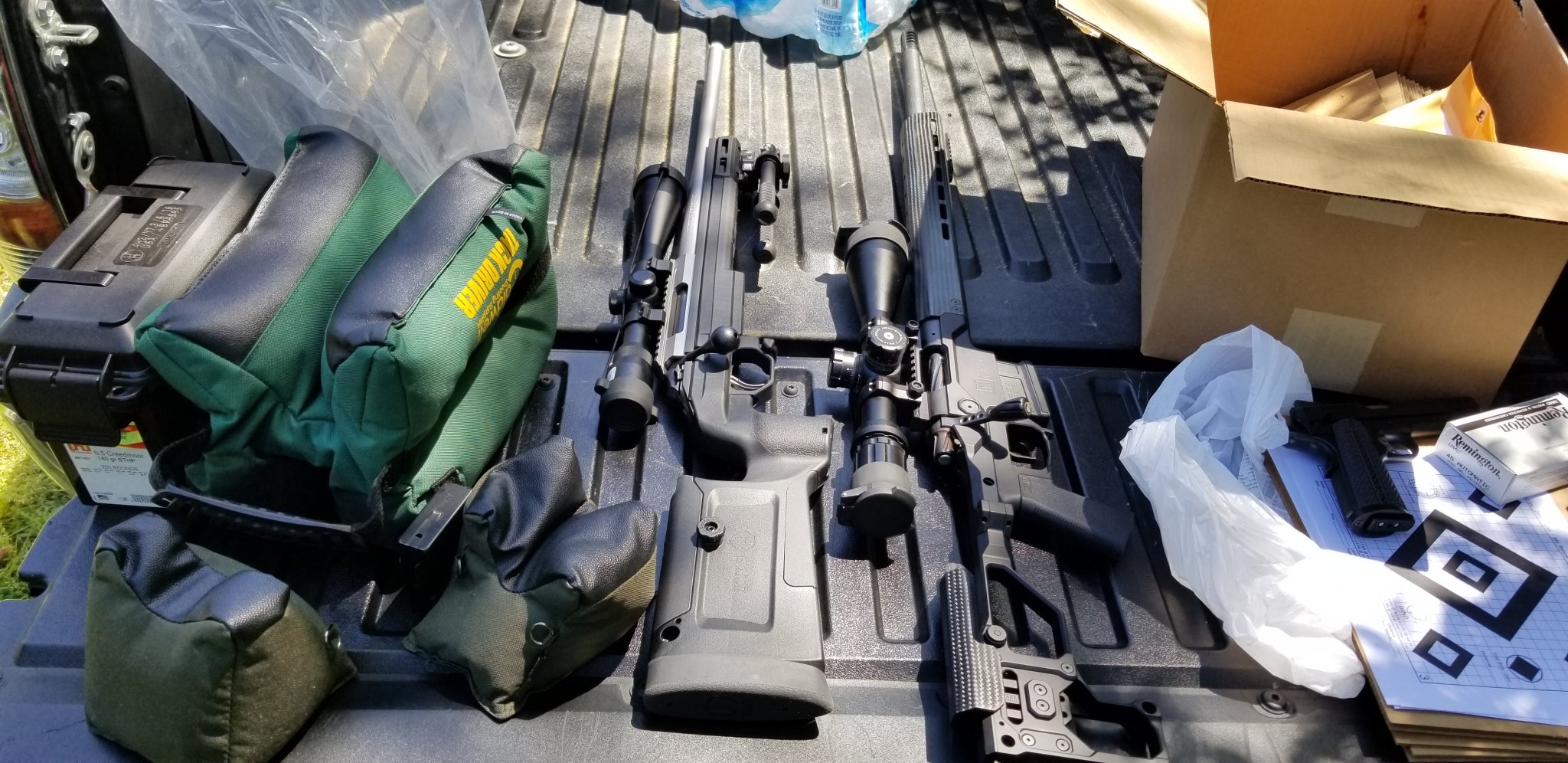

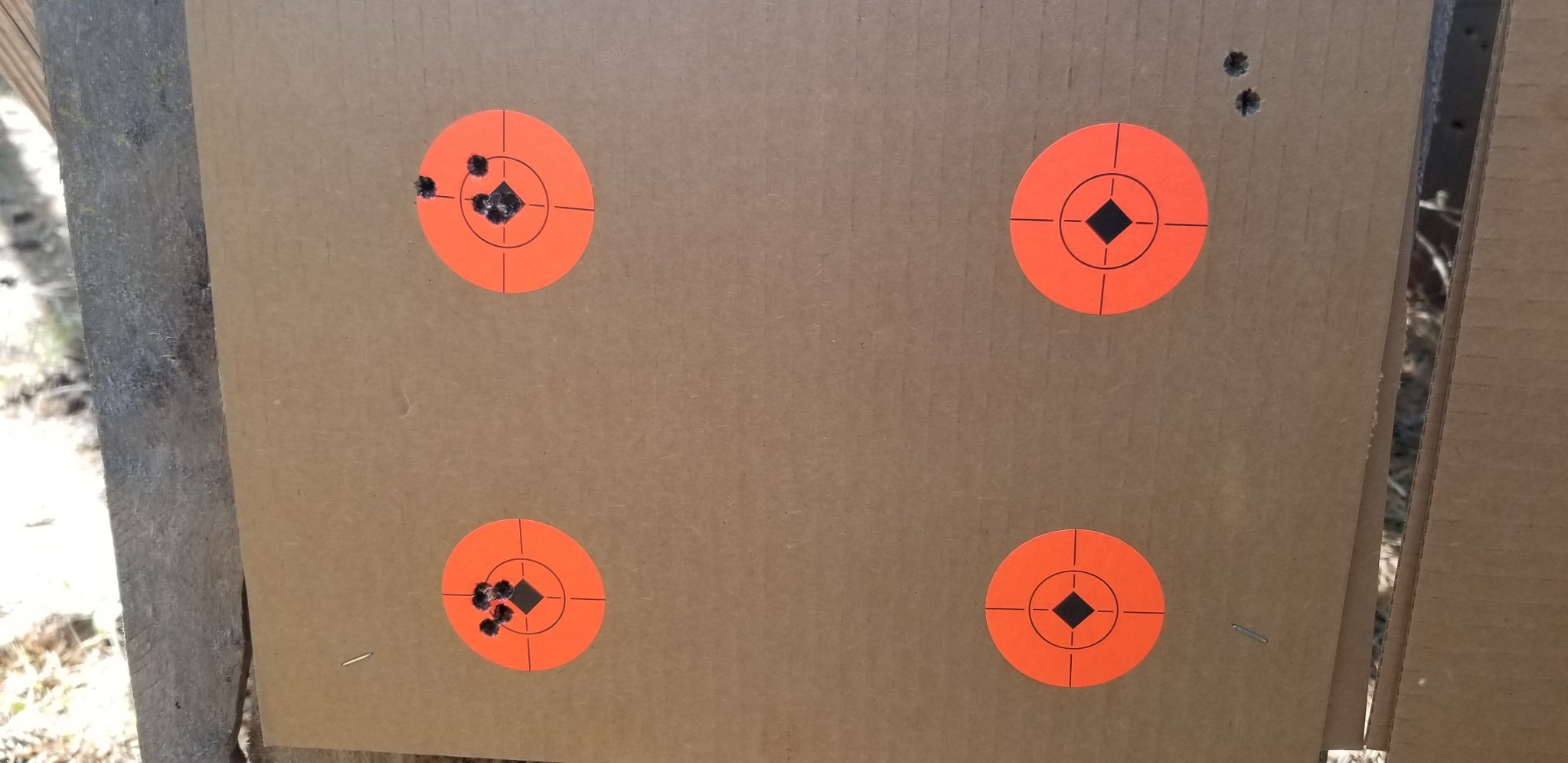

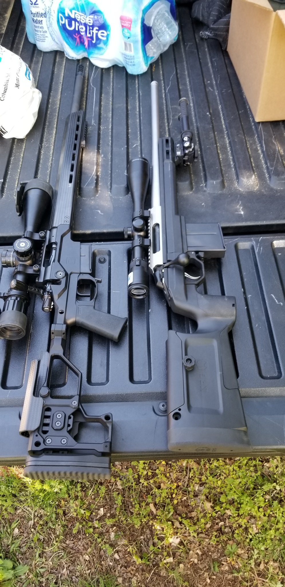

+= MPR VS CTR =+
The AMMO:
THE TEST:
2x 5 shot groups per rifle of each ammo type
10 rounds fired consecutively, with a short pause between strings of 5.
Rifles allowed 15 min to cool between each 10 shot string. Barrels cool to the touch.
Both optics run at 14x magnification
Same rest & rear bag used for both rifles.
Target dots are 2 inch dots
The only variable besides the rifles was my growing irritation.
I did fire 10 rounds of american gunner thru both rifles for the same of verifying zero and fouling prior to testing.

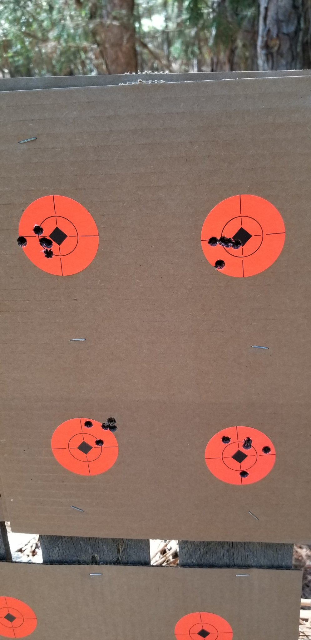

TEST 1: 147gr ELD Match #81501
Left two targets are CTR, right two are MPR (f*cking first shot is almost always a flyer, neither rifle loved it)

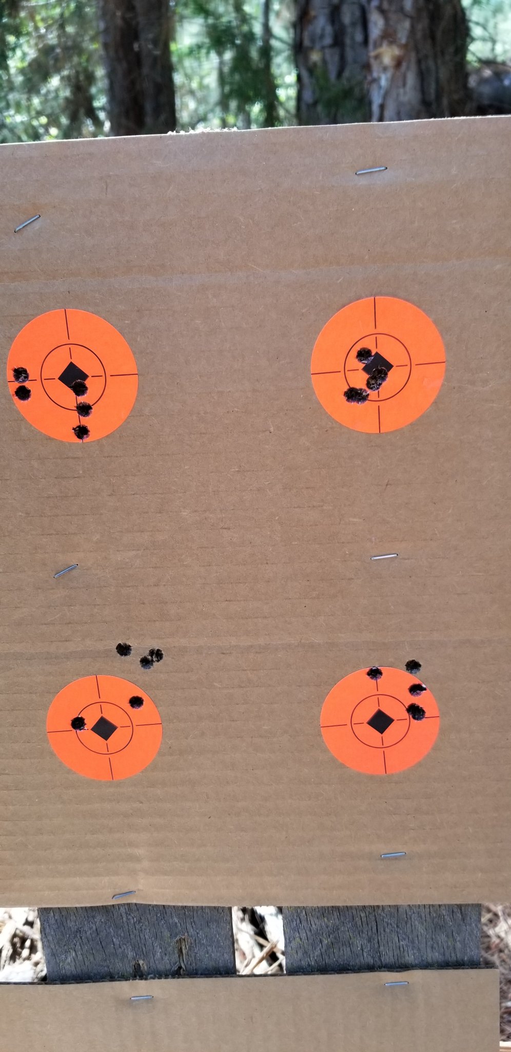

TEST 2: Hornady 143gr ELD-X Precision Hunter #81499
Top two CTR (I f*cked that left target), bottom two were MPR
TEST 3: Hornady 140gr ELD Match #81500
Left 2 are CTR, right two are f*cking blank because it was too hot for the MPR. Those are the two shots I fired that blew primers*
TEST 4: Barnes 140gr Precision Match OTM BT
Top CTR, bottom MPR (Listen, I got excited because that left target 3 shot clover was my first 3 shots and I thought I finally found "the load." F*ck no)
TEST 5: Federal Premium 140gr Nosler Accubond (this shit kicks much harder than anything else I shot today)
CTR Top(began to get annoyed pulled a bit), MPR Bottom (Got excited again on the right, but I'm thinking it was more miracle than accuracy)
CONCLUSION: *SURPRISE* Tikkas can shoot. My MPR does not. It is "OK" at best, and I do not feel that it is close to being worth the $2500 MSRP based on accuracy. Everything else on it is GREAT, it just does not perform on a level that matches it's price tag. And i've yet to see a solid 5 shot MOA or better group. So, looking for opinions... Talk to christensen? just re-barrel it, the action and all is great...? Sell it and buy something else (Seekins Havak was my second choice)
Also need a brake for the Tikka... 200 rounds in a day even with 6.5 you feel it a bit.

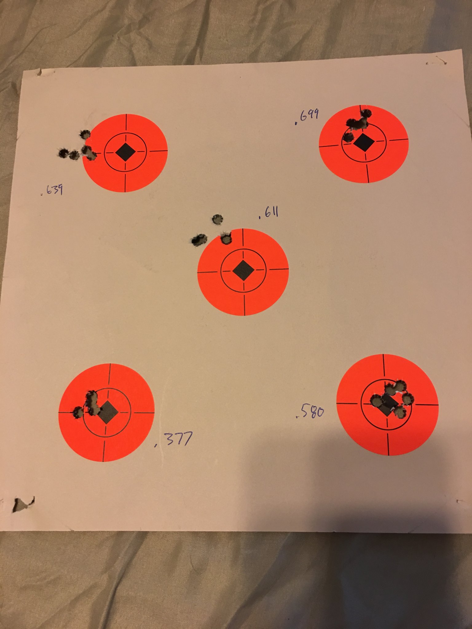

Thanks for the review. My MPR shot unimpressive groups with factory ammo as well, but not quite as bad as those.
I should note that the 22" creedmoors seem to be shooting well while I've seen nothing special from the 26" barrel models.
My guess on the poi shift is a delam between barrel and composite material. Probably was never bonded well. A difference in thermal expansion would exacerbate this.
Here is my first day of load development where I just took some random loads to see if it would shoot with handloads. That is 2 different bullets various brass and powder charges of H4350. Time between groups was about 5 mins but weather was cooler. Subsequent load development has led to consistent groups in the .5s with a 140 VLD and H4350. I'm trying Hornady 143 ELDx and RL16 now since I'm trying to get higher velocities and Bergers are impossible to find.
My guess is you may have gotten a bad barrel and should call Christensen.

Just to comment on the American Gunner, I've surprisingly good results with it on both my CTR and my TAC A1.
Here is a target when I was checking to see the change in POI when using my Hybrid for the first time on my TAC A1 (have a TBAC Ultra 9 still in jail). Top left group was unsuppressed. 3 shot groups at 100 yards. The X marks POA on each group.

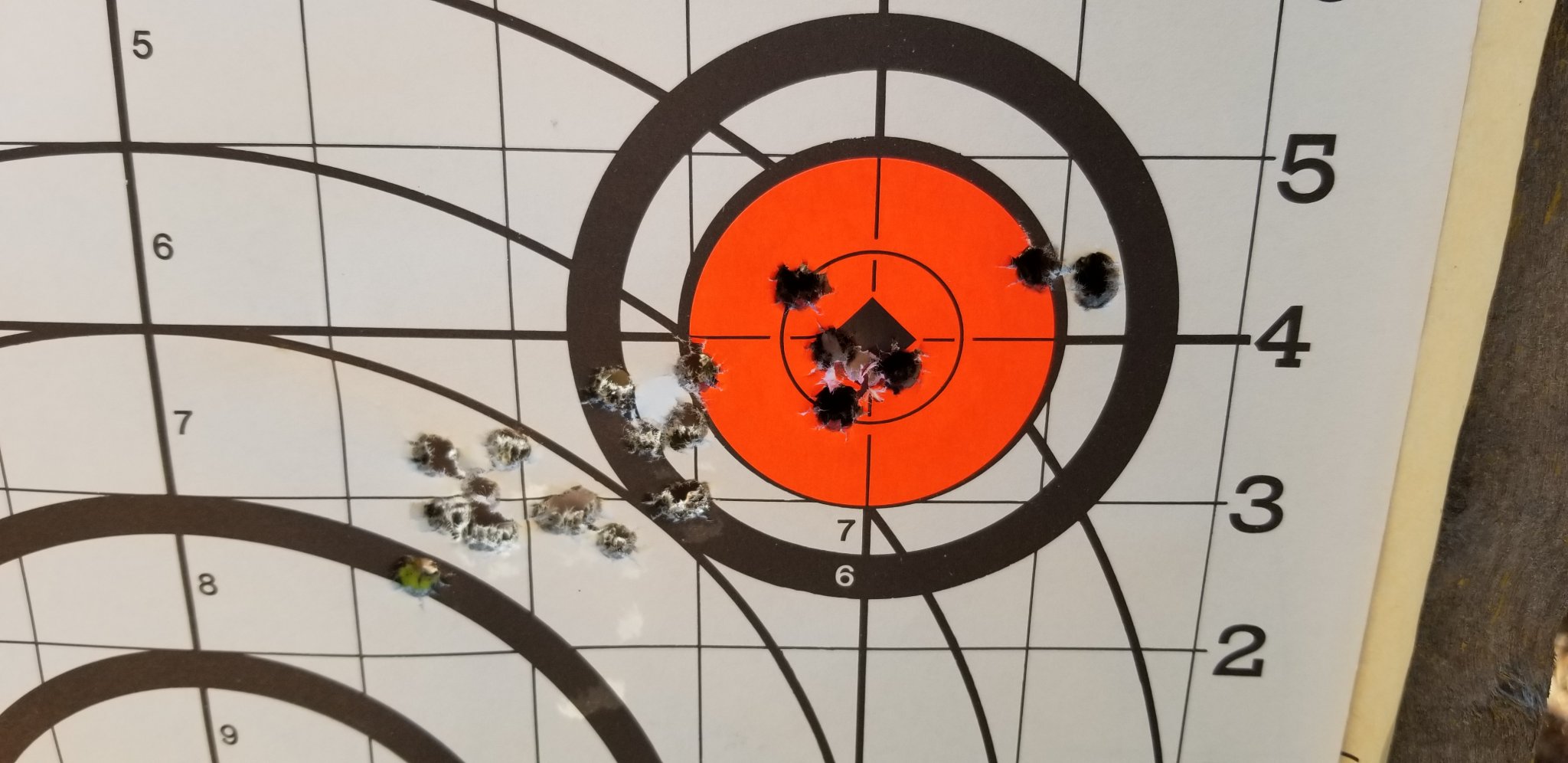

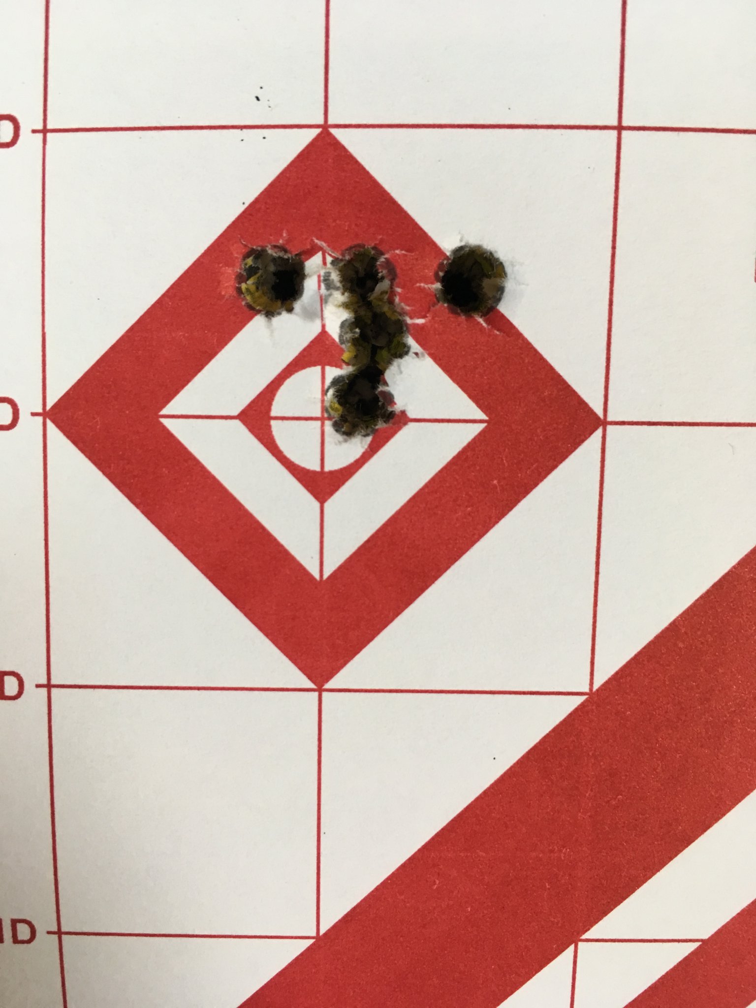

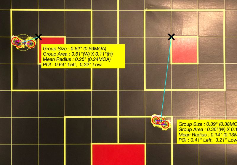

Well... here's my update:
I double checked all torque specs, and I swapped scopes to my Viper PST. I fired 10 rounds to get it warm and foul the barrel. I brought another shooter and my wife with me today. My first 5 shot group with 130gr Federal Gold Medal Berger:

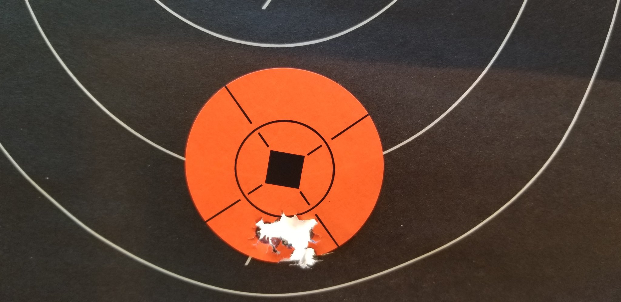

I fired a second group [pulled one]:
At this point I noticed it began "opening up" again:
This was fired from a weighted leadsled, taking 30 seconds or so between shots for all 3 groups and 10 minutes between 5 shot groups. Needless to say I started to get annoyed. I handed it over to my partner and my wife to shoot. My partner is a better rifleman than I and his groups were as bad as mine. We decided to fire my second box of 130gr FGM out of it in one sitting. I fired 10 and he fired 10 back to back, 15-30 seconds between rounds we were both very slow and careful:
Oh look, its stringing along low and left again. Same shit with myself and my partner. This is from a lead sled too. It was rock steady, no sway, patient trigger press and yes the new grip helps tremendously with getting a good trigger press but it didn't fix the walking barrel. If you drew a line down it it'd be a solid grouping off that line so I'm confident it's not us. Emails will be going out tonight to Christensen and Eurooptic.
