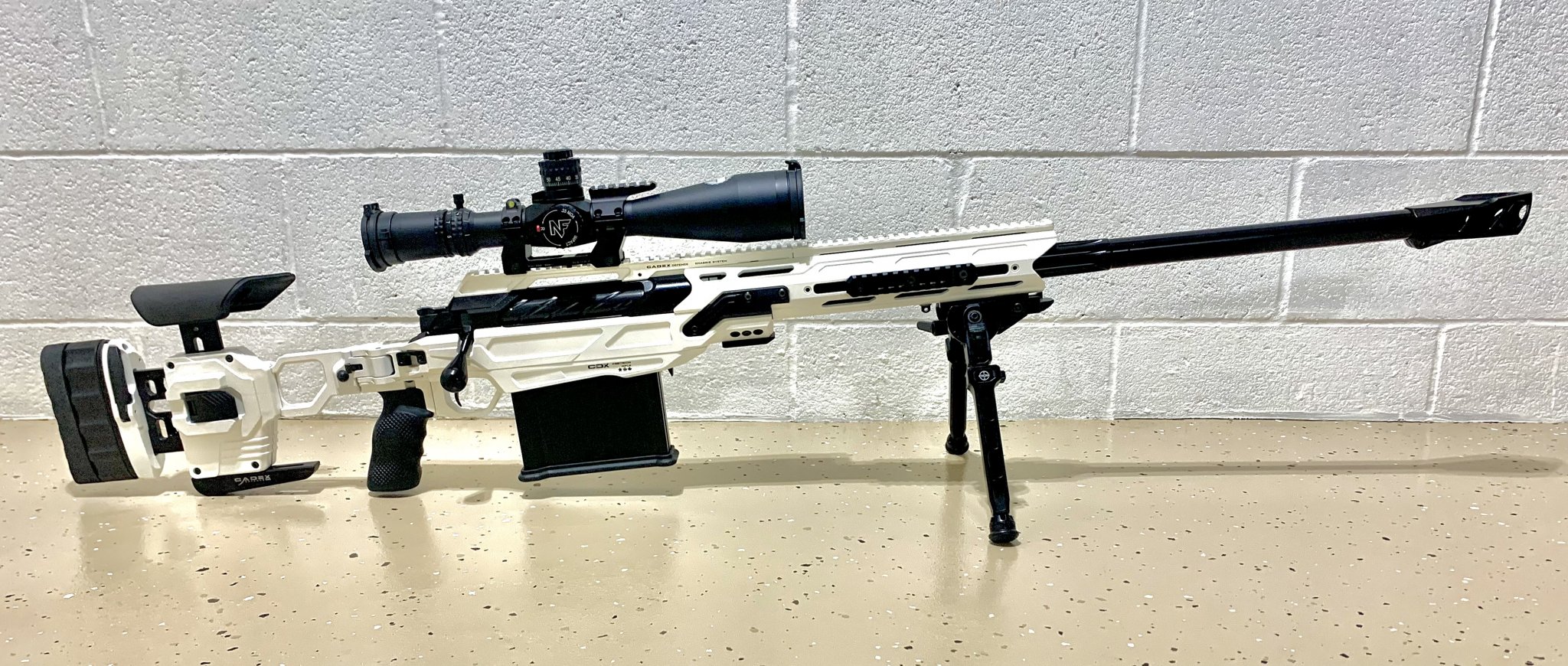

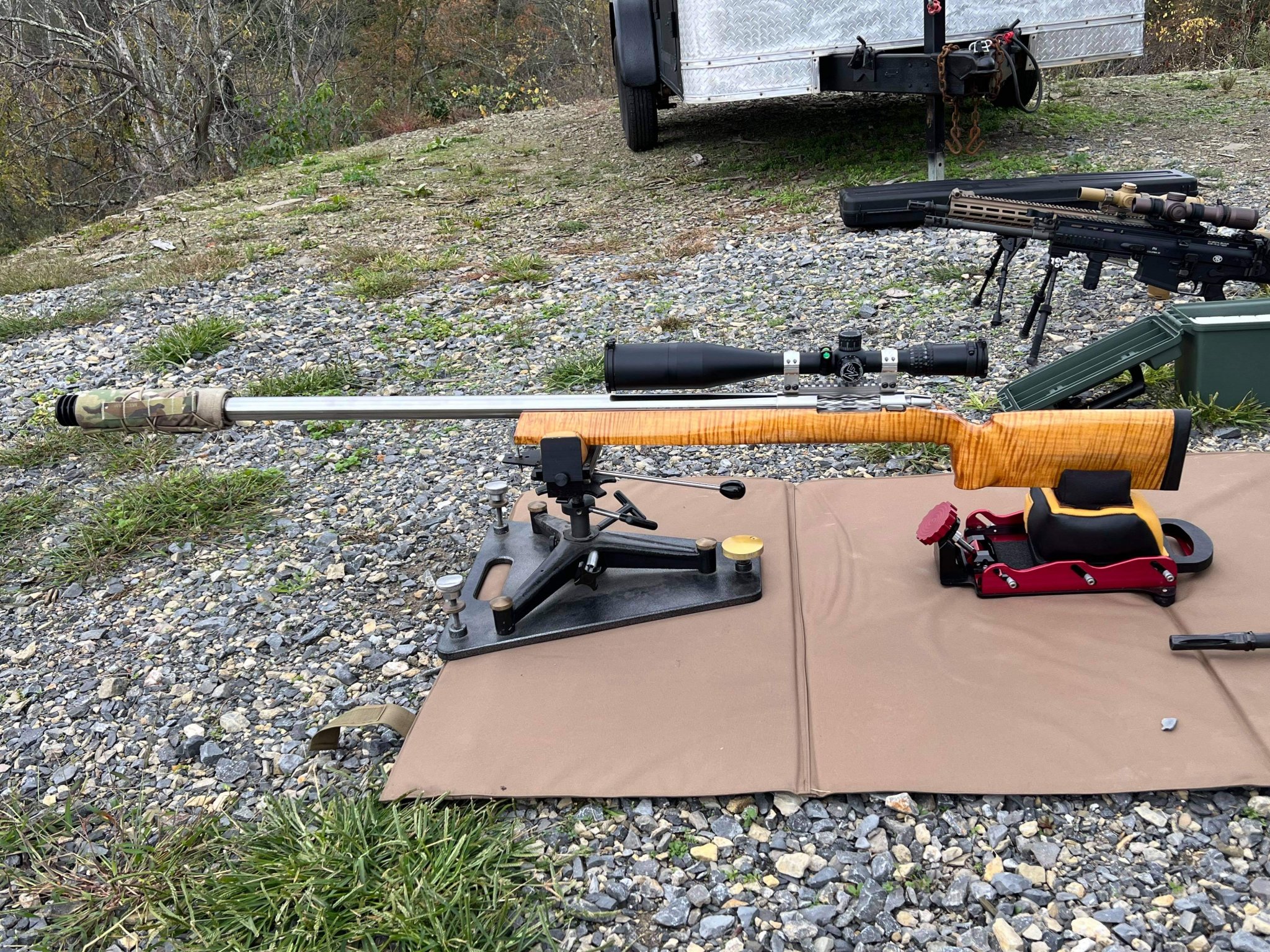

I have a 34” 300 rum and a whole butt ton of slow powders at my disposal, should be cake 😉

Bat action w a nice curly maple stock? Can you hit 3200 FPS w 250 A-Tips?
Nice Cadex Tremor in the background ;)
It’s currently running berger 230’s at 3,200 with a moderate load of retumbo. I don’t think getting 250’s to 3,200 would be very hard using a slower powder and a warmer charge, only downfall in my case would be less than ideal stability in my 10 twist.
Yeah thats right, Bat model M, joel russo curly maple mcmillan MBR clone, 34” 1.350” straight benchmark.
And thanks, that pic was from a while ago, she is all done now :)
